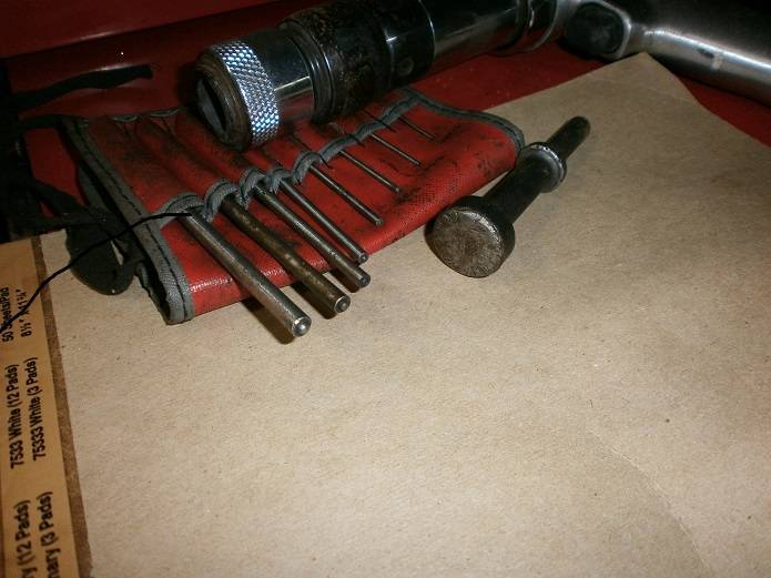

This is the absolute best pro trick I have for this... and cheap versions of all of these are available at many of the cheap tool stores. Roll Pin Punches have a "button at the end which is great help when starting them. Air chisel doesn't have to be strong to do this, works really well when you can't get a hammer swing. The flat hammer adaptor for the air hammer is not uncommon and makes this much easier. Mine are Snap On and expensive, but there is no need to spend that much to do this as a hobby. Wear protective goggles and leather gloves... impact tools, especially cheap ones can fail with shrapnel flying.

Love roll pin punches, they work great but I never had to use the air hammer with them.
Steering rack on a neon comes to mind... but used the trick elsewhere a hammer swing was awkward.

Snapon make a few different sizes of roll pin punches made specifically for air hammers and for steering box shafts, but like was mentioned they aren't cheap. Lots of clubs get together and buy specialty tools like this, and share the cost between members, then the members share them. Like I have on my receipts "Good tools aren't cheap...cheap tools aren't good"
