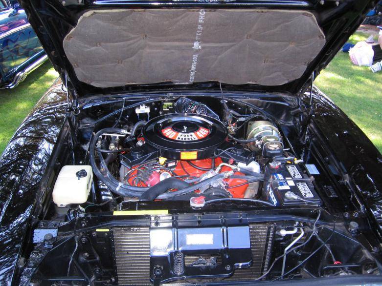

Did they ever have pre-heater shrouds on the HP manifolds like the logs? Or were those log-only?
Yes, they did. If you look closely at this picture of this '70 Charger with 440 Magnum, you can see the shroud on the driver's side manifold. IMG_2067.jpg
The heater tube started in 70'. The 67-69 C body HP manifold driver side is different than the b body style, although the passenger side is the same as the B body. It fits the car better, as it was made for the C body. If the engine was a higher output engine, the manifolds do help.
