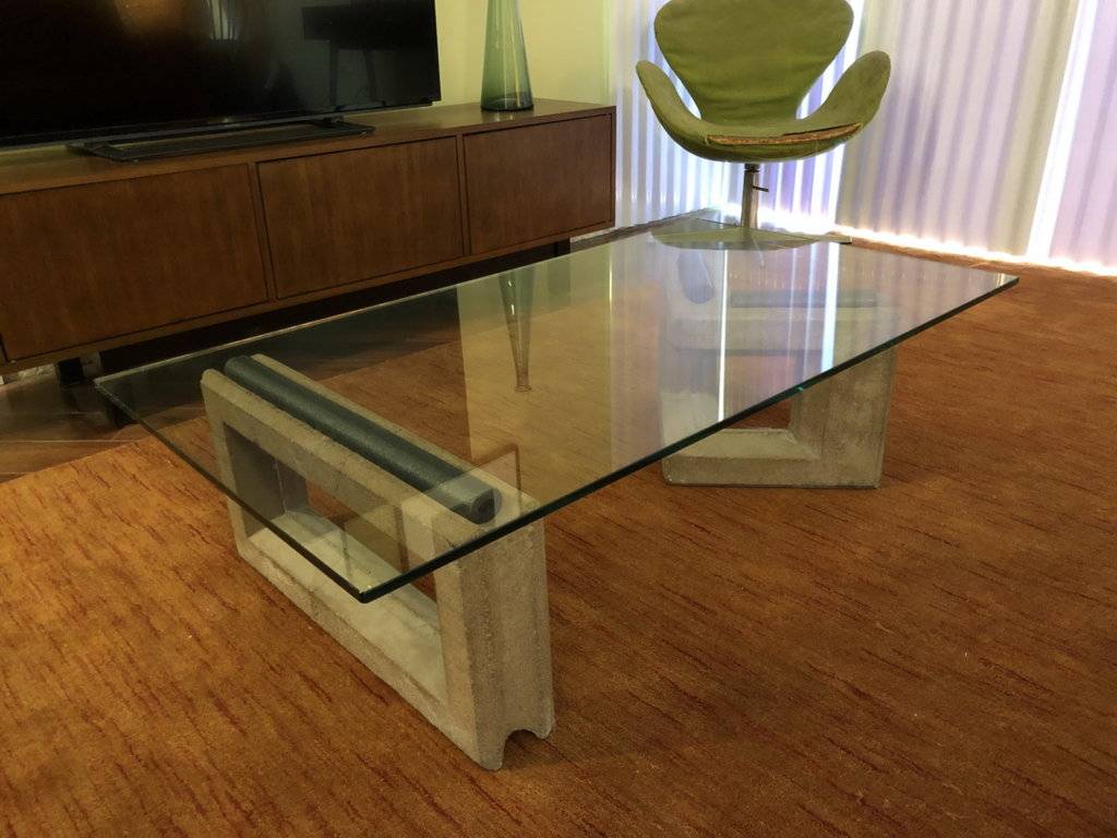

The shelf section is split in two equally, 12" on each side. The concrete blocks are from a Frank Lloyd Wright house, the pictures on the wall are of that house from that trip where my father acquired them. The pottery on the upper two shelves is my fathers.
The two toolboxes are my Great Grandfathers and are full of woodworking tools. The hearth is a wood mockup.
The chair is my next restoration, it is an Arne Jacobsen Swan chair, one of four my parents got as a result of the Watts Riots, lets just say it was a fire sale. I priced having them done and at $1800 a piece I figured I could figure it out myself.
I originally had rubber balls holding the glass but the straight end would want to roll, pipe insulation seams to work. I'm thinking of getting a sheet of glass to crate a lower shelf.
