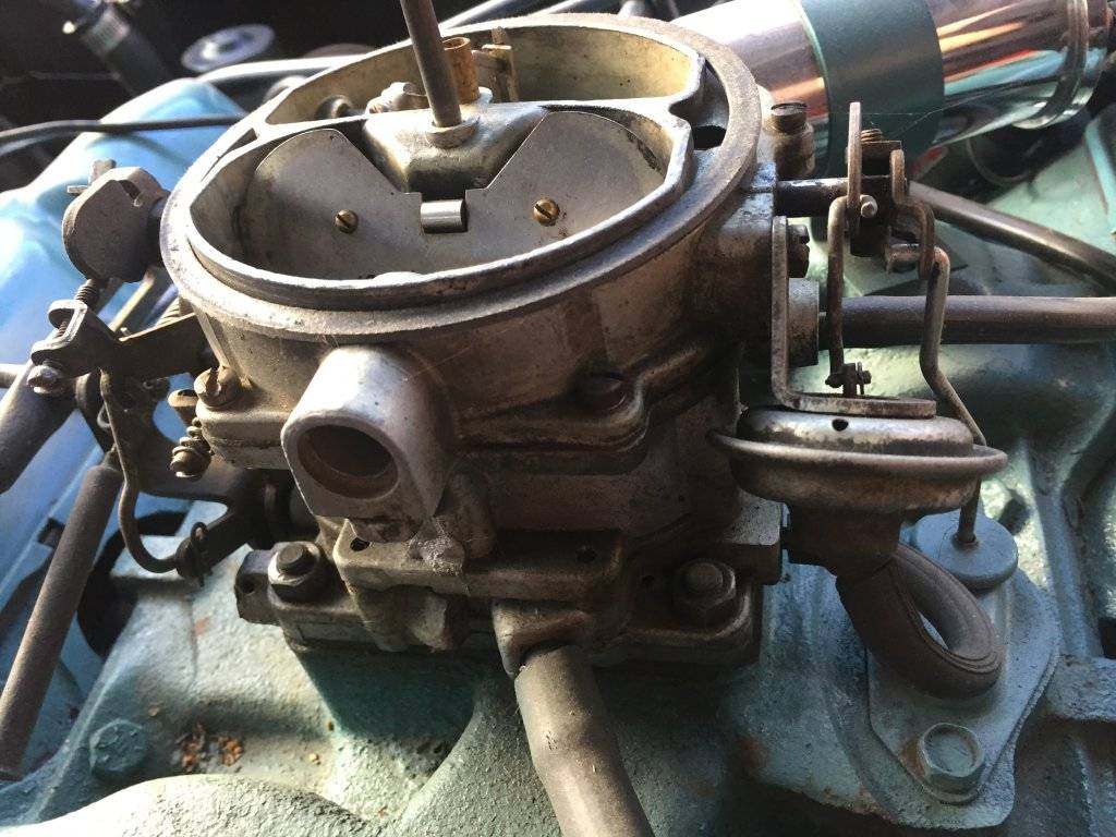

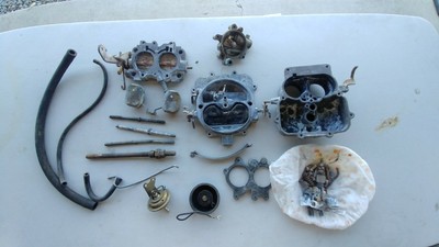

Time to rebuild my carb. Problem, I am not sure the model/make so I can order the proper kit.
I will post some pictures of it. (Also, if you notice anything off - springs, clips, wires, etc in the wrong place, please let me know - I am still learning.)

Carter BBD with the 1.56" throttle bores, otherwise termed "BBD 1.5". There were also BBDs for 318s, which had a smaller and more curved front section (float bowl area) with 1.44" throttle bores.

Is it the C in the circle that identifies it as a Carter?
Also, how does it identify as a 4421s? It only has “6-1790” cast on it?
Well... No. First I would have to search for Carter and that number on the carb does not tell me if it is stock or off something else nor if it’s the model number.
As for trusting what is posted online I see enough contradictions and corrections and back and forth on here, alone, to know even those knowledgeable disagree. My factory service manual does not get overly specific due to potential number of different carbs for 1968...
As for a bag o carb parts from an estate sale barn find - who knows what’s really in there. All she did was list the number and hers has Carter on the casting - I didn’t see that on mine.

Basically what you'll be doing with the rebuild is to ensure all of the small passages and such in the fuel circuits are clean and unobstructed by varnish and other soft deposits. Then adding new gaskets to ensure all of the fuel is getting to where it needs to go.
When you take the carb apart, then you'll have gaskets to compare to and use the appropriate ones. Worst case scenario is that you might have to re-use a few of the venturi cluster gaskets, I suspect. Usually there are more gaskets than needed for the Chrysler applications.

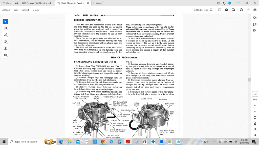

The only info I see here is it's a 1968. I'm going to assume it's a Plymouth. Looking at the pics, I can see no distributor in the rear, so I can assume it's a 383. Same pic shows the throttle linkage to the trans, so it's an automatic. So, 1968 383 2bbl Carter BBD with an automatic and if it's not a Plymouth, the Dodge and Chrysler are probably the same carb numbers.

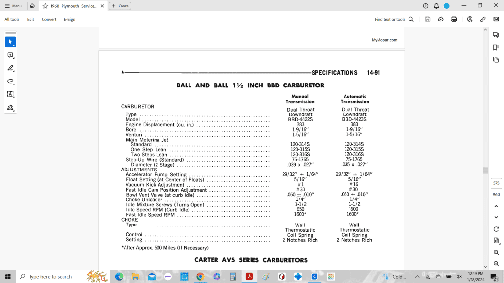

Plymouth FSM shows BBD-4423S I don't have a '68 Dodge or Chrysler FSM to cross check. That shows two carbs, one being an auto and one being a stick. Other models could be for California or possibly Canada, but in this Plymouth FSM, there is really only one carb listed.

It’s a ‘68 Chrysler with 383 (and automatic - never would have guessed they used different carbs between std and auto for the same engine in the same year!).
I’ll cross reference my FSM (and post what is pictured in it) but the bbd carb pictured does not match the one on the car. In fact, the FSM is vague on the BBD carbs. That’s why I posted on here.

Yes, the carbs are usually different between the automatic and the manual trans. It could be a very subtle difference and the carbs may interchange without any noticeable issues, but it's done for the best drivability for each combination.
I don't have a '68 Chrysler FSM to look at, but the Plymouth FSM has a section on the BBD 1 1/2" that looks pretty decent and it's the carb on your car. The FSM can be frustrating at times... They sometimes reuse old illustrations and pictures... And you always have to remember it was written before the car was built.
If your FSM doesn't cover it, try going over to MyMopar and grab a Plymouth version.
Here's a couple links to the Mopar service highlights that may help. The 68-2 doesn't have much, but the 69-8 has much more. https://www.mymopar.com/downloads/mtsc/261.pdf and https://www.mymopar.com/downloads/mtsc/243.pdf
