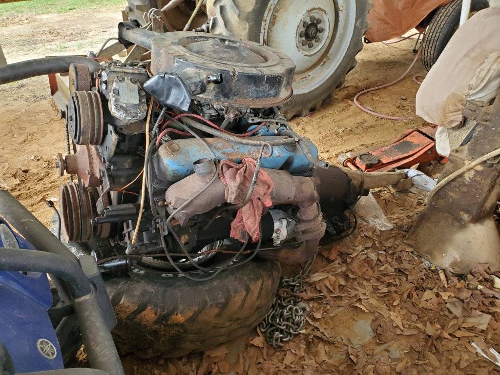

Jun 20, 2023 #1 P Plymouth man Member Joined Feb 12, 2022 Messages 59 Reaction score 27 Location Woodland ms Can someone tell me if the part at the tail of this transmission is needed never seen one it came out of a 77 newp
Jun 20, 2023 #2 C CBODY67 Old Man with a Hat Joined Mar 27, 2011 Messages 12,586 Reaction score 8,786 Is that not the '74-'78 rear trans mount for Formal Body Chryslers? More rubber isolation than prior mounts, I suspect. CBODY67
Jun 20, 2023 #3 gyknot Active Member Joined Nov 20, 2018 Messages 225 Reaction score 243 Location Deer Park, Wa. I've seen a few like that. Not sure what they were out of though. I always thought it was some sort of vibration damper setup. I've removed them and never had an issue yet.
Jun 21, 2023 #4 Big_John Illegitimi non carborundum FCBO Gold Member Joined May 21, 2013 Messages 24,914 Reaction score 39,788 Location Marcellus, NY It's a weight to help dampen driveline vibrations and noise. Do you need it? No, not really... If the car had it originally, I'd leave it on, but if it's going in a car that didn't have it... I'd take it off.
Jun 21, 2023 #5 commando1 Old Man with a Hat Joined Mar 10, 2011 Messages 37,684 Reaction score 39,172 Location Sebring, Florida The dampener was added specifice to reduce NVH in the 35 - 45 mph range. It's an added improvement. Leave it on. It's not hurting anybody.
Jun 21, 2023 #6 P Plymouth man Member Joined Feb 12, 2022 Messages 59 Reaction score 27 Location Woodland ms Thanks guys I'll leave it on if it helps vibration
