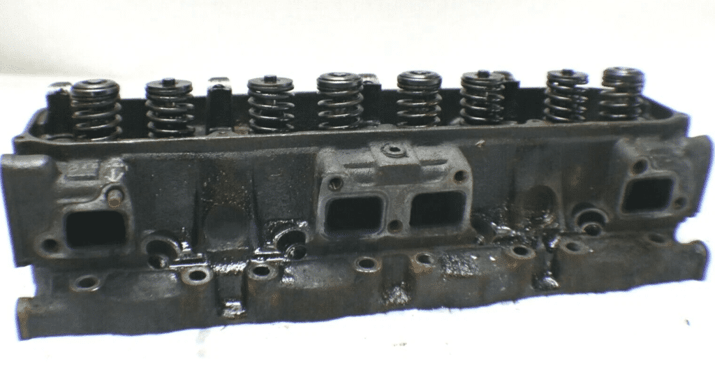

In looking at those cyl heads, are the center exh ports together or separated?
In the 1990s, my machine shop operative got in a pair of Chrysler 440 heads, but they were different. The intake side looked to be normal Chrysler B/RB, but they had a LA-style combustion chamber (not the normal 906 chamber), angled plugs (tapered seat), but the main cosmetic difference was that the exh ports were all separate. The customer also brought in the Holley 4160 from the motor. The carb number matched a 1972 Chrysler 440 MHC application.

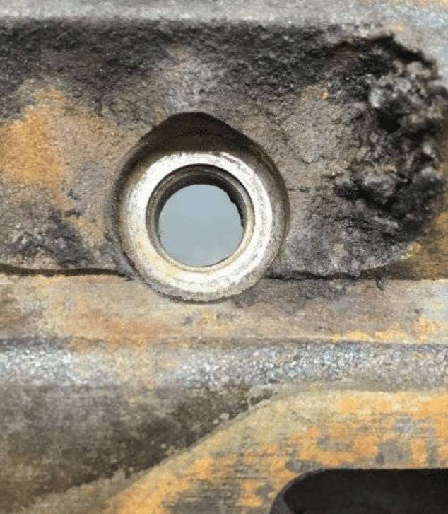

Regular passenger car big block wedge engines (350, 361, 383, 400, 413, 426 wedge, and 440) all used 14mm, 3/8" reach, retracted (gasketed), 13/16" hex spark plugs.

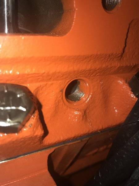

Late 1970s 440-3 industrial/truck engines used a 14mm, .460" reach, tapered seat 5/8" hex spark plugs, originally equipped with OBL9Y (Chrysler # 4091938), or substitute RBL9Y, or RV9YC. These were used for additional cooling. The heads were the similar raw 4006452 casting as other 440 and 400 heads, but were machined differently for the smaller plugs.
361 and 413 heavy truck and industrial, and some marine, engines used a 14mm, 3/4" reach, retracted (gasketed), 13/16" hex spark plug without a projected tip (example, Champion N6). The plugs have a slight angle mount. These heads have the water inlets on the front for the large high mounted water pump and completely different exhaust ports than conventional big block wedge engines. Casting number is 2899943.
Regular 13/16" gasketed spark plug hole:

5/8" plug taper seat spark plug hole:
