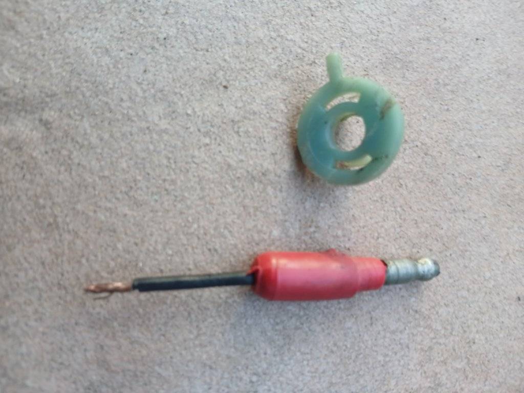

Most of my days are now spent on putting my 71 NYer back to a respectful and registrable state, as a result of apparently years of neglect and total absence of maintenance. However, I am going to see this project through to completion.

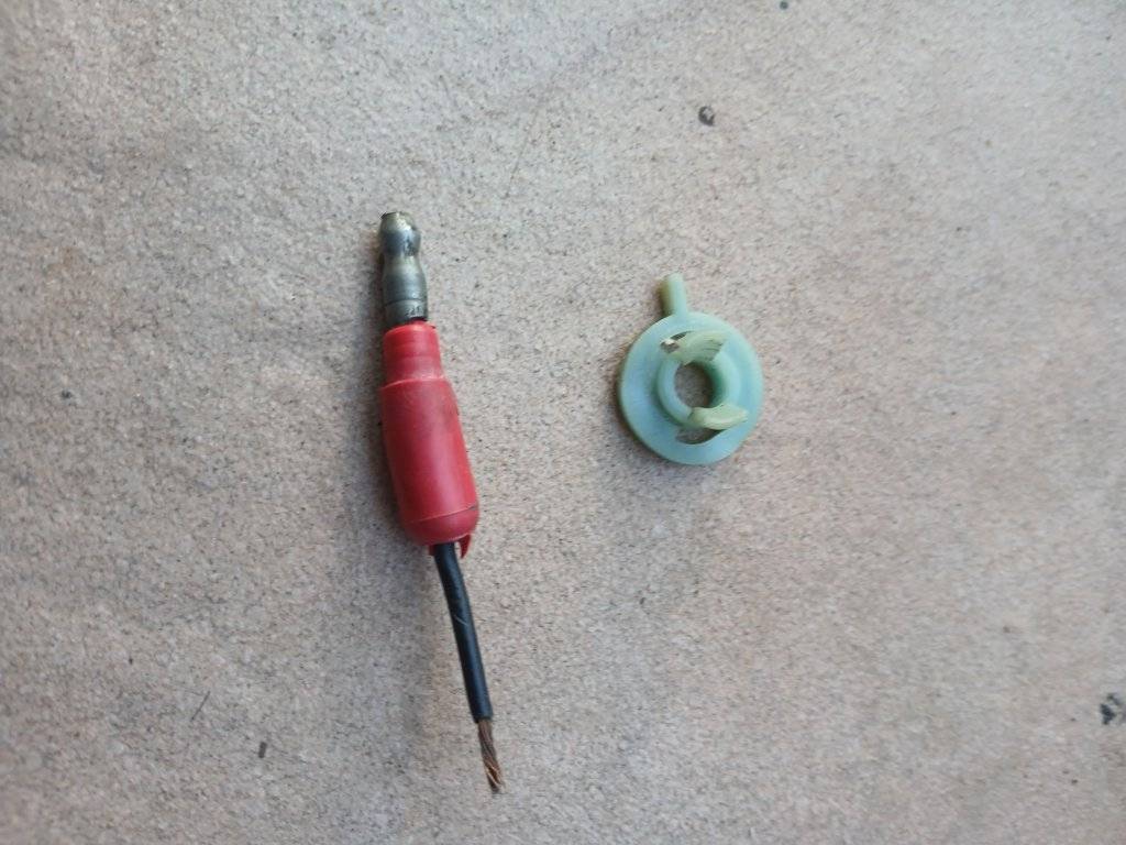

So, title explains query, and I really appreciate and enjoy the great replies I always receive from my Mopar mates in the Northern HEMI-sphere( I live down under, so thought this was a good one!). Attached is pic of a plastic clip, about 3/4 inch in diameter that has a protruding piece of same material. Does anyone recognise this clip? Is it a do
or trim clip or retainer?
The other electrical connector, with red base, black wire thats probably 18gauge wire had been hanging around my place for about 12 months. I have tried to locate it on wiring diagrams for a 72 Fury and 71 NY er, to no success. A few red plugs like this i can locate, but none have black wire. Would any electrical.resto enthusiasts be able to chime in? I would be so appreciative, as its starting to annoy me a lot...

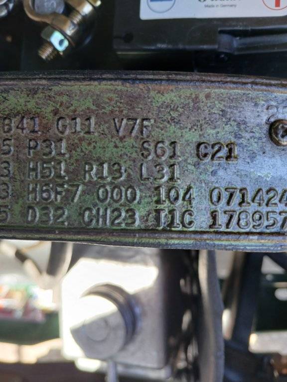

I have included a picture of some fender tag decoding i did 2 years ago when I first bought the car.

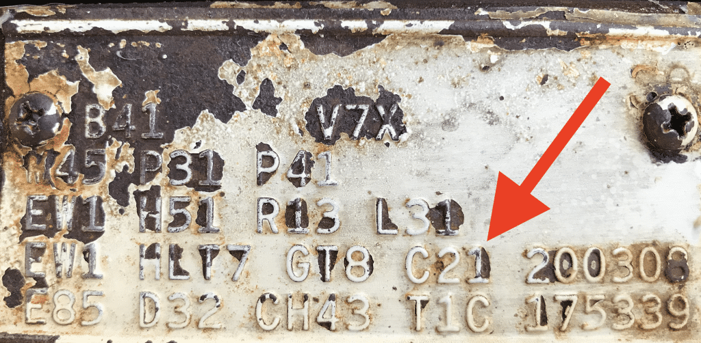

Thank you for this info. The fender tag info that you provided is missing the scheduled build date (SBD), which is the 3-digit code before the order number (VON).
Here is the closest VIN I have to your car in my (very, very partial) records: CH43T1C175339 is a 1971 EW1 NYer 4dr hardtop that went up for sale in Meriden CT in August 2020. The SBD was December 21, 1970 (C21).

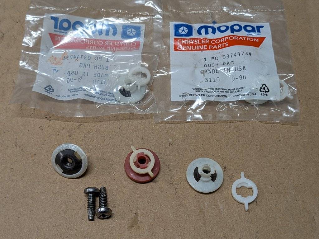

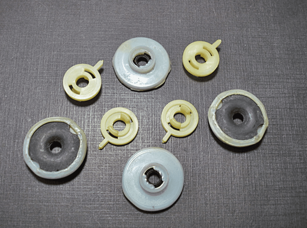

The pictured plastic item is a glass channel bushing, part number 3581597, which is used to fasten the side window glass to the support bracket through the holes in the lower part of the glass. The bushing is fastened with fastener part number 3499813 in some 1971 - 1974 models. The following image shows the bushings and fasteners:
The bushing and fastener was replaced by package part number 3744734 in later models and for replacement use in earlier models.

Thanks everyone for all your replies and thoughts and comments. Three c's and a d- no aftermarket stereo, and u were on the right track about window retainers-vaanth it'd the pieces.

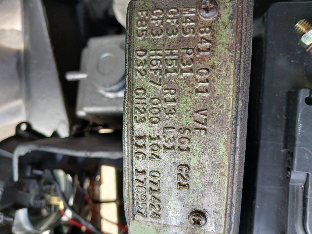

Ayilar- see attached picture of 1971 fender tag.

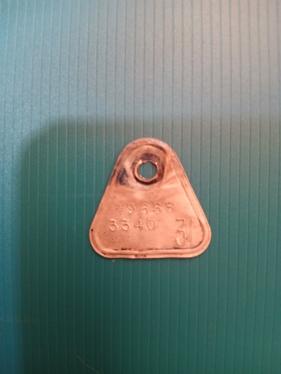

nb: i confused myself with my apparen early onset dementia showing itself again- the original Carter AVS tag states number 3340, indicating that the carry was built on the 334th day of 1970, I think.This is where I mixed up my info. I shall send thru pic of the carburettor tag, for those interested.
Best wishes.

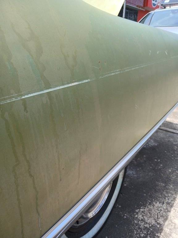

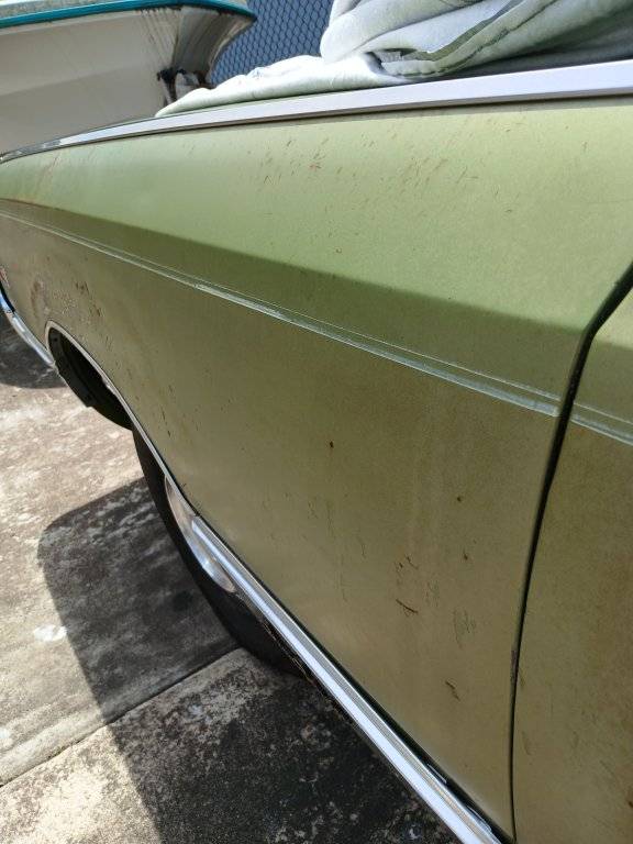

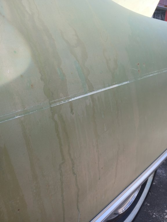

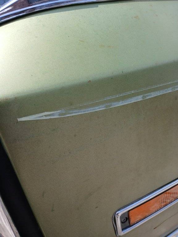

Thank you for the picture, though it is cut a bit on the left. I note the V7F paint stripes on the GF3 green paint, would love to see a pic of any remnants. The 104 SBD means a scheduled build date of January 4, 1971. Best wishes!
Thank you so very much for clarifying the build date, ayilar. I am very pleased to have it confirmed by an expert.
I'd be happy to send you through photos of the paint stripes- and remnants they are!

Included is the Carter avs tag picture.
Hello again ayilar, and my apologies for the delay. I spent 2 nights in hospital due to me waking up with a paralysed and numb hand. My thoughts were mild stroke or spider bite ( sometimes where I live, the critters will be felt crawling on one's leg or arm, but a quick aimed flick of the bedding usually puts and end to any further troubles...). Any
way, CT and x-ray imaging showed nothing interesting, and I've put iit down to too much wrenching parts on and off the old NYer. Not a bad way to get tendon inflammation i guess!!
Anyway, I think i owe you some pics, so please see if they are ok.I can send more stripes photos if you want -

Thanks a real lot for the photos! Glad to know you are OK.
