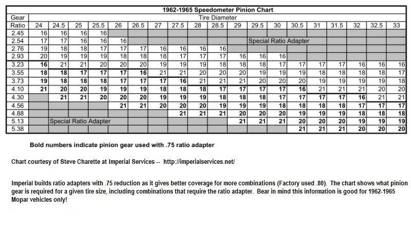

Before you send the speedo off for repair, have you checked that the speedometer gear in the transmission is correct for gear ratio and tire size?
Be sure to use the chart for 1962 - 1965... The later gears are different.
