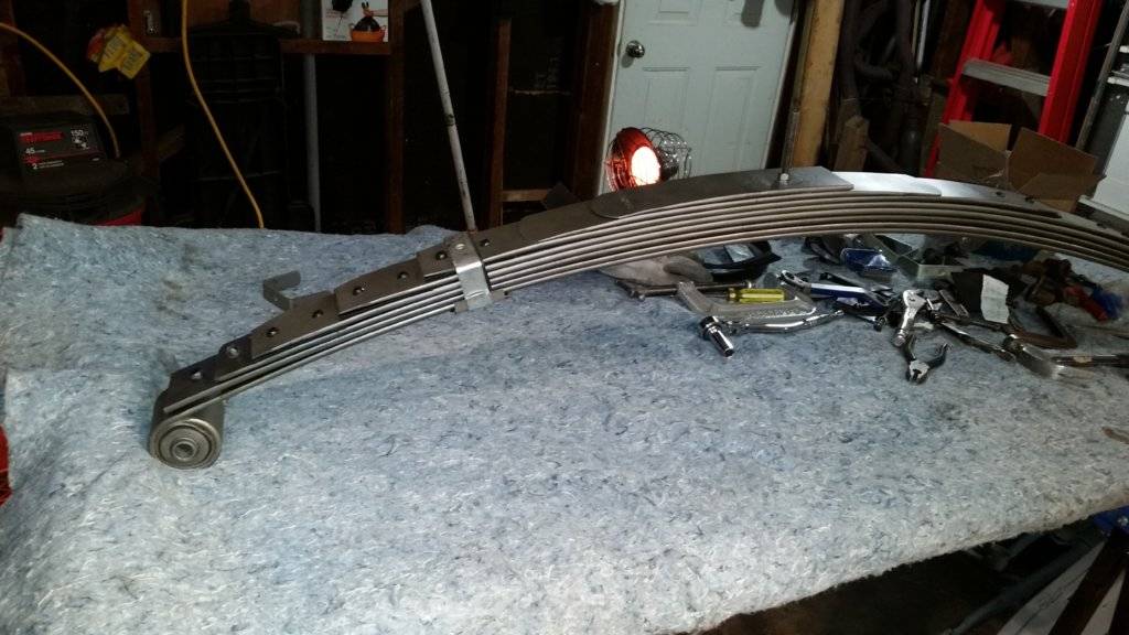

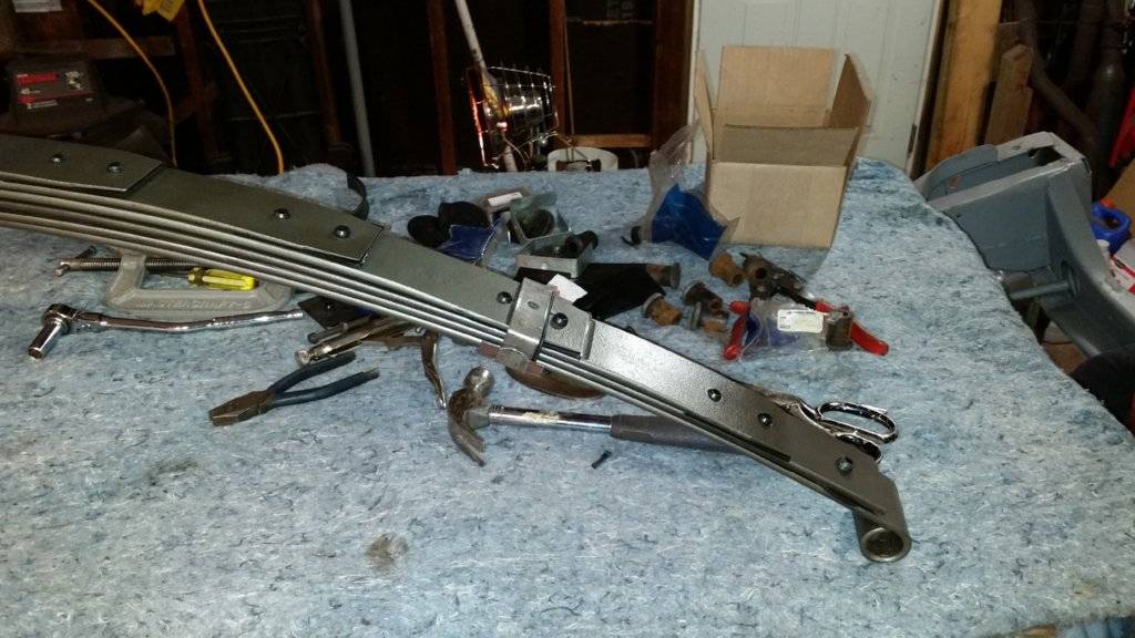

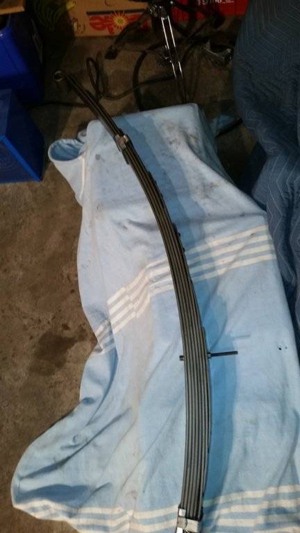

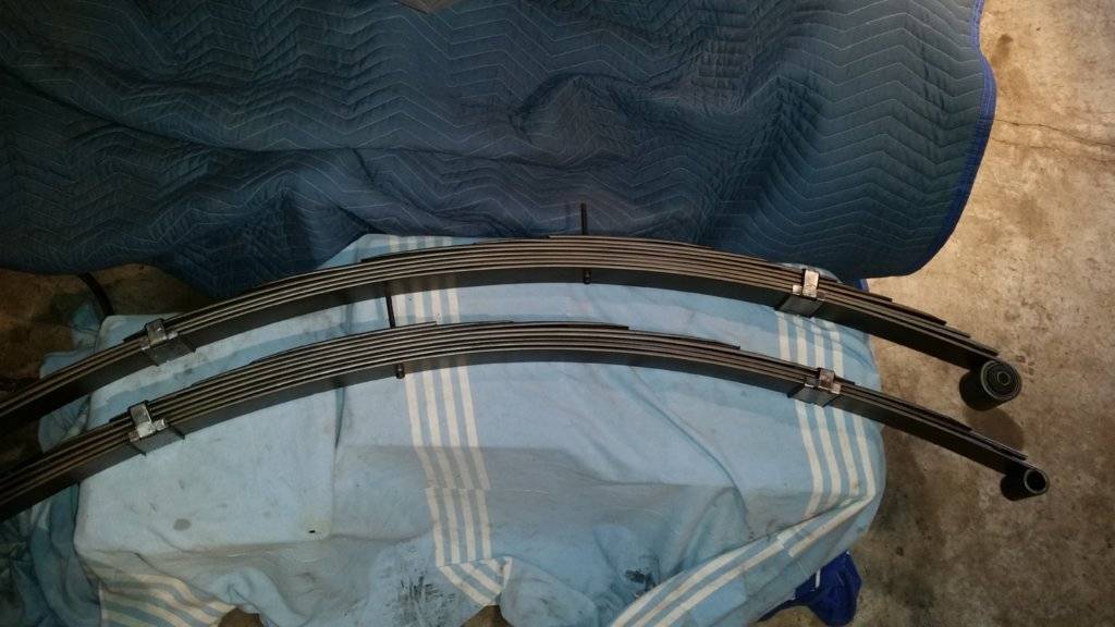

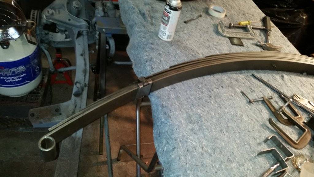

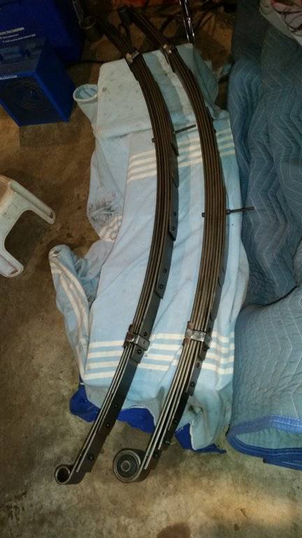

Because I'm doing a full resto, I took mine all apart. I had them all inspected by a competent shop (he carefully re-arched only a couple), and then I scraped and cleaned up each leaf, sprayed each leaf with cast-blast (closest thing I could get that looked like fresh metal springs), put in new tip liners (plastic parts with alignment nubs for the holes in the spring tips), new clamps with rubber gaskets, new bushings, new centre pins and nuts, and instead of the zinc alloy interliners, I used (on the advice of a couple of high end spring shops) graphite spray. Topped it off with new shackles.
Here's some pics:
Very nice, Ross. I should do the same thing as mine are a bit soft and sag an inch or so more than I would like. I guess we all do after 50 plus years, right? :lol:
