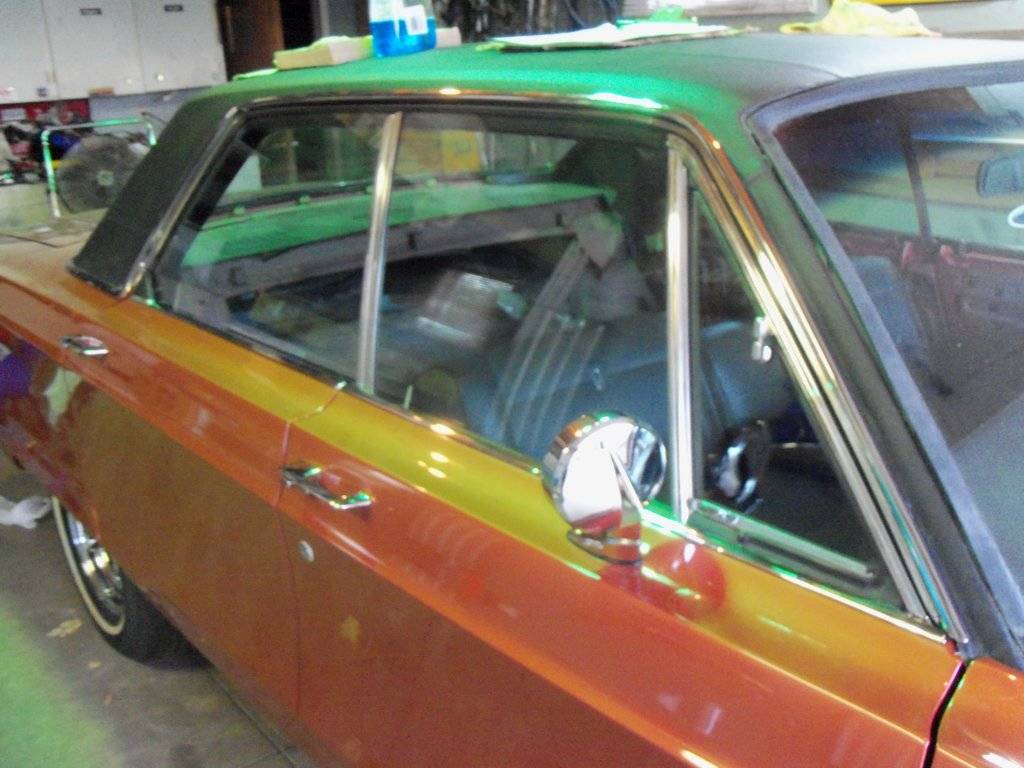

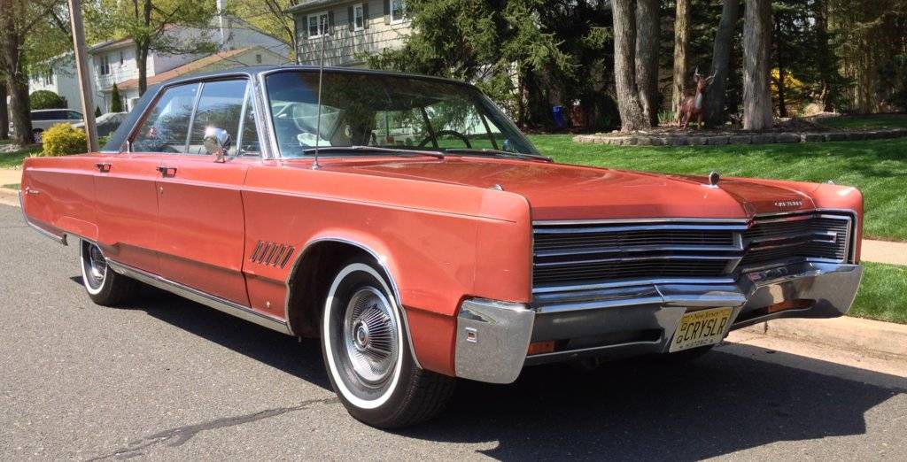

Howdy! From my experience, I bought one of the new repops and measured exactly the position of the holes on the driver's side. While this pix isn't the best the mirror does what it needs to do and looks OEM. There is no warning of any kind on the glass; conversely, I did this years ago. This '68 was bought new by my folks and did not come with that right side mirror. I can';t imagine not having the mirror. Maybe this can help you.

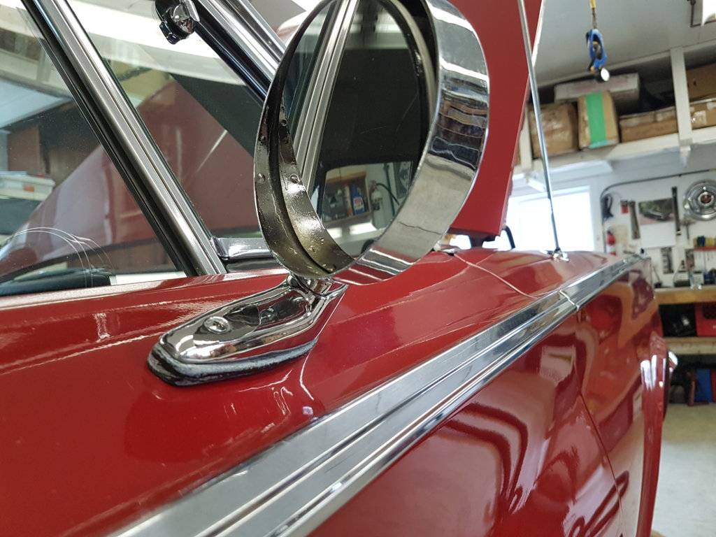

The factory passenger side mirror (as a mate to the driver side remote controlled mirror) were a bit of a factory afterthought IMO (although it's nice to have them for trim balance) - the 65-66 twin post manual mirrors were much better for that. Generally as a viewing aid the remote mate mirror is fairly useless unless you can position it well enough to see anything. I had convex glass cut and stuck on which greatly improves its function.
One of the issues is they don't adjust inwards far enough to see what you need to see, and combined with the various slopes of the door shoulder where the mirror is mounted will compound that issue. However there are some things the dealer had to help like special base gaskets to tilt the mirror to optimize its position.

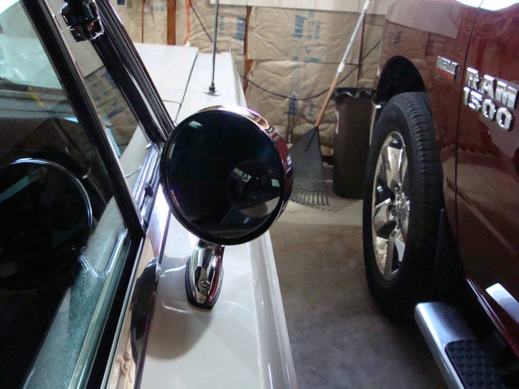

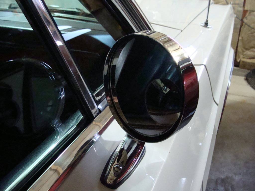

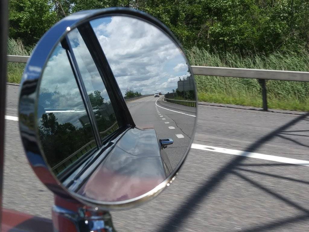

I added a convex mirror that covers the whole glass - much easier to see stuff now. I also added one of the rare wedge gaskets to help with positioning.

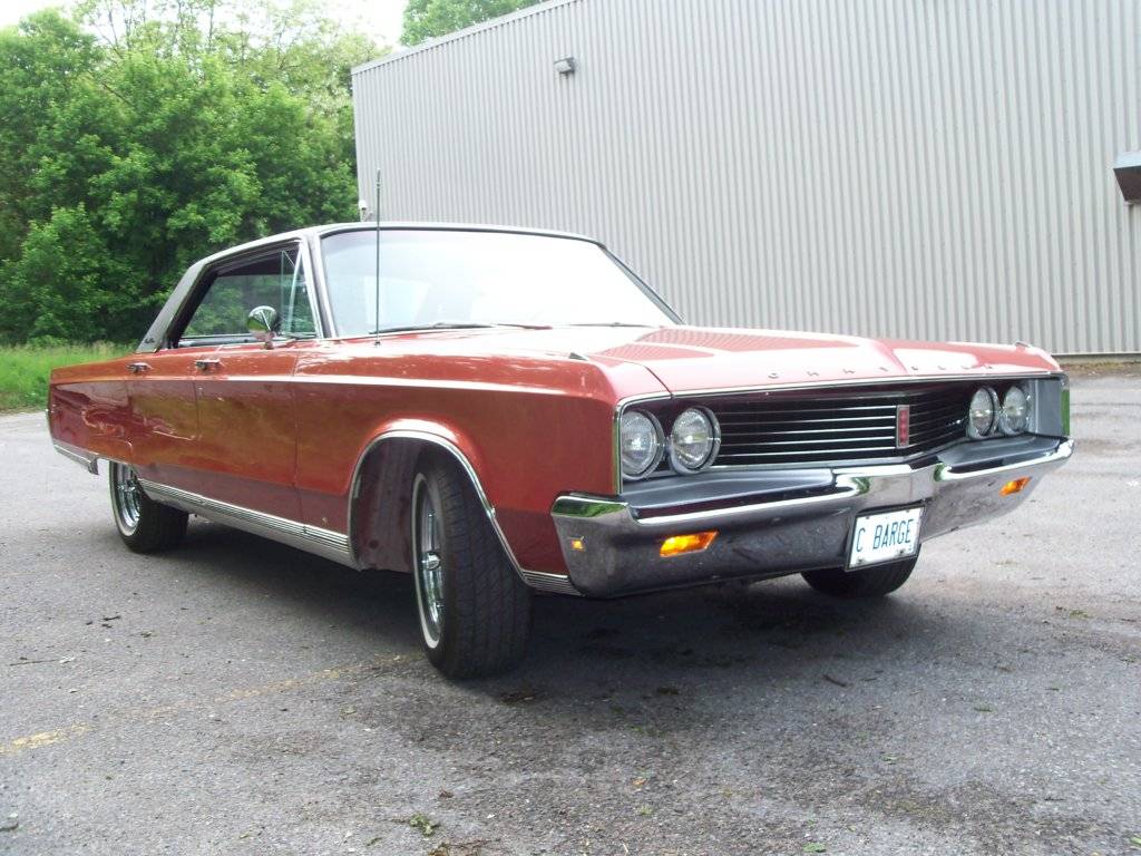

My old 68 NYer had a factory one and I did add a repop onto the BoaB.
On the BoaB I did measure exactly as the left side and installed from there.
Which way does the wedge gasket tip the mirror? Toward or away from the driver?

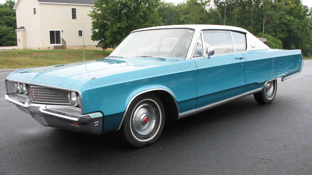

I seemed to remember something about this... We had a discussion in a thread about mirror position, 67 to 68. The '67 is mounted farther forward than the '68.
Went looking for a pic and found Stan's old car, which makes me think it was discussing his car. @commando1
that makes sense....I had a 68 polara body and the mirrors were much further back than my 67 newport...wondered why then....now I see.
