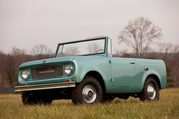

Oddly enough I thought you were talking about of these
Boy was i wrong @_@
