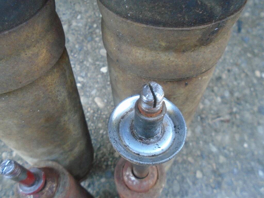

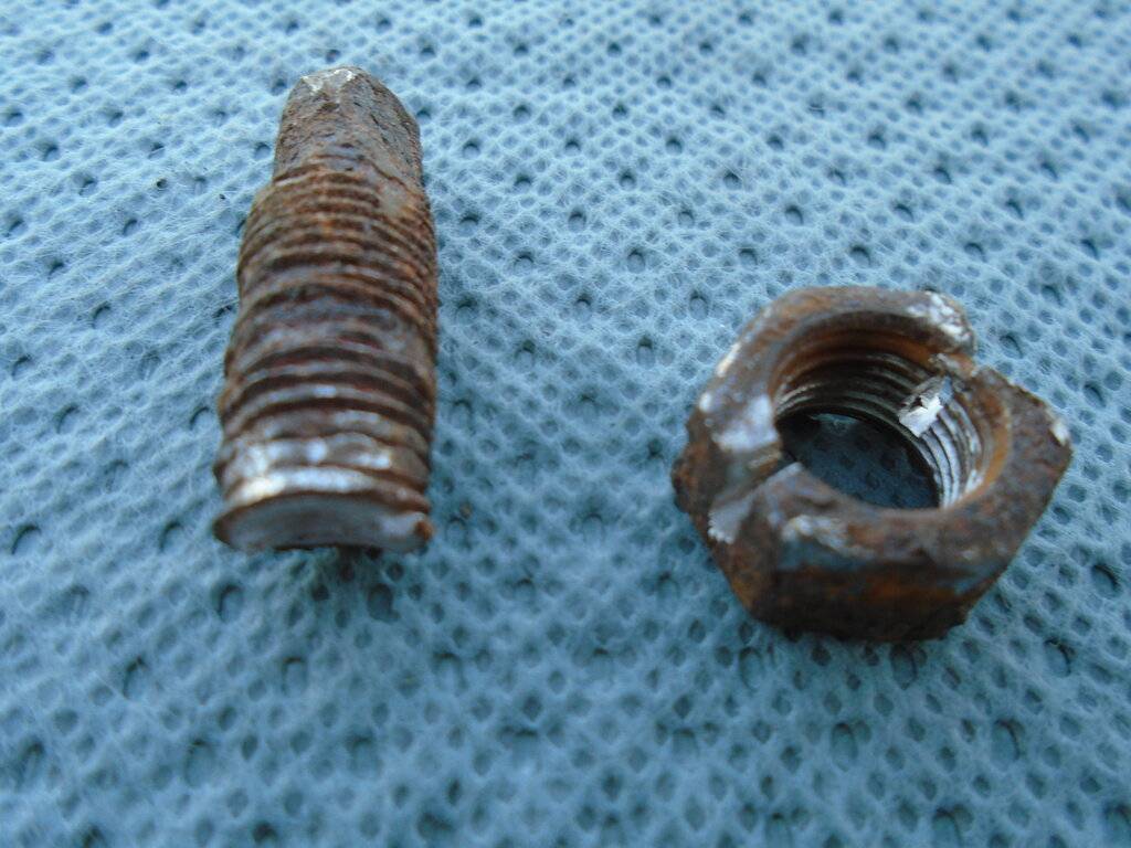

Here are some picks of the Shock install. I had forgotten about it. I am also including Kenny's Radiator Business card. Rear shocks were stubborn, but not that bad. as seen in the photos big creases in both lower tubes . The front shocks were nothing but trouble. Shocks used were NOT for a C body. That caused the lower control arms to bend at the lower shock mount location plus the upper mount was eroded at the tread that cutting off was the only option. Breaking the remaining exsposed thread of and cutting down through the nut is a doable solution. I use Kenny's Radiator for all radiator work. See his business card below.
