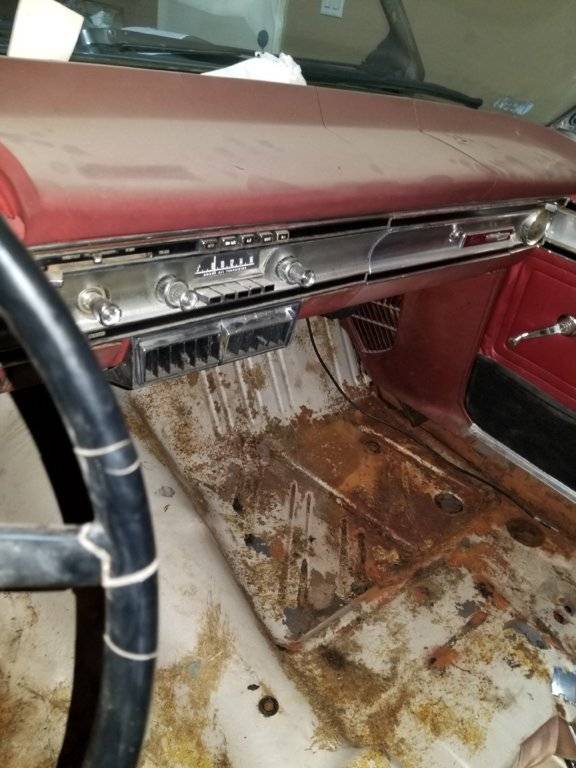

I do have any good pictures of the full interior before I tore out the carpet and seats, but I can do some more describing. The seats still have the chrome trim, the door card is red with a black carpet accent at the bottom, the carpet was red, and the dash is red. I'll look at some pics online. Here's a shot of the dash, it's all I have right now.
Very likely it could have black seats. If it was an all red interior, it probably would have had a red steering wheel and steering column. Would have expected black carpets, but those could have been easily replaced.

Well what if I told you it's a black wheel, but red column?

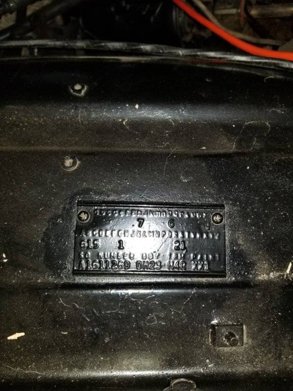

O know 66's are a little different, but would a picture of the fender tag help?
Under the TRM letters (trim code) on the tag is a 3 digit code. The first two digits are the car type, the last digit is the interior color:
D=Blue
R=Red
T=Tan
W=White
X=Black
Y=Gold
There are probably some other colors, these are the ones I know about. If the 3rd digit corresponds to the seat color, the seats are likely original assuming the pattern and style for the vehicle are correct.

The car was slapped together using spare parts, I remember talking to the PO about it. Wrong year engine, and mismatched interior parts. They were going to get a car going and decided to sell. Slowly coming back in my memory. :lol:

Just my 2 cents....with a red steering column, red dash, red kick panels and door panels, my guess would be it originally had red seats. Not saying black is out of the question but rather suspicious. Or I could be completely wrong!!

It would have been red, I had a red Monaco parts car years ago, everything was red.
