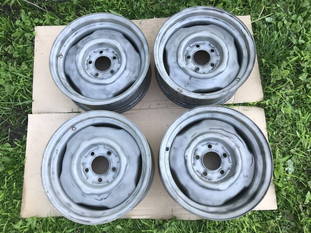

I believe they look like these:
The basic rim design was the same as the modern wheels used through the 80's. The difference is the lumps between the lug holes instead of the solid ring. They may possibly be the same part number as the "Hemi" wheel that people talk about.

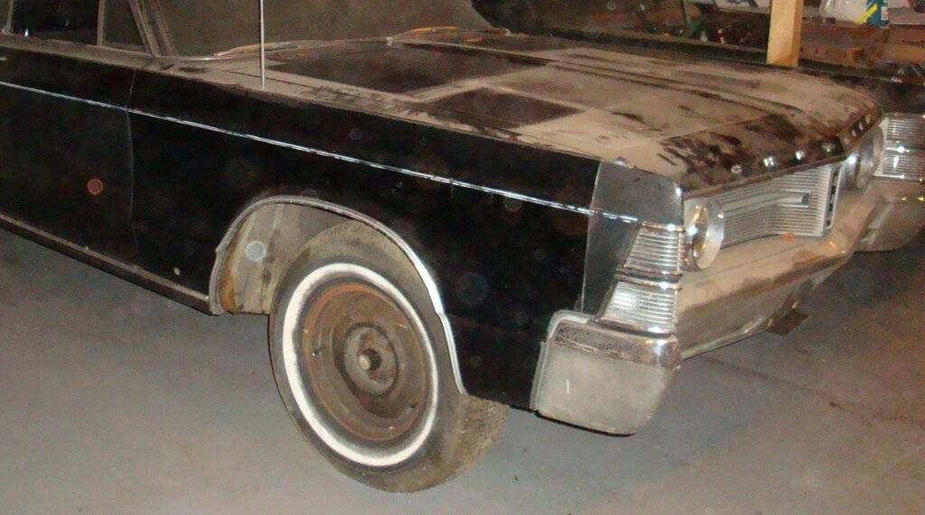

I have a '67 New Yorker with Budd's.
I'll see if I can get a photo of a wheel today. Cars are parked tight, so it may be tough.

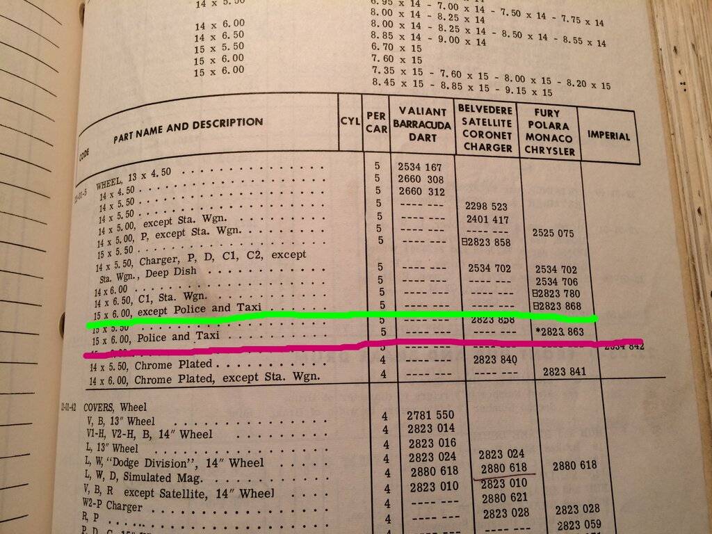

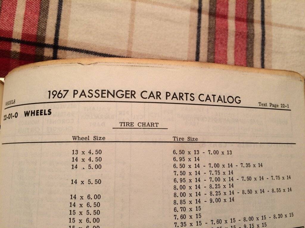

The 1967 parts book shows a different part number for civilian vs fleet 15" wheels. Makes no mention of disc brakes, just that the part numbers are new.
