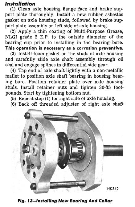

I did a set at a buddy's house recently. My first time at it.
We used a little HF 12-ton press and it worked fine with no heating, etc for installation of the new bearings.
Biggest effort was removing the old bearings, and there are numerous tips for that.
I heard afterward that putting the bearing on an anvil and hitting the outer race with a hammer can crack it - I wish I had known to try that. But that has the potential for shrapnel, so I'm content to do it the way we did.
Cut thru the outer race with a 3" die grinder, stopping periodically to see if you can crack it with a hammer/cold chisel.
The less cutting the better, less chance to cut into the shaft, esp the larger journal where the seal rides.
Perhaps this is obvious, but - make sure to put the outer seal in the correct way, and don't forget to put the retainer plate on the axle before pressing the new bearing on.
My axle shafts were both the same length, but verify yours to make sure.
