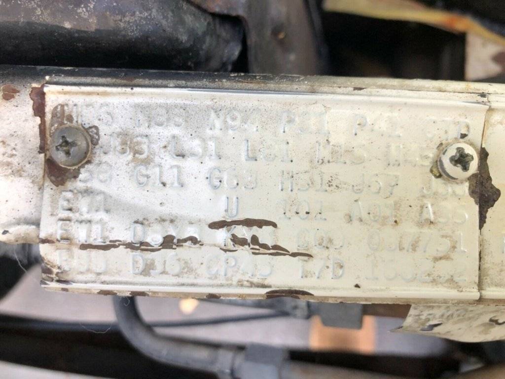

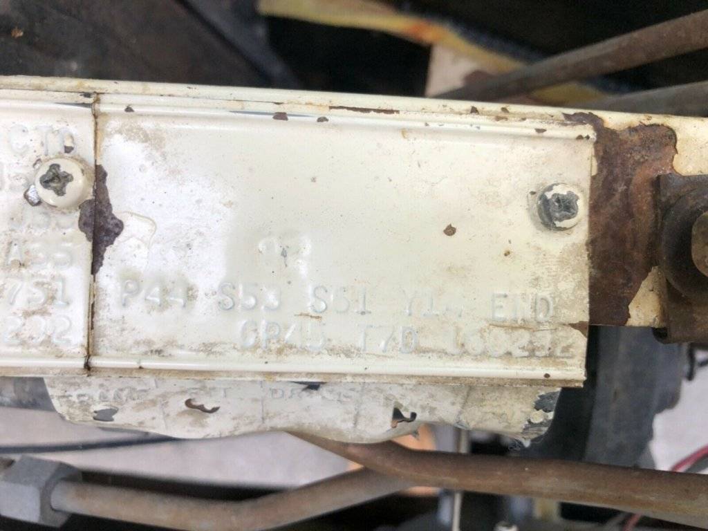

Yet, also in Colorado they knew how to do it. Recently a 1977 T&C was offered on Ebay "from Colorado mountains". Here are the tags:
Is there a signature of anyone named Ron Slack on that car? He is the dad of a good friend of mine.

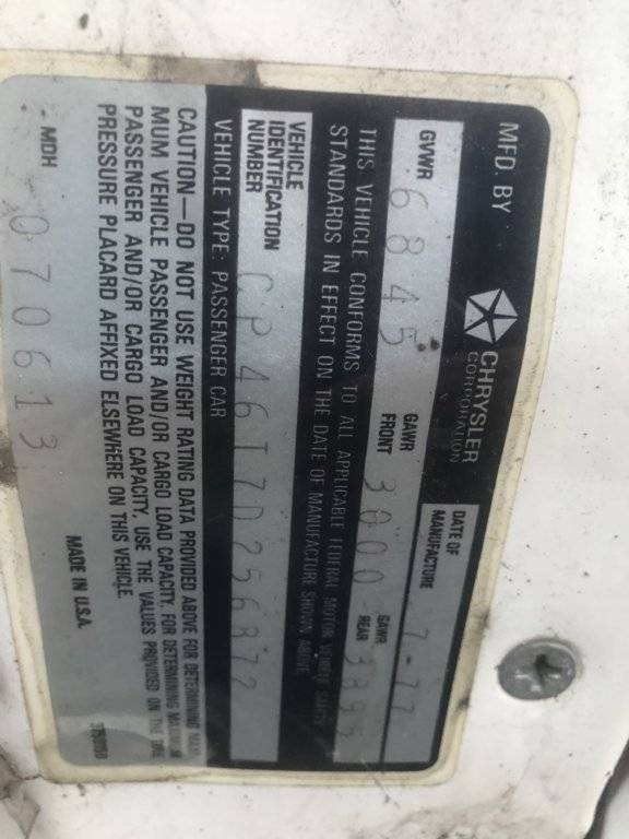

If your car has a door sticker, look for MDH (Month-Day-Hour) in the lower left corner. For the T&C under discussion it's 070613:
Mine was built on the evening shift of February 28. It would have been cooler if it had been built on my birthday, but one can't have everything.
It says something about the mass of these cars that they have GVWRs exceeding 3 tons - more than my Dakota!

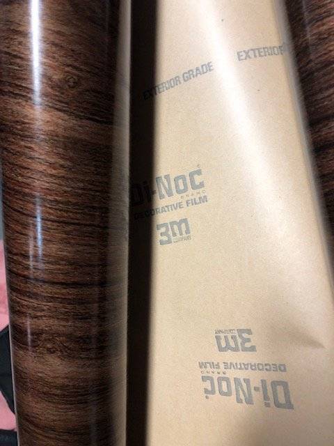

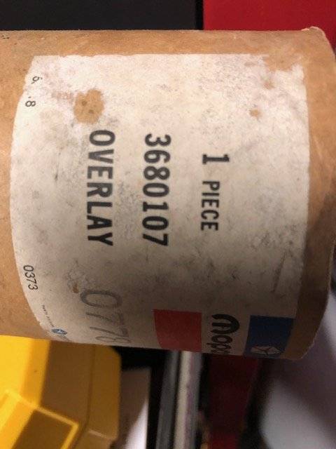

As for the di-noc... it's one thing I don't have to worry about. Dad had a lot of friends at Chrysler back in the late 70's. One of them was a designer and had a friend of his at 3M send my dad enough rolls of the di-noc to redo the wood. I'm slowly collecting parts and should have our T&C back on the road by next summer.

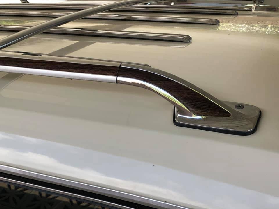

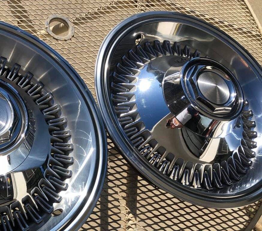

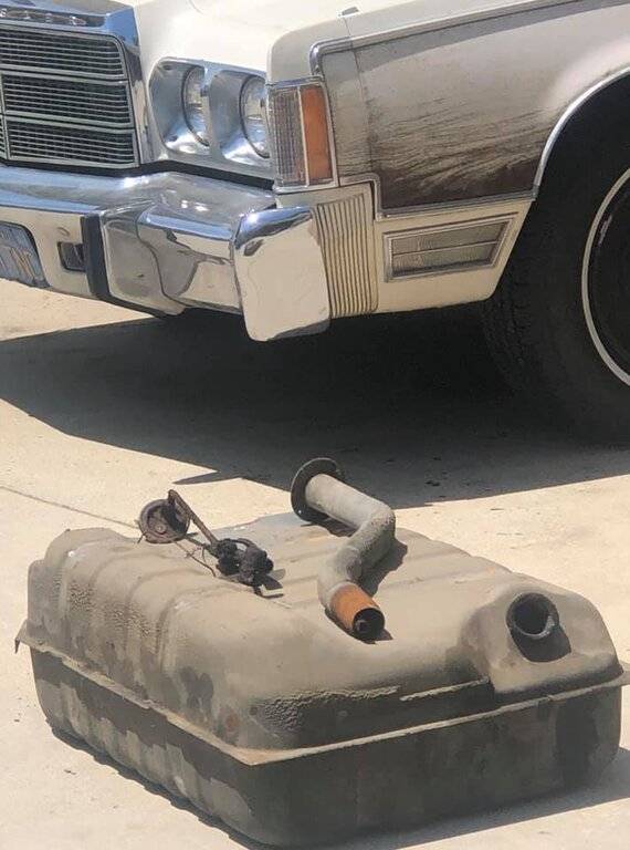

Hi everybody! Over the past couple of months I've made a lot of progress. With the stay at home orders, I've been able to take some time and work on the Town & Country. The brake and cooling systems are done, carburetor is rebuilt, vacuum lines are replaced, and it has a new set of tires. The ignition system (wires, plugs, starter, voltage regulator, ballast resistor, coil, etc) is all new. I serviced the engine and transmission too. I've cleaned and rebuilt the wheel covers, removed and detailed the roof rack (with new vinyl wood), polished the roof, and replaced the broken parking light lens. Today I removed the trailer hitch assembly and the fuel tank. The tank was rusty inside and is going to need substantial work. The ring that the sending unit gasket sits on was completely rusted away. I think I'm going to have to splice in a sending unit flange section from another tank. It's not a huge deal, but it will slow my pace a little. Since the wagon tanks are different than the sedans, I can't just go out and buy one. That's a bummer.

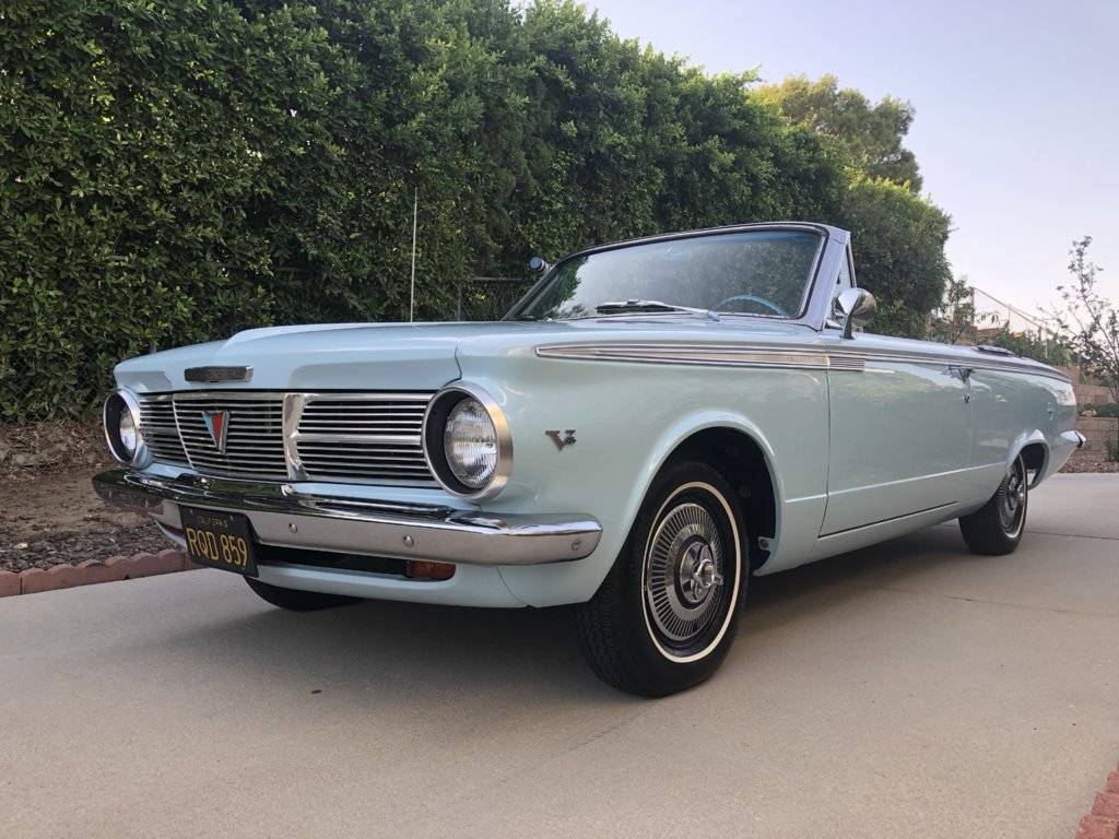

This is my 65 Valiant V-8 convertible. I bought it as my first car in 1983. It had 16,000 miles at the time. Now it has about 45,000 miles on it. Lots of cars have come and gone throughout the years, but the Valiant has always been my favorite. The T&C will be an easy project and a part of the family.
Aaron
Your 65 Valiant convertible is really cool, but I think of the cars I have seen of yours over the years, your 1960 Polara station wagon is one of my favorites.
Love the Valiant convertible. Almost bought one last year in the same color with the 273 motor in it. Manual brakes and power steering. I wanted to buy it and change out the grille and lower valance to make my own 65 Barracuda convertible that Chrysler Corp never made. Sadly, when I drove the car it seemed underpowered in the engine department (tired, but no knocks or smoke), overpowered in the steering dept, and again underpowered in the braking department. I have a 57 and 61 Chrysler 300's, and I guess I forgot how 'downmarket' the Plymouths were from a letter car. I drive my letter cars long distances in comfort to get to car shows during the season, but I don't think I'd like being in that Plymouth that I test drove for more than 20 minutes at a time and under 60 mph. I'm sure it could have been gone through with some modern A-body upgrades to brakes and suspension, and a freshening up of the motor to 4 barrel dual exhaust status, but I wasn't looking for a project, just something I could change the look of to have a unique Barracuda convertible to mess with people's heads at cruise nights. I also have a 2005 Magnum that I turned into a Chrysler 300C commemorative station wagon to use as a daily driver. The car looks much better with the 300C nose and trim. That only took one weekend and drives great.
That's a cool stash of Di-Noc! Do you or anyone else know if this exact color/pattern is still being made? I've ordered samples of many colors of 3M Di-Noc and none are spot on or even close really. Most of mine (1977 T&C identical color to yours) looks decent, but I need some for the rear and the rack.
