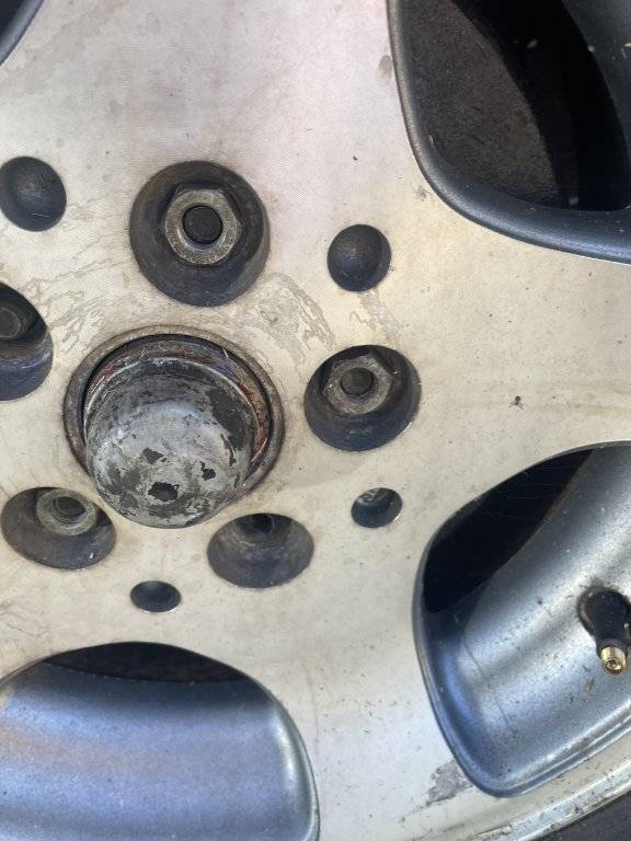

I have a 68 fury iii with stock lugs I need longer stud than stock I have drums allway around I need some suggestions or direction on where to go any help would be great

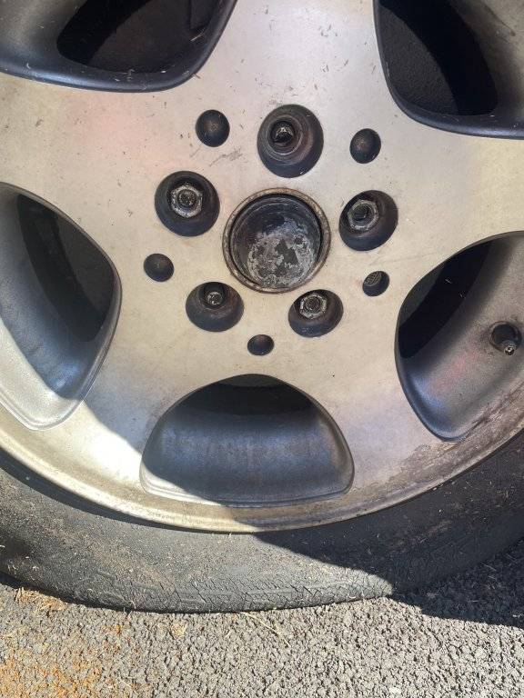

I have jeep Cherokee wheels on it now no factory wheel I had to use a 1/4 spacer I just need longer stud maybe I’m not sure I’ll take a picture of the wheels on it tomorrow and post it

I know right on the rubber it has 20in wheels I didn’t like them so I found these with rotten tires just to roll on in yard till done so longer studs
Definitely not enough thread engagement.
Are those wheels supposed to use a through style lug nut or conventional conical seat?
