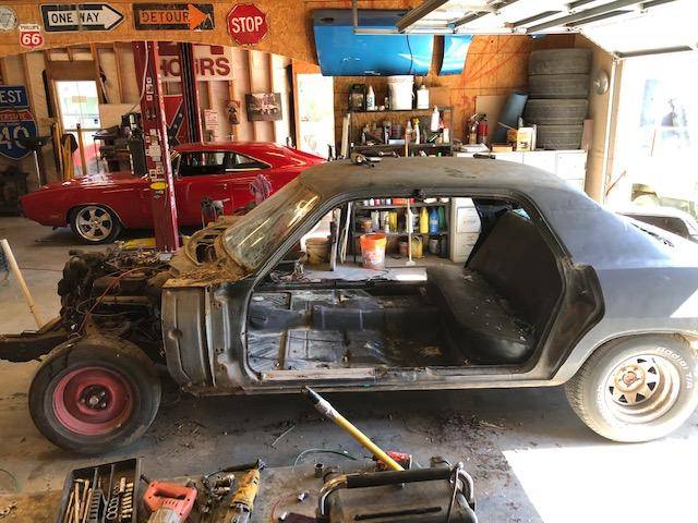

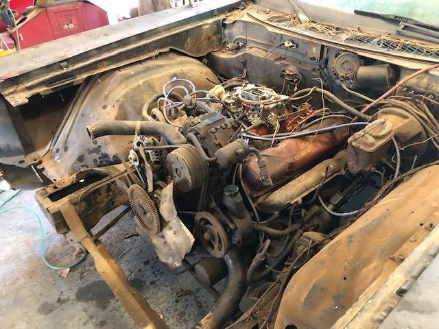

Closer inspection and sober, realistic thinking led me to the decision to part this car out. Rust, body damage, a lack of cool options, and the fact that the engine and rear axle were the only real value in this turd helped aid in the move.
I shot some video of the engine starting and running to use for a Craigslist ad for the engine, then pulled it into the shop....
It had a rusty and pitted roof, I'm guessing from a worn out vinyl top? There were metal patches above the rear window channel that I did not see until I started cutting. The floor pans are rock solid. I may save them to sell at a fair price.
Rust in the trunk floor, poor body repairs on the RH side...
It sucks to lose another one but the closer I looked, the more this was either a Derby car or a parts car.

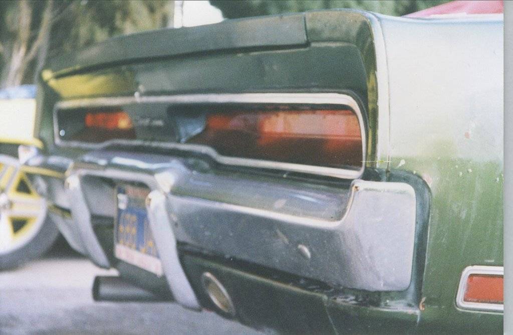

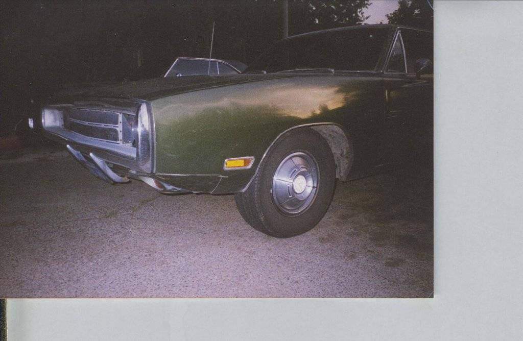

How about some pic's and info on the Charger in the background.:D
Sure...

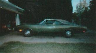

The Charger was advertised in the local paper in March 2000. $2500 or best offer. 318, 904, green on green.
The owner had two cars and was moving. He decided to keep the other... a '76 Mercury Cougar!
He was hung over the morning that I arrived. I drove the car and was sold on it. I offered $1700 and he accepted.
It was mostly complete but pretty worn. Rust around the rear window channel due to the vinyl top. Rust on the trunk floor but the rest of the car was solid. 318 ran great. 904 had been rebuilt and shifted great. New carpet but shredded seats and a cracked dash. I drove the car for work (Construction) for over a month 130 miles a day when I was rebuilding the engine for my work truck.

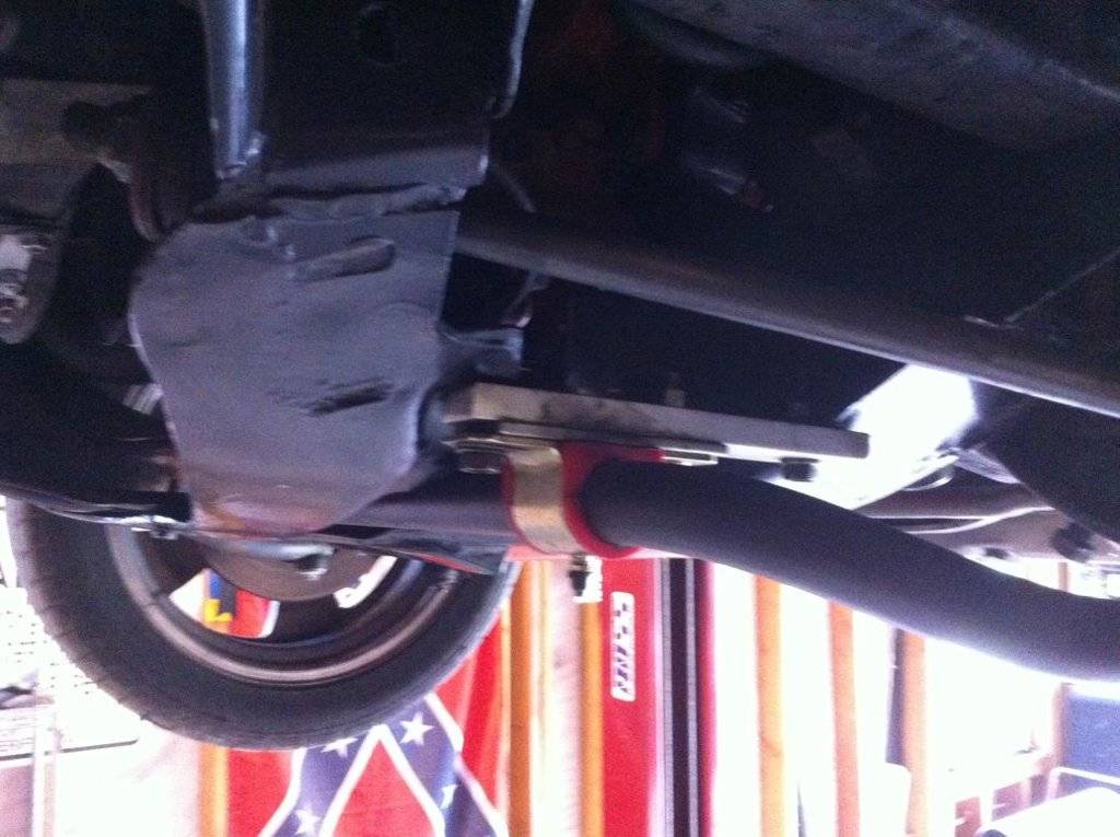

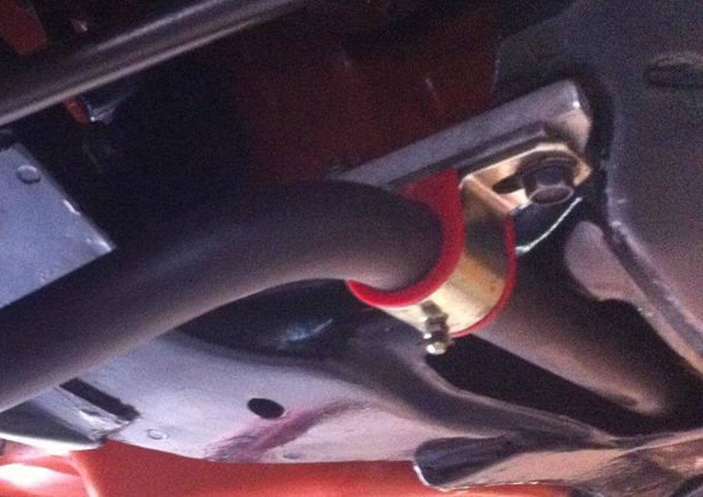

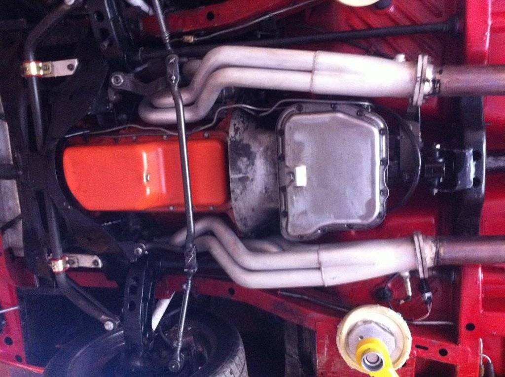

The suspension has been improved with 1.15 torsion bars, a 1.25 sway bar, Bilstein shocks, reinforced lower control arms, reinforced K member, Firm Feel Stage 3 steering box with Fast Ratio arms, 5 stage leaf springs with a 3/4" sway bar, Bilstein shocks.
Thanks for the pic's and the story with them. How do you like the Firm Feel steering box?
I liked it for awhile but nothing can be done to completely eliminate that slop in the middle of the travel. Oddly, when the steering was easy to turn, I barely noticed the slop but now with Fast Ratio arms, the effort to turn is greater (Which is fine unto itself) but the increased effort to turn really highlights the on center slop. It is a design flaw of a 60 year old steering box design. I am seriously considering a Borgeson steering box.
