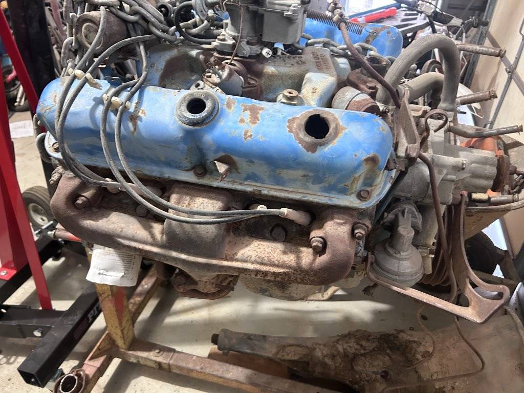

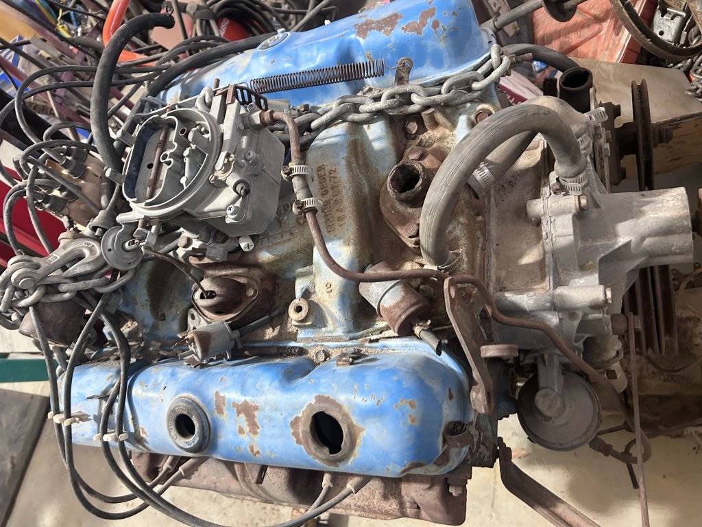

Hello everyone, I’ve been leaning on eventually building a new engine and transmission for my 72 Polara, as of recent my a904 is taking its sweet time to go into reverse and sometimes drive. The current engine is a 360 and healthy so I’ll drive it till it can’t. But I have an itch for more. I have this spare 360 with the small block 727 and looking to make somewhere around 450hp for a nice daily and maybe a few passes here and there. Any recommendations for where I should start reading into? I’d say the builder books but I’d love to hear your opinions.
