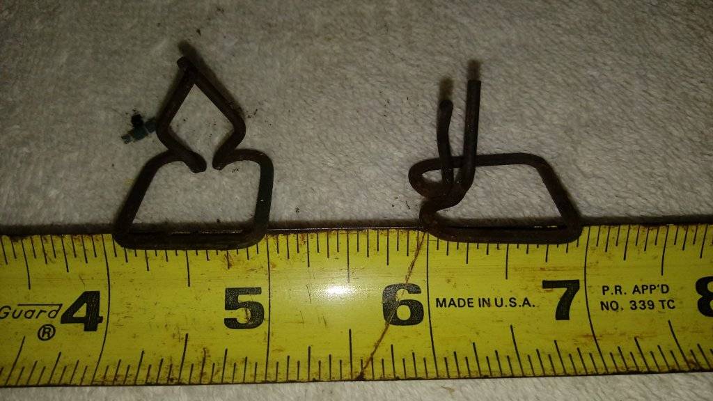

I am replacing the wiper motor on my 1967 Monaco, and before I remove the cowl cover I need to remove the lower windshield trim. Does anyone know what the clips look like? I would like to order some in case any break. Thanks in advance.

Those clips are typically robust and rarely break unless been living in the salt belt for 57 years.
Here you go...
Great, thank you for the replies and picture!
