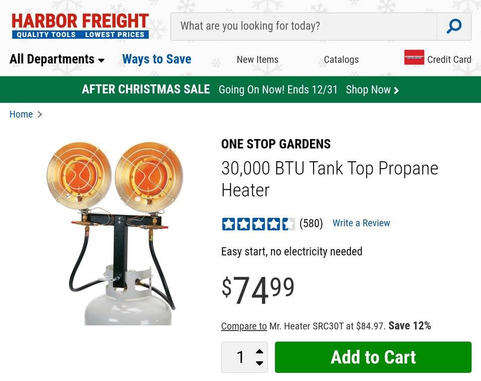

Another option. K. I. S. S.

If I were in your position, I would only use a 20lb tank topper heater as suggested by @commando1 in an emergency. I have a couple and they work well, but a proper propane furnace with venting is the way to go. Tank toppers and other similar heaters are supposed to be used within open or semi enclosed spaces only.
Get a proper furnace - known as Unit Heaters.
