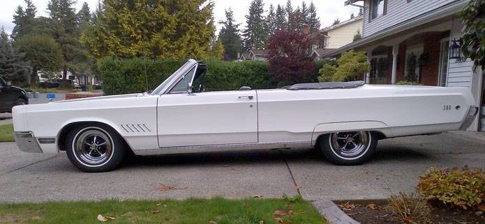

I am finally turning my attention to the wheels of my 1968 300 convertible. I have decided on the Wheels Vintiques Magnum 500. I am looking for some guidance to make sure I am purchasing all the right parts, and the right wheel size. I have 15" wheels now, and like that diameter...I just want to make sure I have the width correct (as well as the other accessories). Below is my current shopping list from Summit Racing.... am I missing anything?
Wheel Vintiques 54 Series Magnum 500 Chrome Wheels 54-5712044. (15 in.x 7 in., 5 x 4.5 in. Bolt Circle, 4.25 in. Backspace)

Note that the 4-dr ht is a print ad and was in the sales brochure for 1968, so its ride height is "factory" while the white convertible appears to be a bit lower, by comparison. The hardtop would have had 8.55x14 tires. By observation, this would equate to P225/75R-14, which is impossible to find (although I found a set in the early 1980s, and later P245/75R-14 BFG Advantage T/As (NOS from Coker, back then). When the 15x6 W23 16-Slot Class 2 Road Wheels are used on these cars, the normal tire size used is P225/75R-15. P235/75R-15 works, too, but looks a little tall by comparison.
