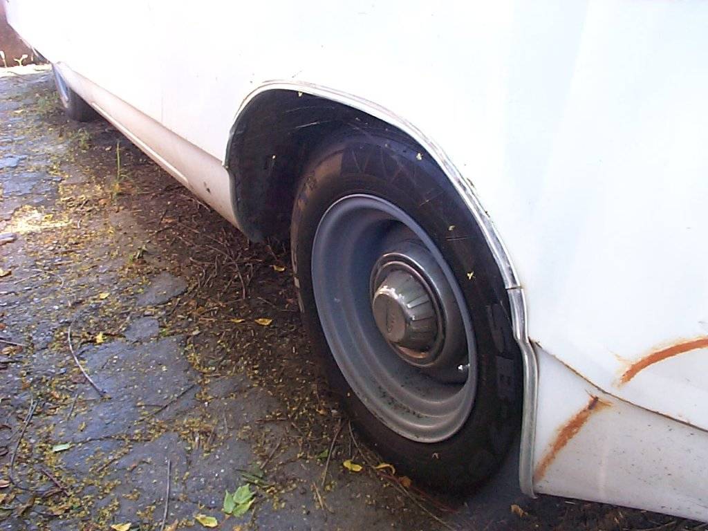

When I was running my '68 Custom Suburban as a daily driver back in the day, I was running 235/70/75/78 x 15 all the way around with the stock wheels.

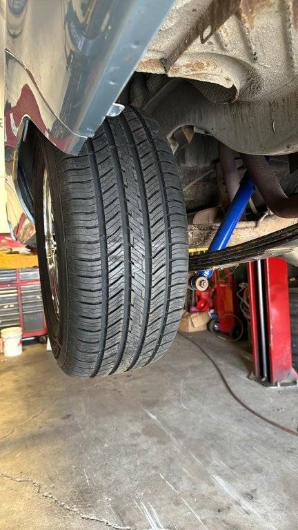

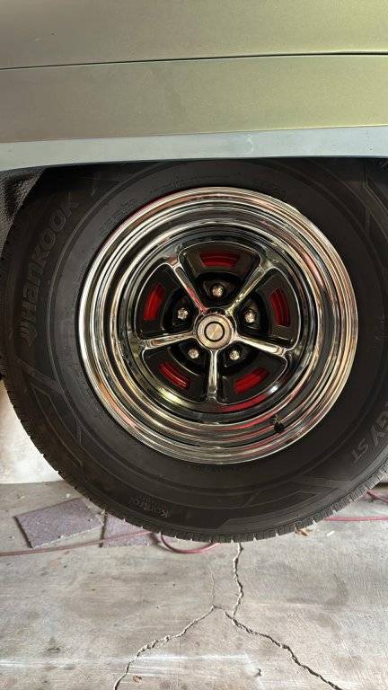

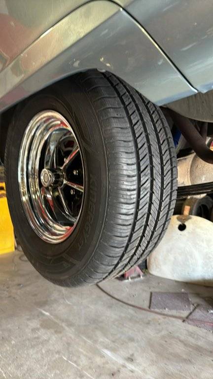

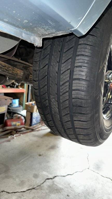

Here's what I run on my 67 300:
Wheel Vintiques 15x8 with 4" backspacing, painted body color (SKU 69-581204)
Hankook Kinergy ST - front 225/70R15 - rear 255/70R15
The fronts rub a little if I turn the wheel too sharp.
The rears fit fine with no issues, but the suspension has to droop all the way to get them on.
P.S. Your Newport is beautiful.

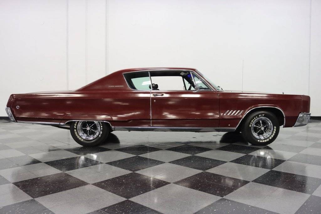

Personally I would run 15x7 in the front.
15x8 will work but as mentioned some rubbing on hard turning.
I run 23570r15 on 15x7 so I can rotate my tires.
Plus my size is 28 inches tall same as the factree 8.55-14 bias ply.

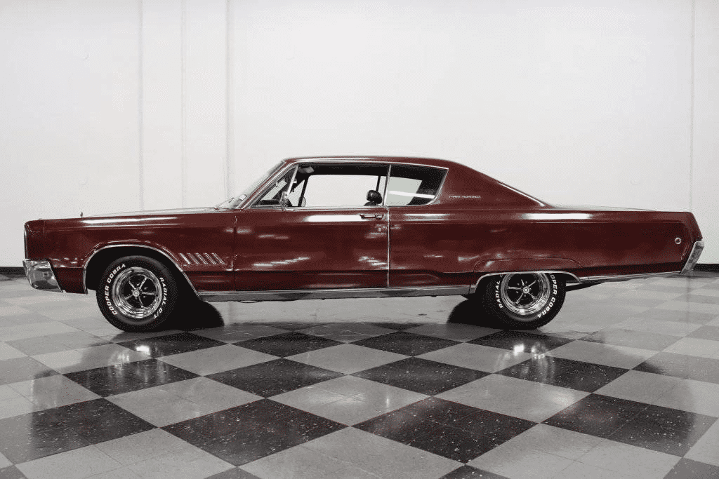

I ran 15x7 , 235/70-15 road wheels and cooper cobras all the way around on my 68 300. I liked it.
