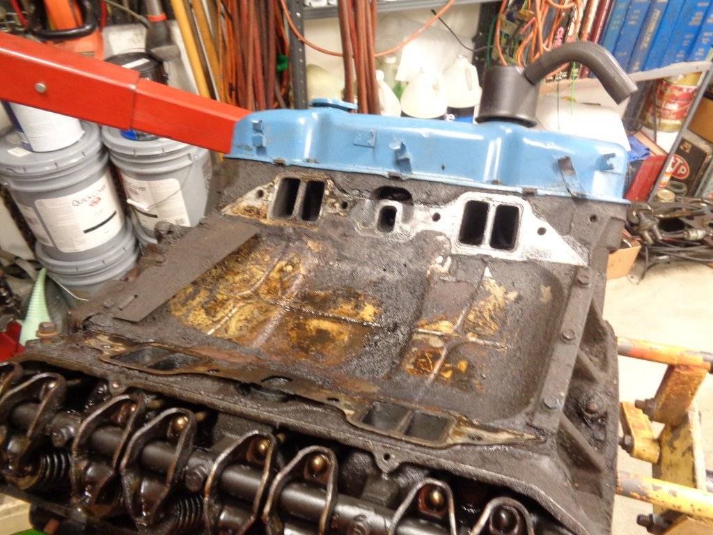

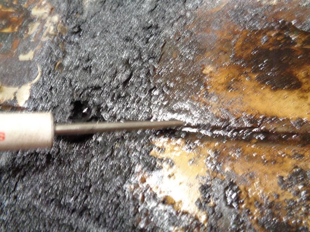

There is some interesting feedback on motor mods. The most obvious would be reestablish the deck height to pre -1970 standards w/ the appropriate replacement piston. A working compression of 9.5 to 1 would really give Buttercup a major kick in the pants feel w/ the right cam to retain its drivability. Now back to reality, Michel is seeking a OEM based repair, so that's the way we are going to go. During teardown the source of what caused the contamination origin was found. As you can see in the photos the intake gasket has three rust holes in it. These were cover up by the intake manifold assemb. The culprit causing the rust out was the insulation pad under the intake but laying on top of the intake gasket. See photos.
Other discoveries were due to the amount of crud run through the bearing a crankshaft will be turn down to .010 under on both main and connecting rod journals. All cyls. were free of heavy scratching from debris or the above crud circulated through the lubrication system.
After I saw my first valley pan with rust holes in it many years ago, replacing this part became one of the first repairs I did on any bigblock car I brought home.
Given the opportunity, rodents love to make nests around the rear side of the intake, and their urine will eat thru that pan over time.
This is the second instance I have seen on FCBO of an in-use engine having holes in the valley pan.
I don't know how many folks will find this comment, but... The valley pan should be considered a mandatory inspection/repair on any bigblock (along with the timing chain).

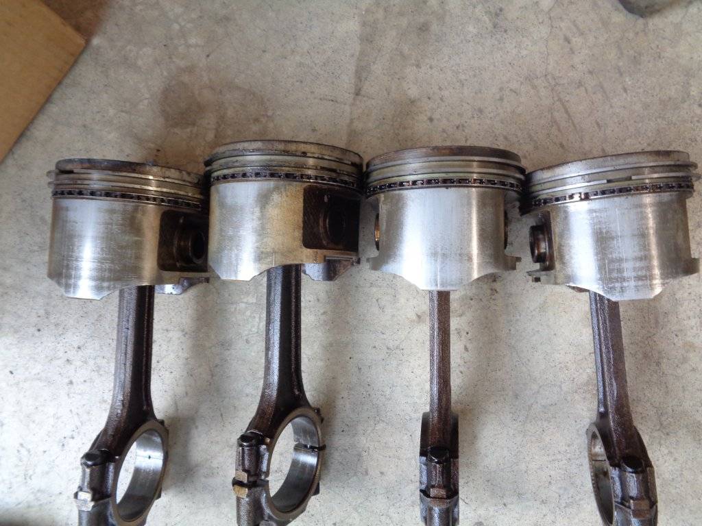

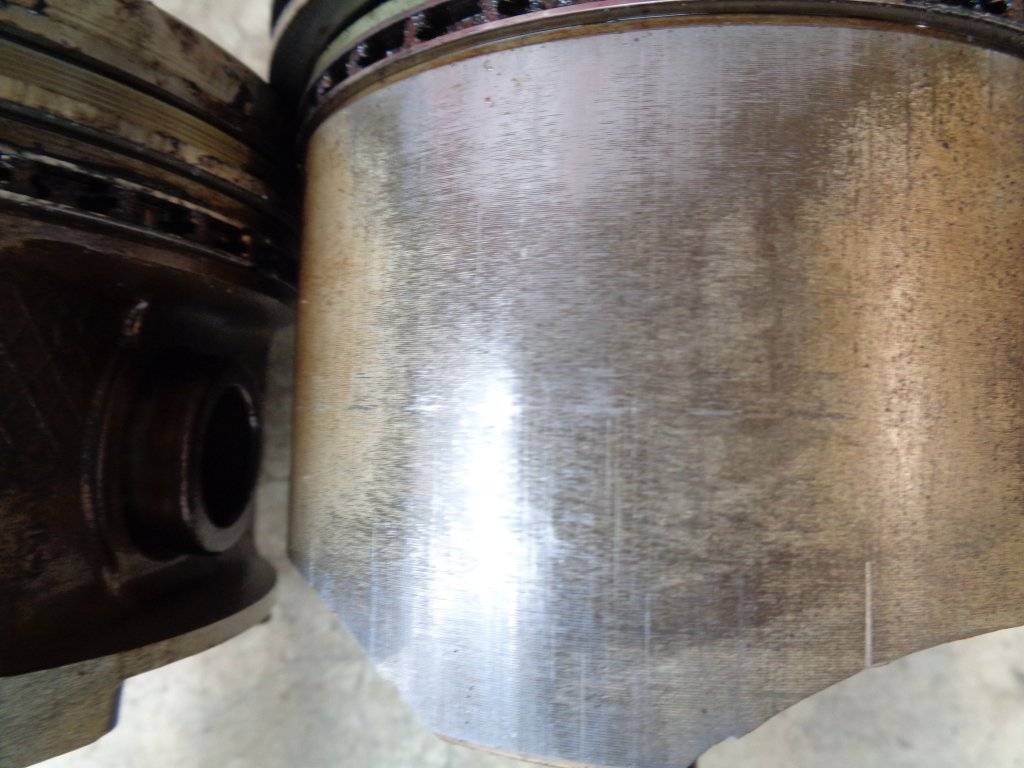

After many weeks of procuring the parts needed, I am finally able to proceed w/ the 72 New Yorker rebuild. After a thorough measurement of the Crankshaft and engine block I determined that a 0.030 over bore was needed to cleanup cyl. wall wear present. If you look at the photos below the piston skirt wear was present in the center portion of the skirt only. This is mainly caused by not allowing the piston to fully warm up. The usual causes are too cool of a thermostat used. I have found this before in many applications where an overheating / oil pressure issue is present. The piston skirt is not allowed full exspansion and heavy wear of the center of the skirt is the result.

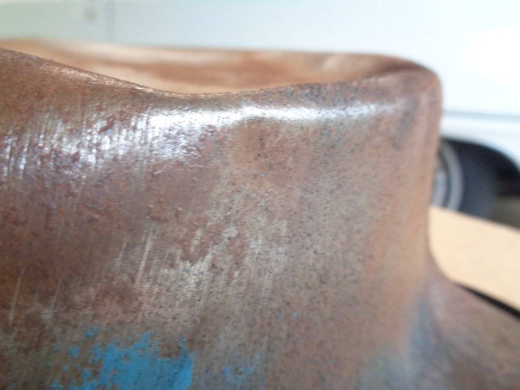

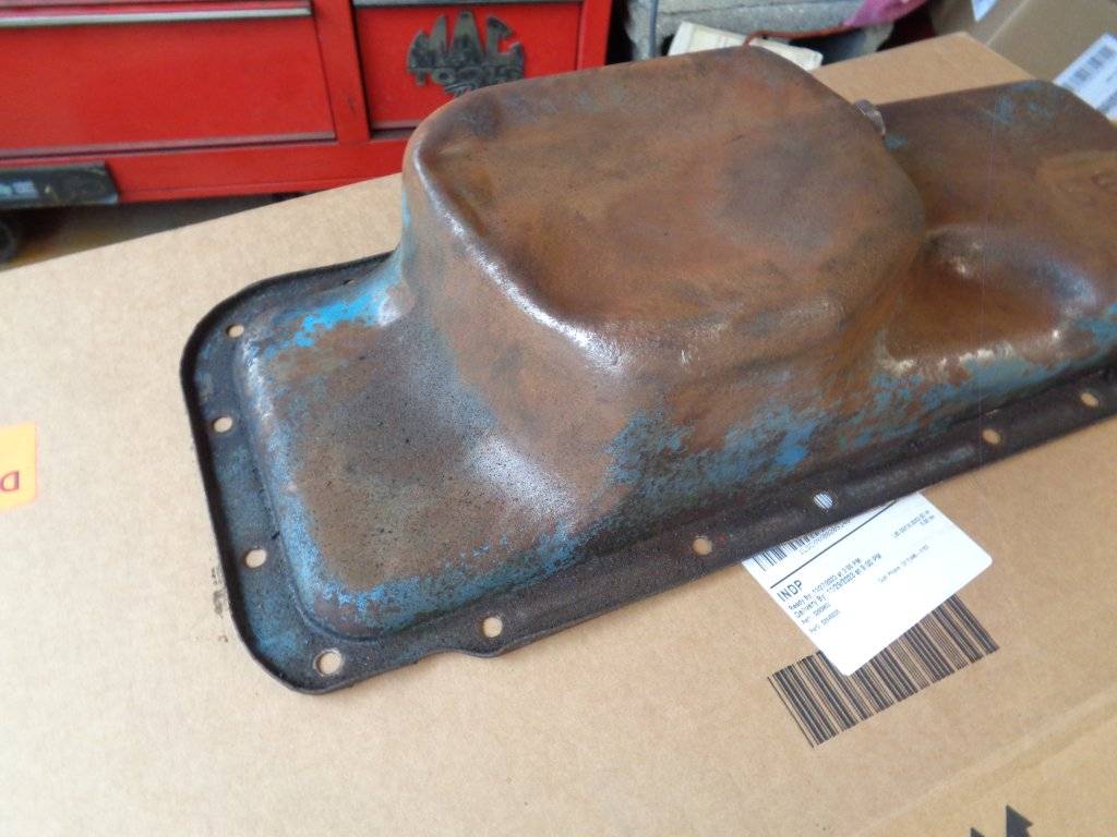

The crankshaft measurement revealed little wear on the main and rod journals. A good micro polish restored it to near perfection. The oil pump on the other hand was junk. a victim of all the rust and dirt run through it. Another area affected was the camshaft, cam bearings. Most notably the wear on the cam bearing journals, which rarely show wear and the cam bearings themselves. Note the amount of bearing material present in the oil pan in the photo below. Also note the pan condition as it was pushed in about 1/4 or an inch. Some blacksmith work brought it back original shape. Refer to the photos in post#369

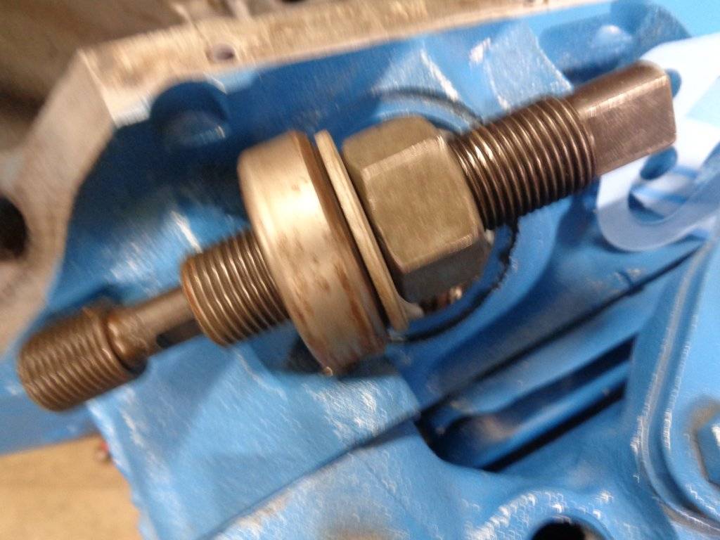

Another part of engine reassembly is correct install of the vibration dampner. Never install w/ a hammer and a block of wood as thrust bearing, dampner or crank damage can. result. Use the tools as seen below.
