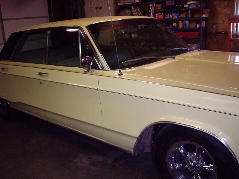

003.jpg004.jpg005.jpg006.jpg007.jpg008.jpg:os_dancing2:Hi I'm a new member car and motorcycle lover. Bought mopars new in the 60's. Owned 2 62 Plymouths in the day 66 coronet that I traded for a new 69 roadrunner and in 1970 traded the roadrunner for a 6 pack superbee. Boy I wish I had those cars back. Presantly I'm the proud owner of a 67 Chrysler new Yorker. Rust free with 65thousand original miles 4door hardtop. I am very excited to be a part of the mopar community. Atlas

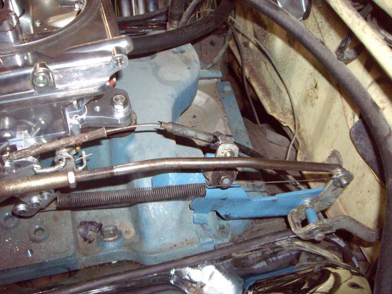

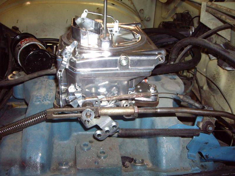

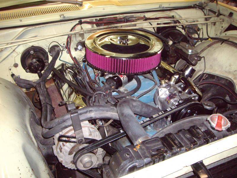

Just switched out the edelbrock 750 carb for the new 625 street Demon. The eddy seemed sluggish. This new Demon is very responsive and the engine seems to love it. Hooking up up the throttle linkage was a pain but worth it. I'll let everyone know if any problems arise.

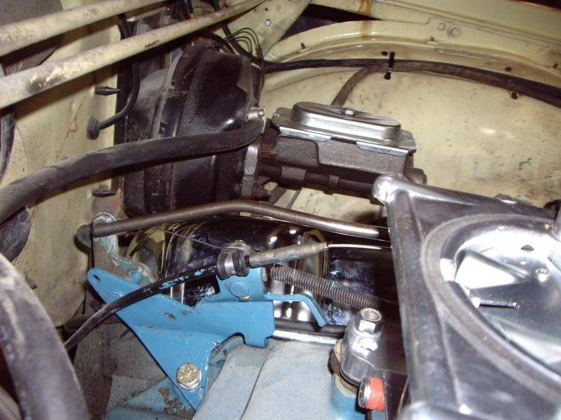

Had to add to the existing mopar bracket to raise and move the cable to the right to get past the carb linkage then readjust the kickdown linkage. Small piece of steel bent with two 1/4 inch holes and a cable clamp.005.jpg006.jpg
You mounted the bracket wrong. And I'm nervous about that sharp bend in the cable. For several valid reasons.
