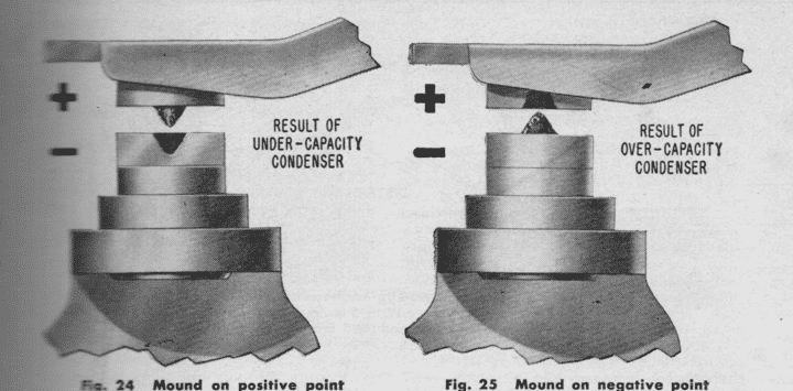

I have heard that the ballast resistor is there to keep the coil from overheating and/or to lengthen the life of the points by reducing arcing and pitting of the contacts. Either of those sounds reasonable, however if the resistor is there to protect the points, why did Chrysler keep it when they went to the electronic box in the '70s. If it is to protect the coil, why does Pertronix suggest that you don't need it. Specifically, their instructions say the resistor isn't needed if the coil is at least 1.5 ohms and the FSM says the stock coil is 1.65-1.79 ohms. After decades in business, I don't doubt that Pertronix knows what they are talking about, but it seems odd. Perhaps Chrysler just wanted a larger margin of error?
