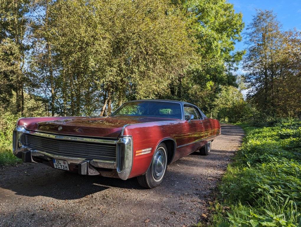

well well good things take time I guess. I joined the fcbo board back in 2015 after a local car show where I came across a 70 300. That enormous size, two doors and hidden headlights got me. I didn´t know much about those big boats but soon I learned that there´s a die hard community and I must say this board is one of the nicest, most knowledgeable and most helpful car forum I´ve ever been to. It didn´t take long to learn more about these cars and I found my favorite of the all was the 1970 Sport Fury. 2nd best the 72/73 Imperial. Way different, focussed on luxury but man what a front end that is. In fact I like it even more than the 70 Sport Fury. BUT I´m picky about colors and trim more than about engine specs. So anybody got a 70 Sport Fury in FK3 burnt orange with PH23 roofline, no vinyl top and orange/black interior for sale? Of course not and even after expanding to different colors .. nothing. Well what about 72/73 Imperials that are not brown/gold/green/white/black..? Took me 5 years to find a red 73 Imperial in great condition but the owner was not really willing to part with it. In fact he contacted me on a classified because I more or less described his car and he was curious. Over the years it´s fair to say we became friends, he collects Imperials and owns / owned almost every model from 1959 up to 73 plus 81-83 cars as well. Finally this spring he let it go ( probably tired of me constantly begging :poke: )

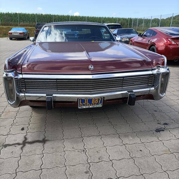

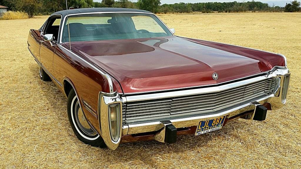

Now to the car. Many Imperial fans will know this picture since it shows quite fast in the Google picture search
yes it is THIS car (check the license plate if in doubt) these pictures in the dry field were taken 2012ish. And it´s a perfect sibling to @DocMcNeedy / @Moseman 1972 Lil Red.

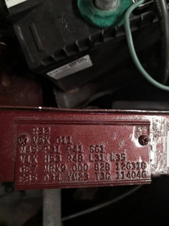

Scheduled production date on the fender tag is 8/28/1972 so quite an early car. It is nicely optioned with H53 AutoTempII, leather bucket seats, tilt telescope steering wheel and 5 speaker radio.

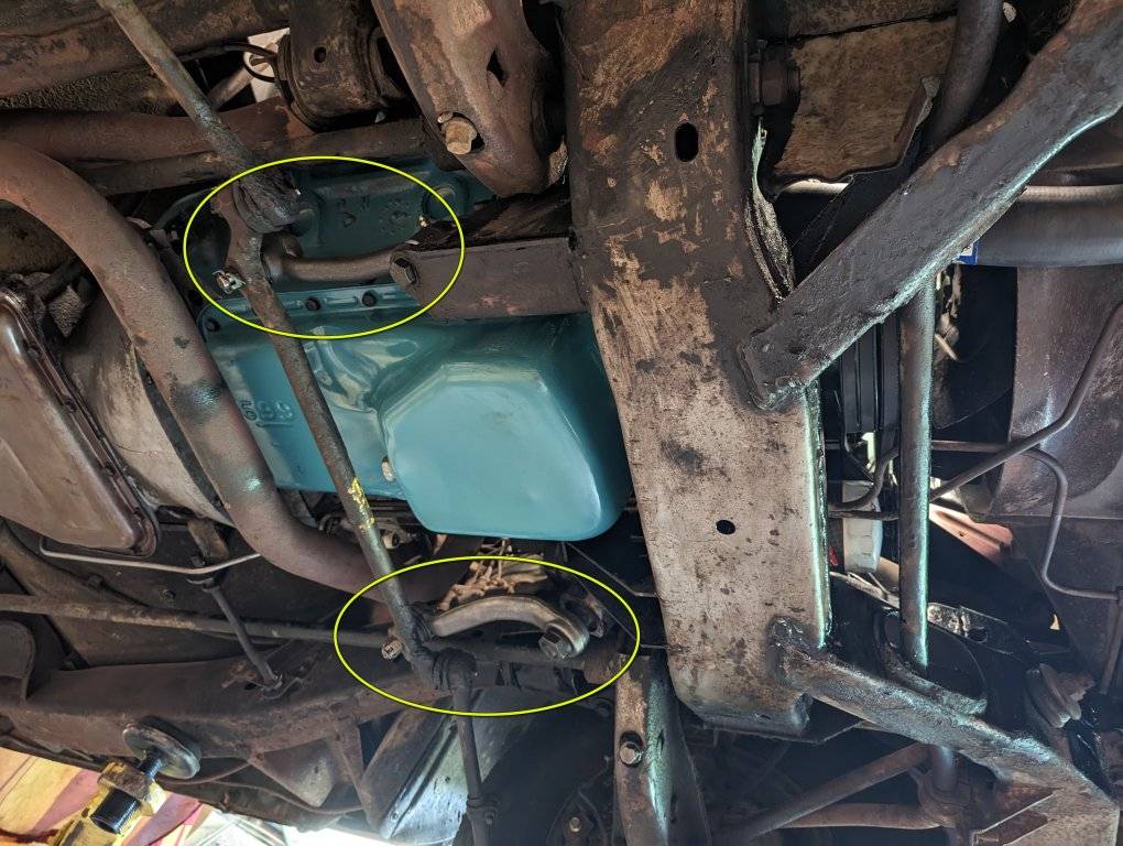

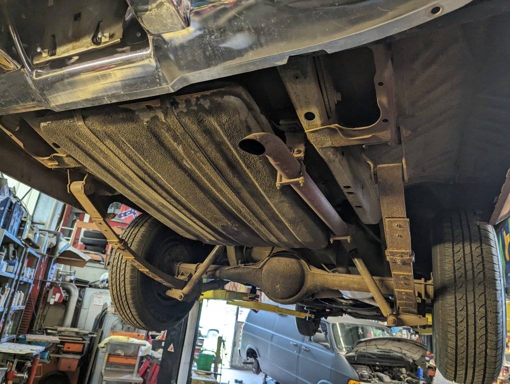

Touchdown in Germany. Now what´s on the to do list? Unfortunately freeze plugs are leaky and that is an engine out job. I knew that before I bought it and I´m willing to go that way in order to make the car perfect. Now after first inspection from underneath idler arm and pitman arm are shot, not only bushings but also the ball joints. The steering linkage is Imperial only and the idler arm is made out of unobtainium but fcbo community strikes again, thanks to @vdk2010 @Boydsdodge and @saforwardlook I´m pretty confident that there will be a solution to this issue.

Congratulations @Marv -- look forward to seeing more of the car. If you feel like posting the fender tag, you know that I'll enjoy reading it :)

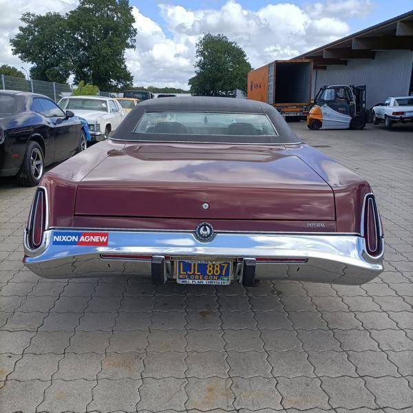

Thank you man. You know that the road to this car was very long. But in the end my patience paid off. I ended up with my dream car so it was a good thing to dodge those opportunities that I wasn't 100% convinced with.

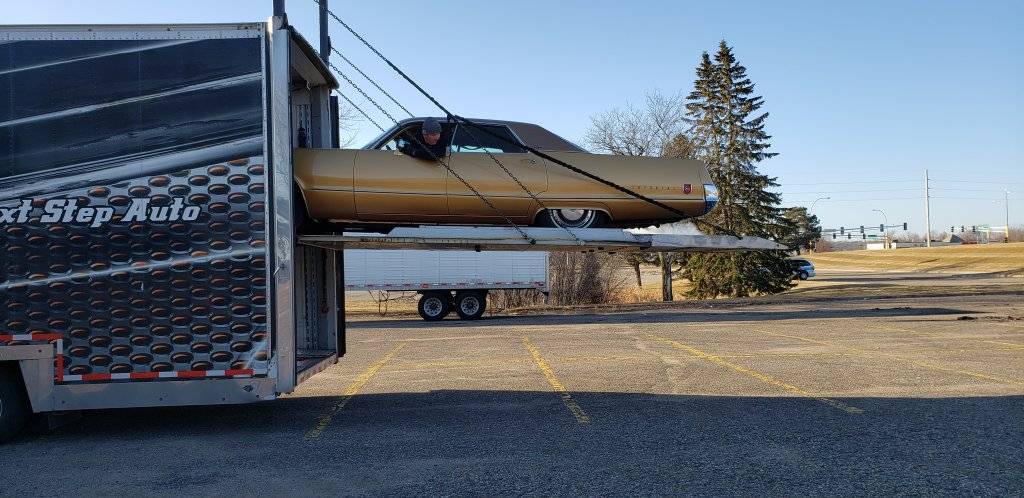

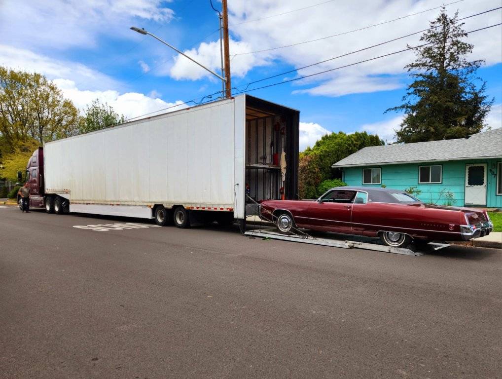

I love this picture. From this angle the Imperial looks even more enormous
and this one still scares the crap out of me. I also have a video of the ramp lifting up.. it shakes like crazy with the Imperial bouncing on top. If I would have been there I sure suffered a heart attack
@ayilar here you go
Congratulations on this beautiful Imperial!
I wish you the best of luck that your dream car will soon be ready for the Autobahn...

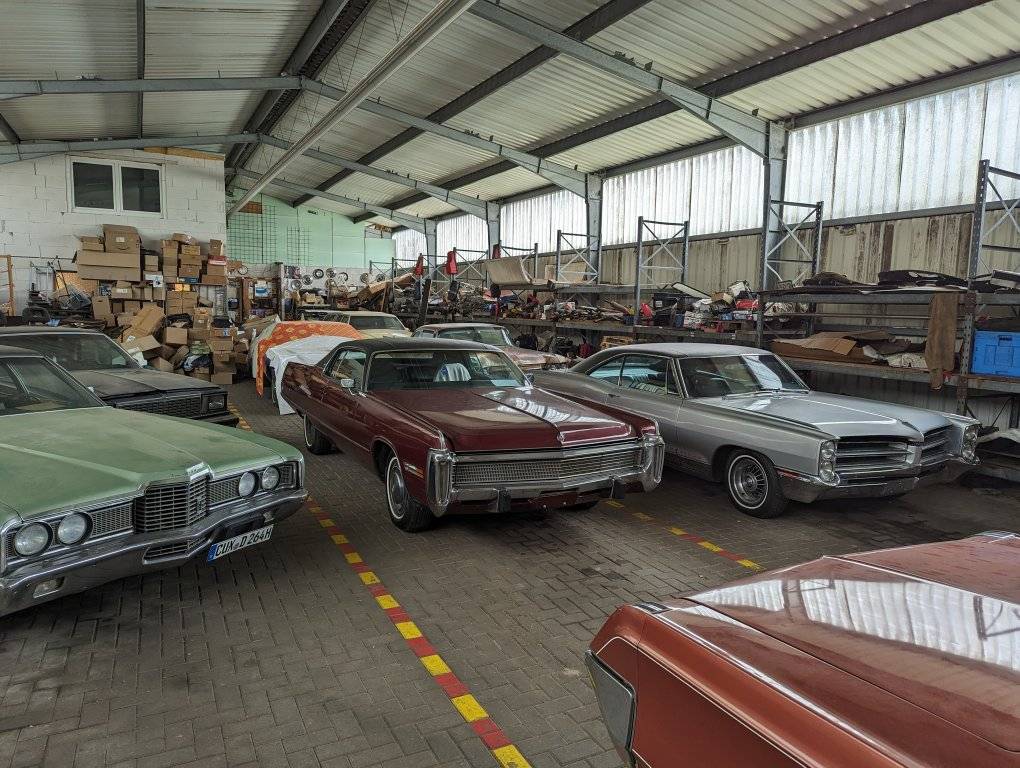

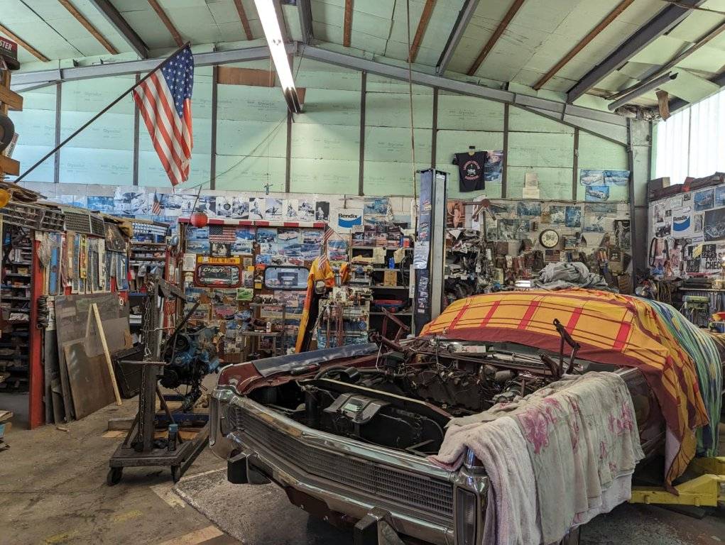

The big three, Ford LTD, Imperial and Pontiac Bonneville sitting next to each other in the shop. The Imperial is next in line, next week the engine will be pulled for new freeze plugs. I´m curious what will come up in that process. Once it´s out we´ll fix everything that comes in our way since many parts are very hard to reach when the engine is back in the car. Fingers crossed that it doesn´t get outta hand and ends up in a full blown engine rebuild :lol:

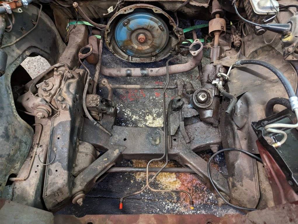

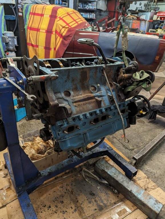

Here we go engine is out. Quite a task, maneuvering space is extremely limited plus the engine is located wayyy back there. So disconnecting it from the transmission first then move all those a/c, emission and whatnot hoses out the way. The cherry picker needed some adjustment ...meaning even on the most "extended" position it was still too short, so a longer metal post was needed and then two guys standing on the hoist so it wouldn´t flip over and crash into the bumper..:lol: But if there´s a will there´s a way :elmer:

yup it is well preserved / coated :lol: several oil leaks that need attention

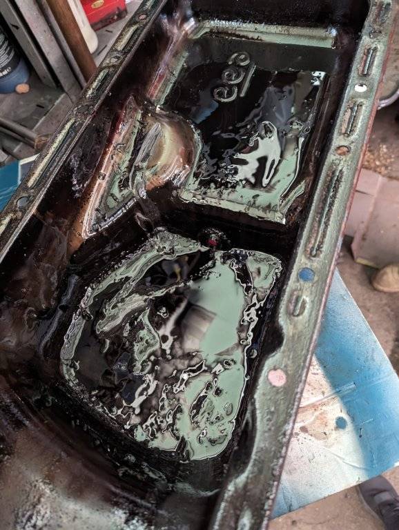

half an inch of slushy oil mud in the oil pan. It was never off the car in 50 years...
oh yes these freeze plugs were ready to ruin my day. Leaking and thin as paper

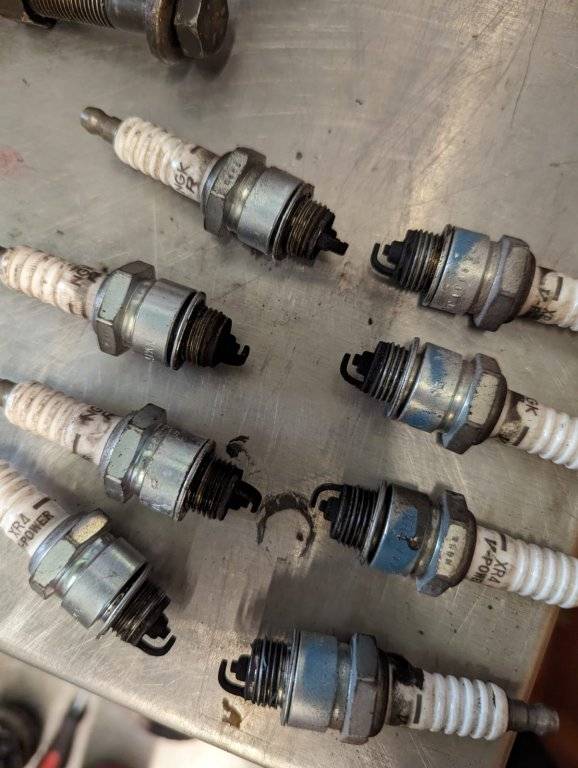

and another thing.. these spark plugs have seen 300ish miles in their life. The engine seems to be running richer than Oprah you might think now... Wrong, it´s NEVER been driven in the past 10 years, just started up twice a year or so sitting 20 minutes in the drive way idling. They are autoMOBILES, not auto-sitting-until-the-tires-flatspot, if you don´t drive them they will deteriorate.

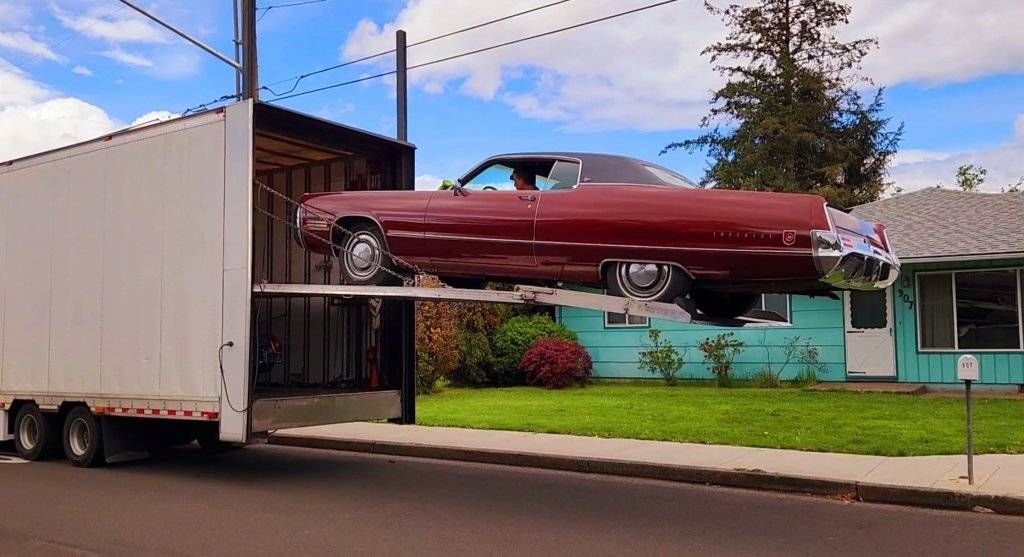

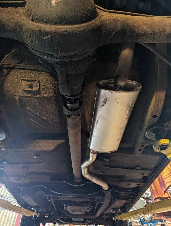

Engine is back in and running. Runs really well no black smoke or anything like that from the exhaust. I like that it´s still single exhaust and the muffler is new and quiet. It´s a decent 440cid rumble but in an appropriate Imperial manner. Nowhere near a noisy lopey muscle car, just perfect. It is incredibly clean from underneath no signs of rust, not even a tiny bubble at the lower quarter edges. Now the engine started up and idles pretty smooth, we let it sit and get hot to the if it´s sealed fine and the radiator is doing its thing aaaaand the power steering pump started to leak. So does the o-ring in the steering box so steering fluid all over the place. Maybe it was leaking before but it was not visible since the engine was leaking all around from valve covers and oil pan and the stubframe was completely covered in grease. Would have been an easier job while the engine was out but that´s life. The service manual says the whole steering column needs to be pulled back 2 inches to get to the o-ring... We´ll see if that´s the case, eyes on the price, we´re getting there
I found an Imperial specific pitman arm at P-S-T.com. Great customer service, great communication 5 stars!
The idler arm has never been reproduced and there are none. Only way to go is send in your old core to rareparts and have it remanufactured. OR use the New Yorker idler arm like @Boydsdodge showed in his Imperial idler arm vs 73 New Yorker idler arm thread MOOG parts no K7014. Since apparently these parts are shot on almost every of these heavy barges and we Germans have to pass a thorough safety inspection that´s the option Imperial owners like @vdk2010 and @Joerg chose. To sum up all the discussions that you can find across the internet about the New Yorker idler arm fitting the Imperial or not: YES IT DOES. Almost the same shape, distances are veeery close, fits easy, clearance to oil pan is good, yes the alignment is still good.

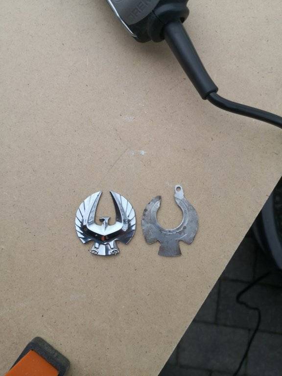

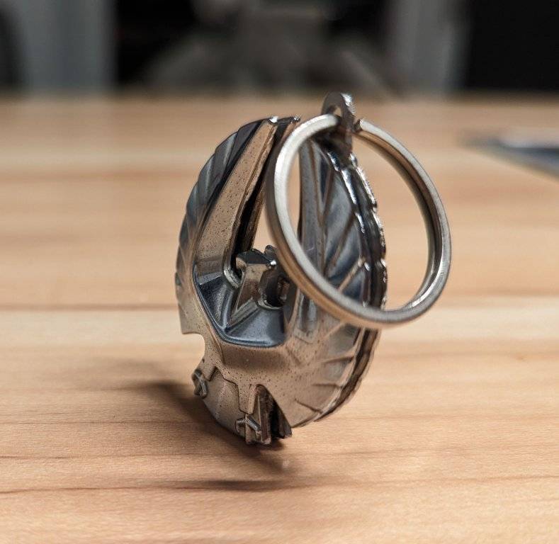

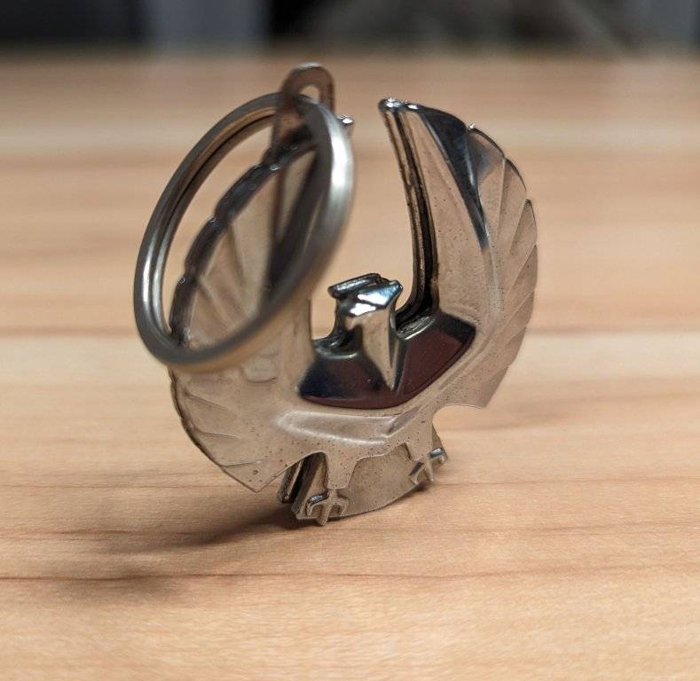

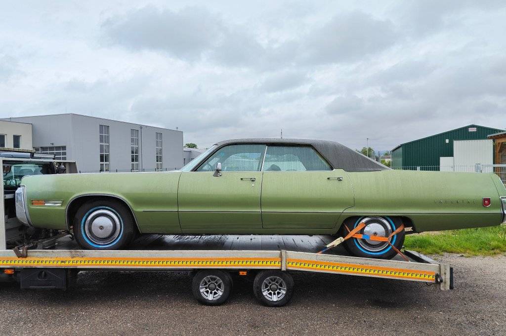

The car has finally passed the TÜV inspection and registration at the DMV is also done. As soon as the weather stays dry I'll finally get the Imperial home... I'm hyped. Had some nice spare emblems and made me a nice keychain
Picked the car up today and I'm amazed. This car is so quiet, I barely hear the engine idle at a traffic light. It runs over bumps like a Rolls Royce, took it to the Autobahn right away.. it takes a while until you reach 75mph, that low compression 440 has it's hands full with 5300+ lbs. The electric seats work perfect and are super comfortable, the cruise control works and is s neat feature. What a great cruiser that is.
