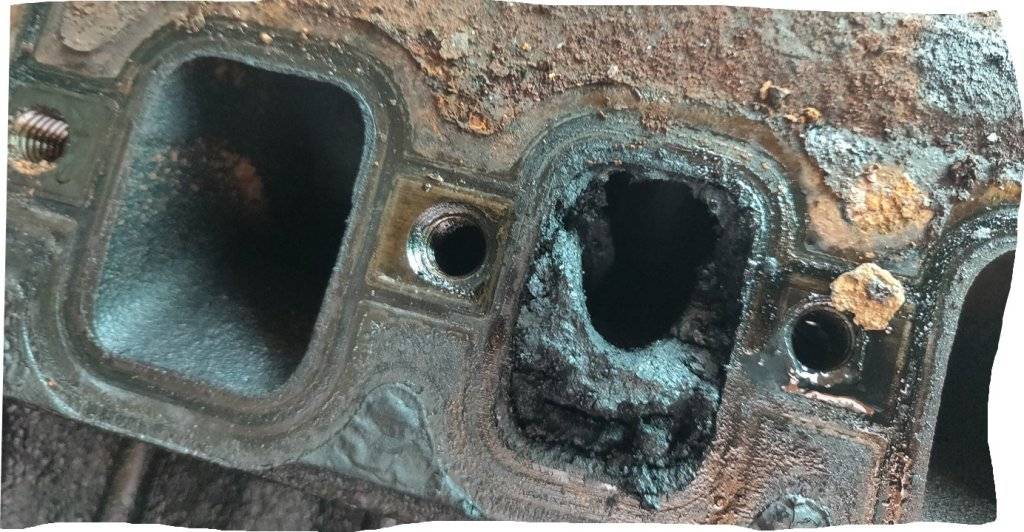

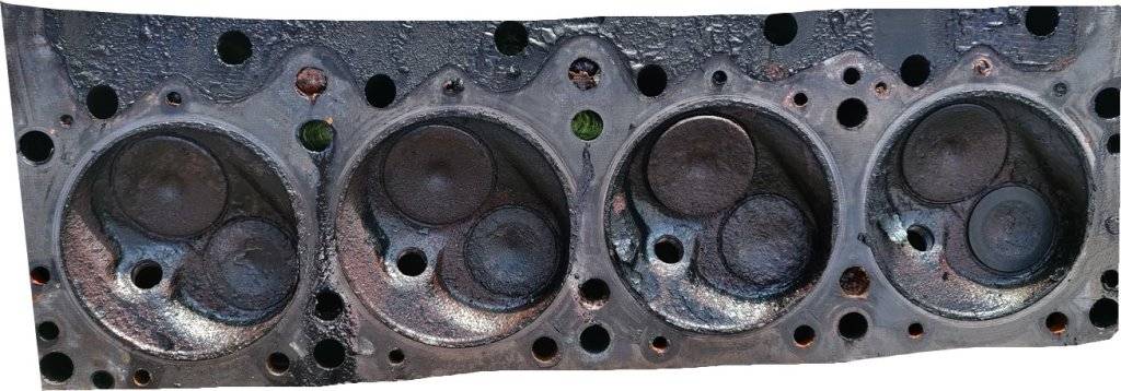

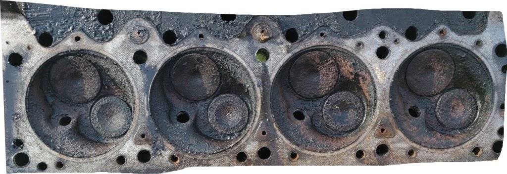

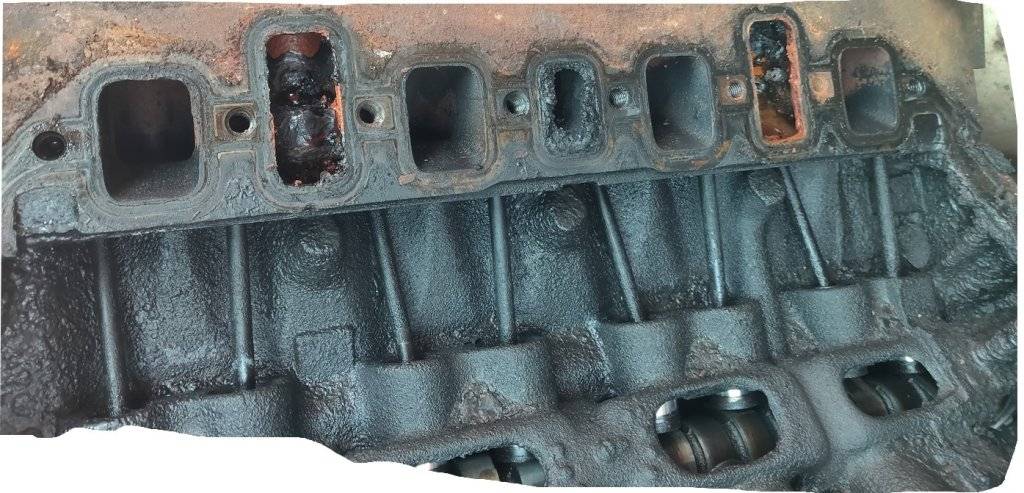

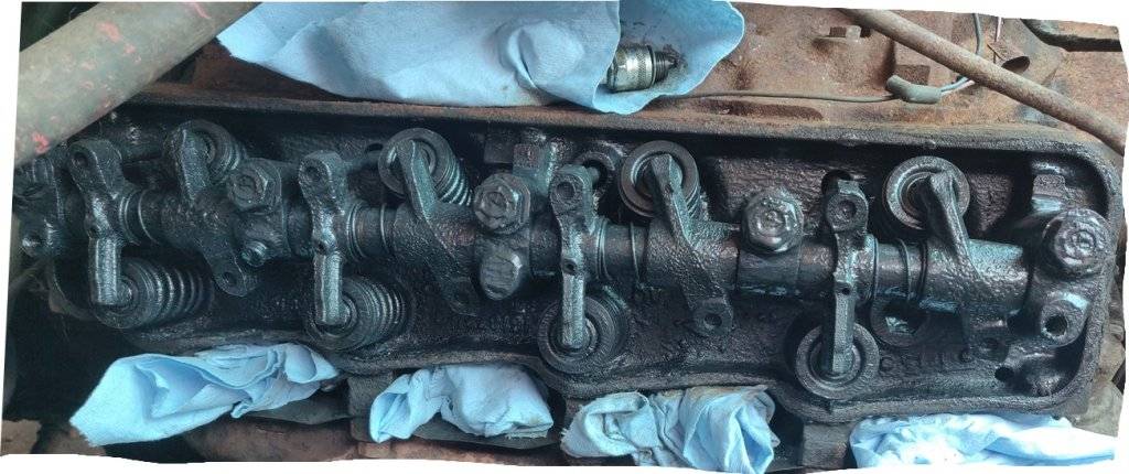

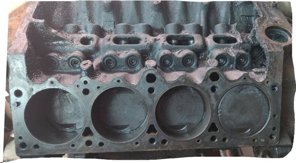

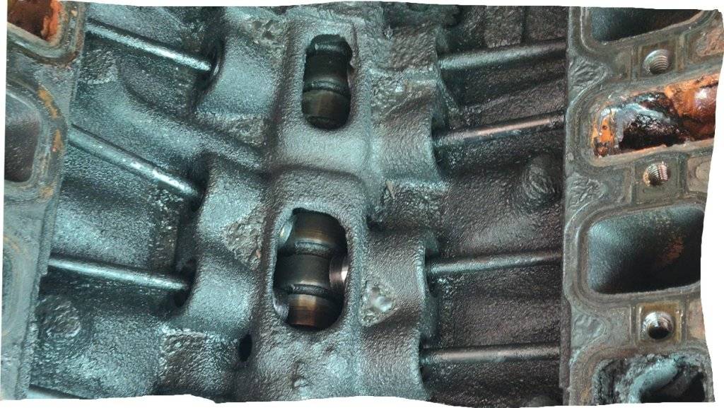

Today I removed the valve covers. Top end looks pretty dirty...not sure how often the oil was changed...but the car has been sitting for 48 years. I used a mallet to bang the valves and all moved/were free. I was also able to rotate all of the push rods. So I feel like the valve train is not the sticking issue. I also removed the starter to rule that out. The accessories are also unhooked and all move freely. I filled all the cylinders with a 50/50 mixture of diesel fuel and ATF. Also poured some into the valve train. Will keep my fingers crossed the engine breaks free.

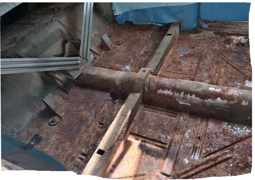

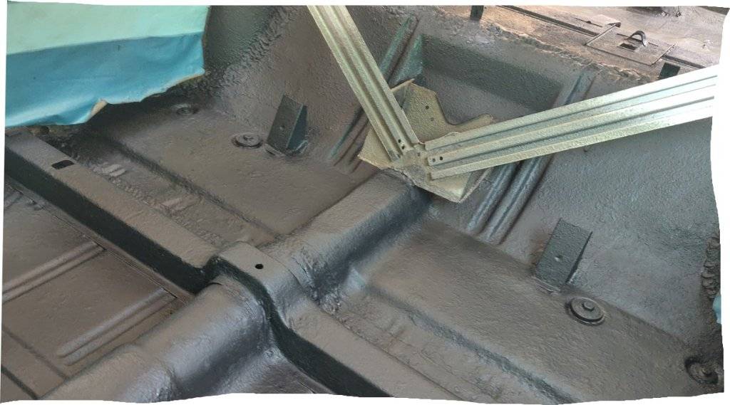

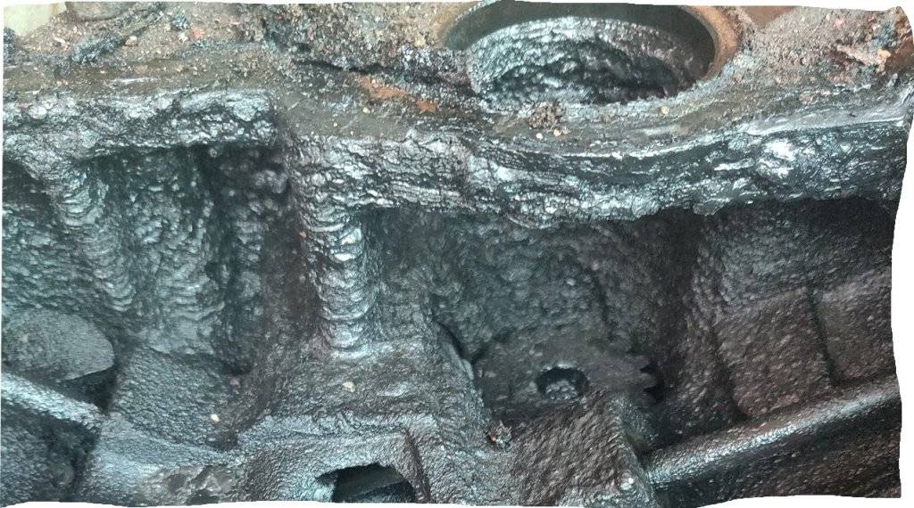

Good morning everyone. I hope you have a wonderful Memorial Day weekend. Yesterday I added more diesel/ATF fluid mixture to the cylinders and top end. I did notice that several of the cylinders had completely drained all of the fluid out so that's good news that those rings are breaking free. I've also got a big breaker bar on the crank bolt under pressure to help. I'm taking my time as it's only been 2 days of soaking the engine. Will probably try to paint the floor and trunk this weekend and reinstall the interior. At least that will make it feel like progress is being made. I also bought a new master cylinder, brake lines, bearings and wheel cylinders so will get the manual brakes up and working. Step by step it gets better and better!!!

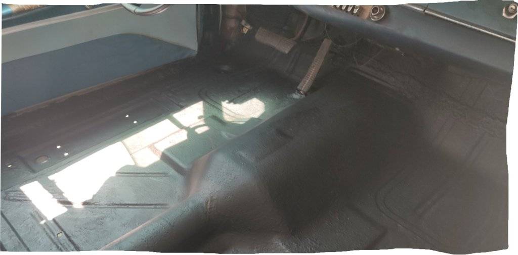

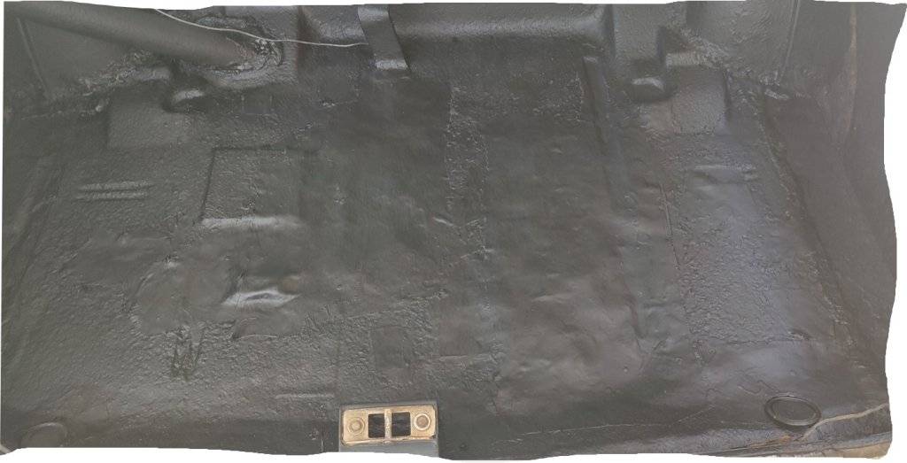

The weekend was busy. Got the interior floor finished and painted. Also did some temporary patch work on the trunk and got that painted (I know it's not the best but just wanted something to keep any fury critters out for now until I can do a better job at a later date). Need to install the interior next.
The engine is still stuck...but one thing that has me confused....if I use a prybar on the flex plate teeth from under the engine and try to rotate the engine counter clockwise the flex plate AND crank pulley will rotate counter clockwise about a 1/2 inch....BUT ONLY if someone is pushing on a breaker bar (on the crank bolt) and going CLOCKWISE. Makes no sense to me. If no one pushes on the breaker bar, I can't move the flex plate at all. If someone pushes on the breaker bar in the SAME direction as I'm prying the flex plate...nothing happens. Can't wrap my head around the fact that 2 opposite direction forces get the crank to move. Any ideas???

the crank bolt is probably tightening like it normally would when turned clockwise.

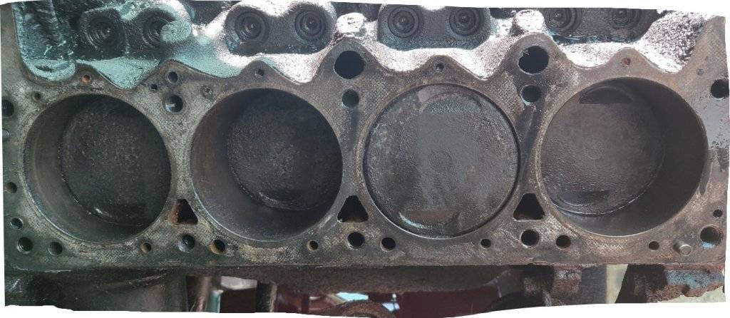

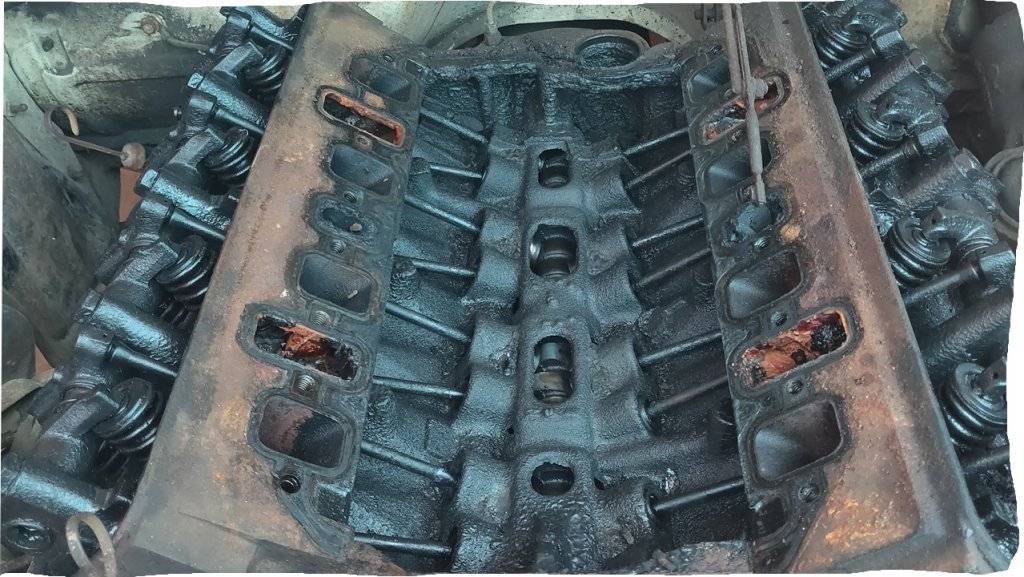

Just an update for everyone. I got my new borescope and inspected the cylinders. They are rusty as expected...so are the valves. However, they were not as rusty as I expected... given it has sat for 48 years with no plugs in it. However, I can see a few small piles of what I would imagine is diesel/ATF soaked piles of rust by the piston head/cylinder wall. Wish I had blown out the cylinders prior to soaking them....well, lesson learned for next time. I've also tried more prying of the flywheel and using a 3/4" breaker bar on the crank (hitting the breaker bar with a 3lb sledge)...but nothing has moved. I'm starting to realize it might be time to pull the intake/heads. But...I may try a mixture of 50/50 acetone and ATF....what have I got to lose at this point!!!
If there's that much crud in there even if you do break it loose the heads are going to have to come off to vacuum up the junk.
I'm guessing you're going to be breaking the pistons out of it to get to the rings
