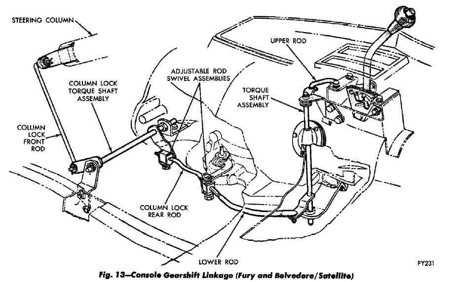

If its convenient. would anybody have any pictures of the linkage under the hump from the console above to the transmission? I have taken two c-bodies apart long ago and having trouble matching the parts to . Thanks much.
Shawn P.
Don't know if the linkage is the same for '68, but here is what my '70 440 has. The link to the steering column is probably not used since column lock only appeared in 1970.
