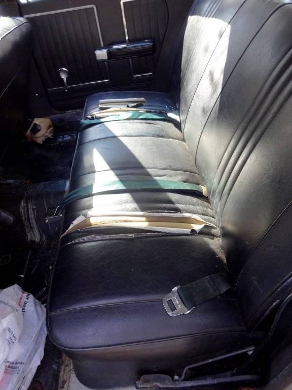

Good thing I don't need it! Just the drivers seat seat portion has separated seams on the inserts.
Could an upholsterer resew it onto a backing cloth and reinstall it?
No, you will need new material to replace that insert and a Upholster to do it right. Anything less will look like an ametuer did it.

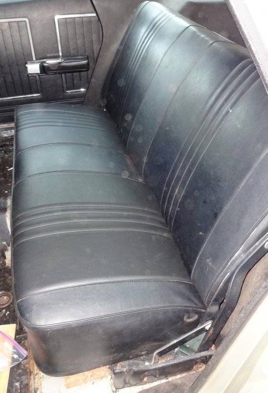

This is my rear seat, before and after. My trimmer removed and disassembled the lower cushion, stiched new inserts into the original bolsters with exact material he had in stock.
SMS offers great product but they are hot/cold on service, you pay upfront and it can take a year plus to get your stuff.View attachment 110609 View attachment 110610
If your seats are all vinyl then a good trimmer can locate matching material and either repair or duplicate your seat covers.
