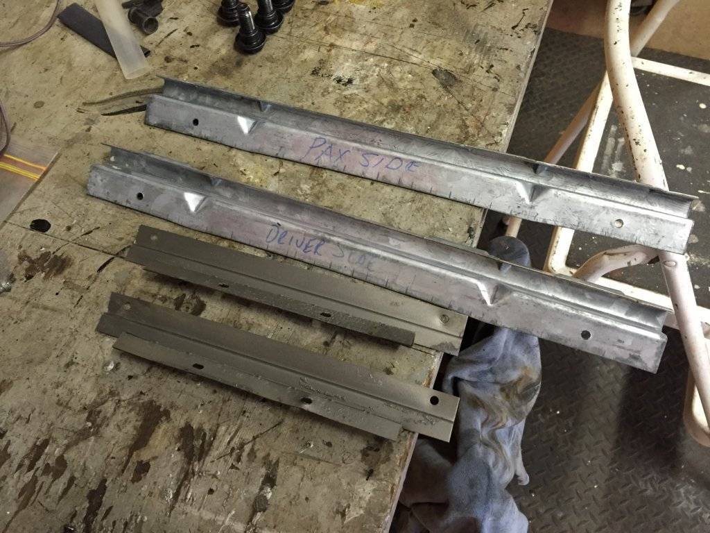

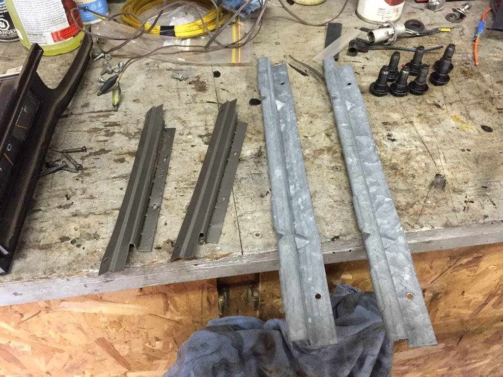

well after over a year of being apart I have 4 brackets or guides or tracks that I can't identify
They go in the interior somewhere in my Polara convertible but I have no photos to reference....
Can anyone help a c body brother out?:lol:

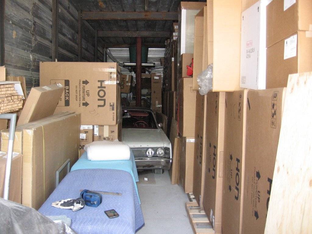

I can get pics later if need be, my parts convertible is a little buried in my warehouse.

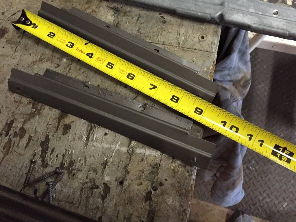

Thanks I would appreciate this very much!
at least for the one bracket. the smaller one is still a bit of a mystery.

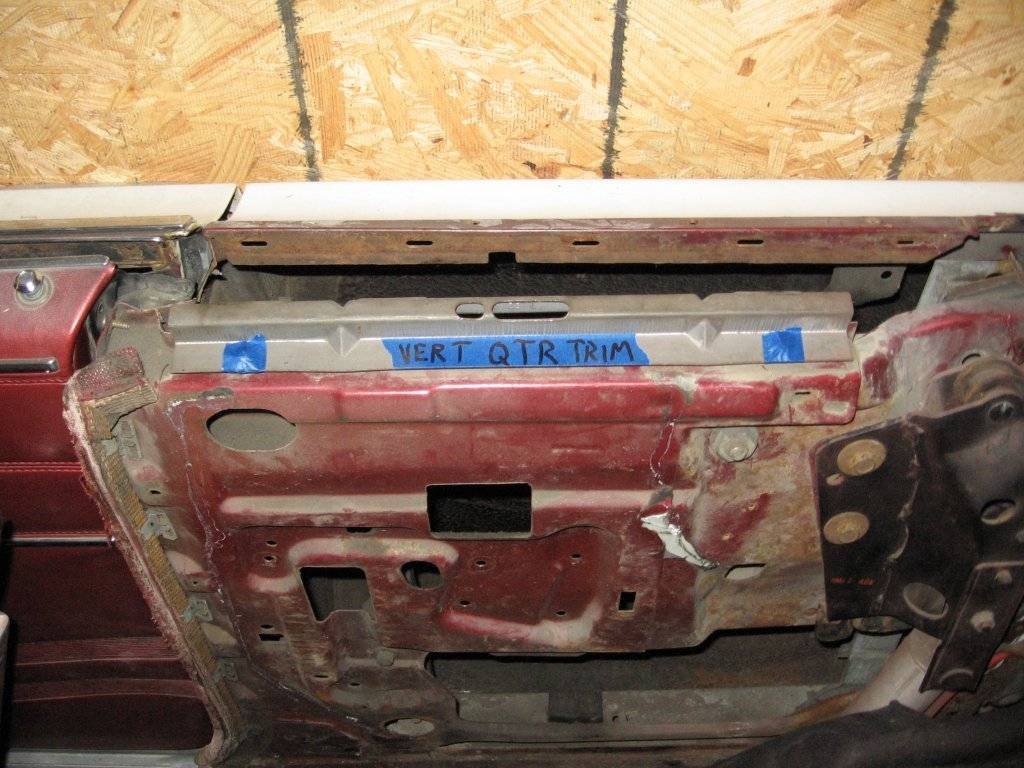

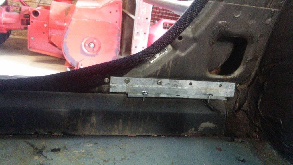

Here's your pics.
The longer bracket on the passenger's side:
The shorter bracket goes below almost to the floor:

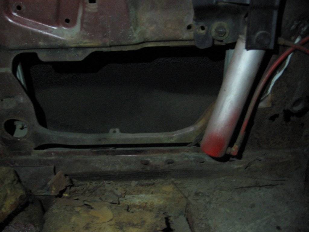

There's not much left of this car, so this pic probably isn't very helpful. But the dark marks in front of the top cylinder are the holes for the shorter bracket.

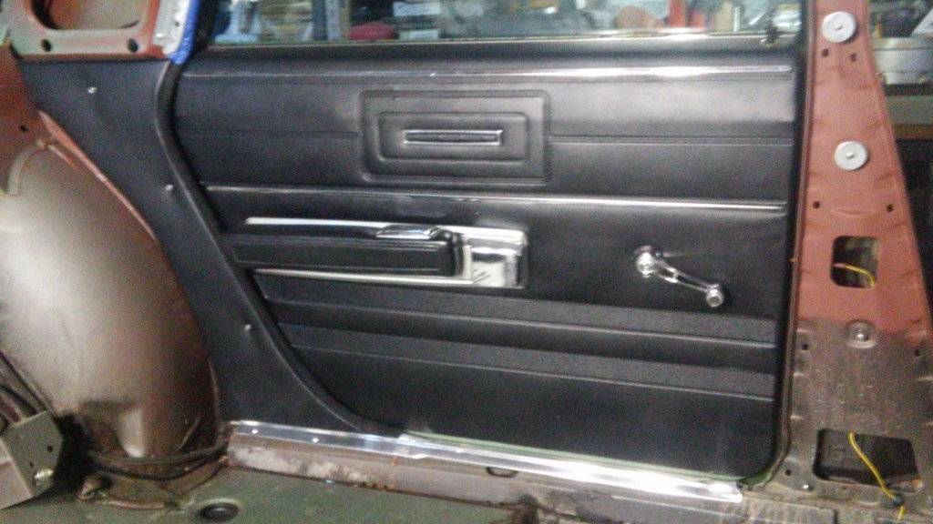

But, this is a pic of the same type of bracket from the passenger's side of my 4DSD:
The bottom edge of the quarter trim comes down to the bottom edge of the bracket behind the two vertical screws. Then the sill trim extension mounts where the screws are.
And here is the driver's side with all trim installed:
Obviously the convertible parts are shaped differently, but the overall idea is identical.
And no, my hobby does not interfere with my business:

They did. Thanks very much! I got the top ones figured out but didn't get the bottom one's installed yet.
Thanks for your efforts here!
I appreciate the help.
