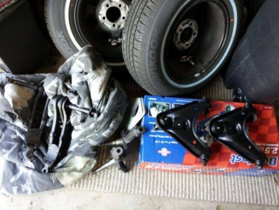

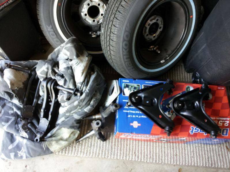

arms-and-parts.jpg heres a pile of stuff just waitin on me to put back on the car. . .
is there a L and a R spindle on drum cars? or can a spindle go on either side?
i figured out what arms go where, but the spindles look the same...
haallp!
thanks!
- saylor
The only difference is when the wheel cylinders are still mounted with the drum brake parts. Then the spindle with the bleeder screw that faces toward the rear of the car is the orientation. Since yours were striped and have disc there not side specific.
