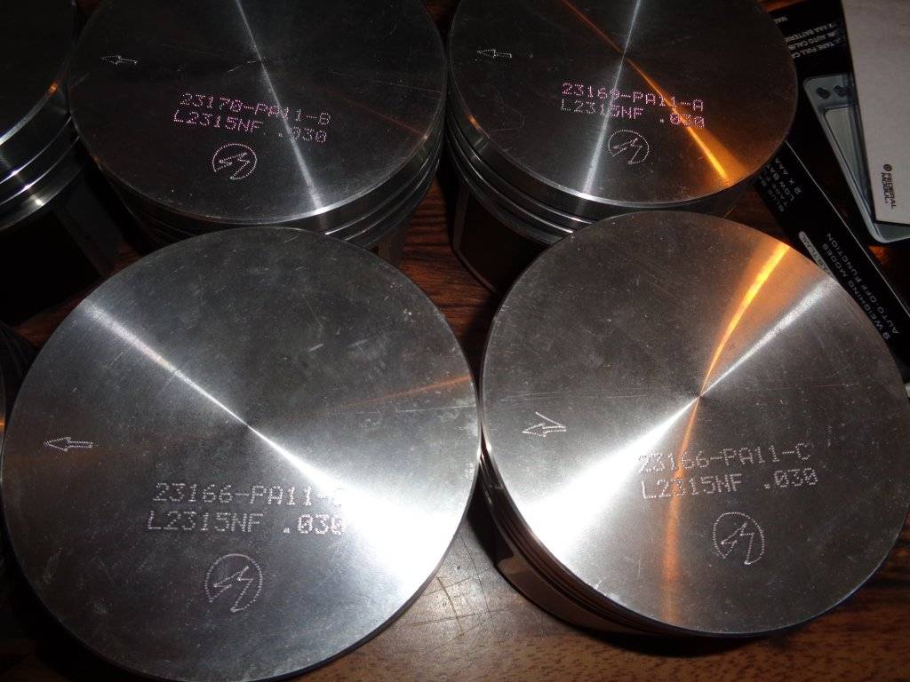

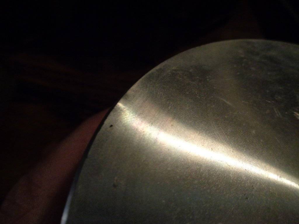

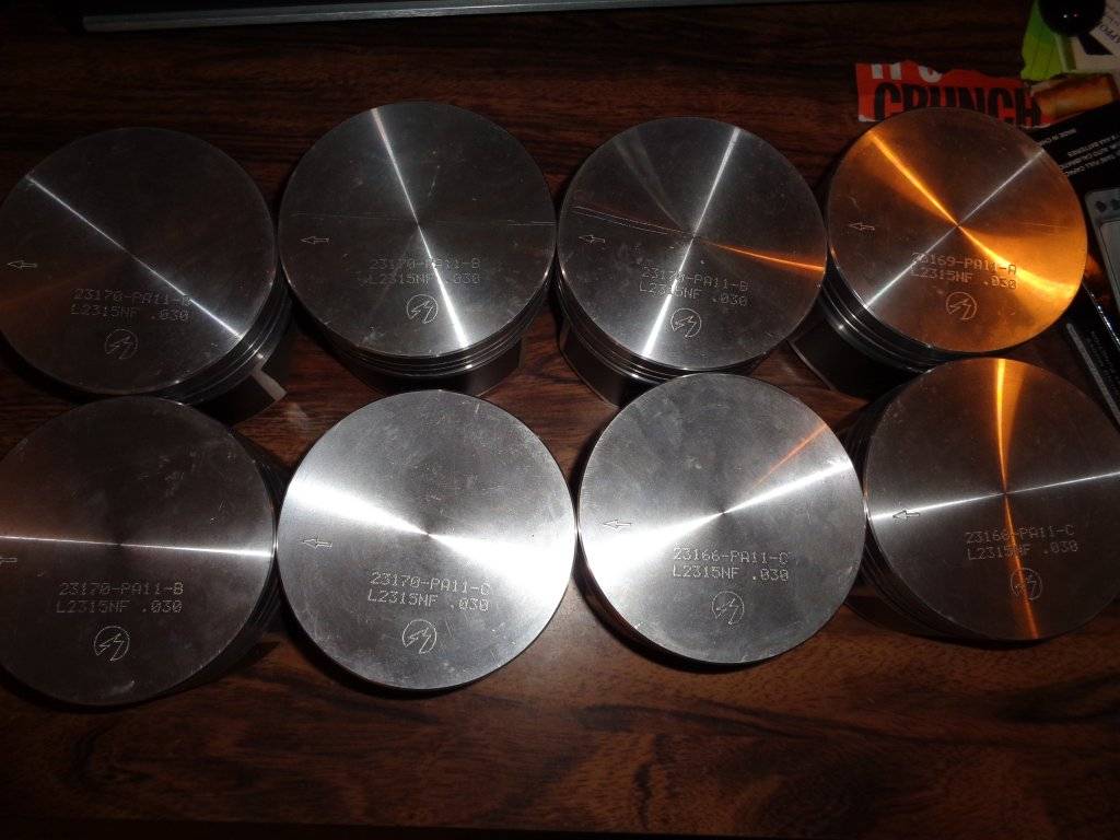

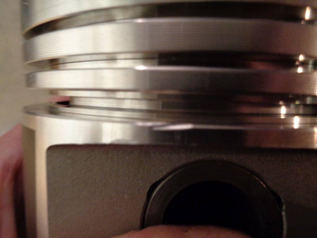

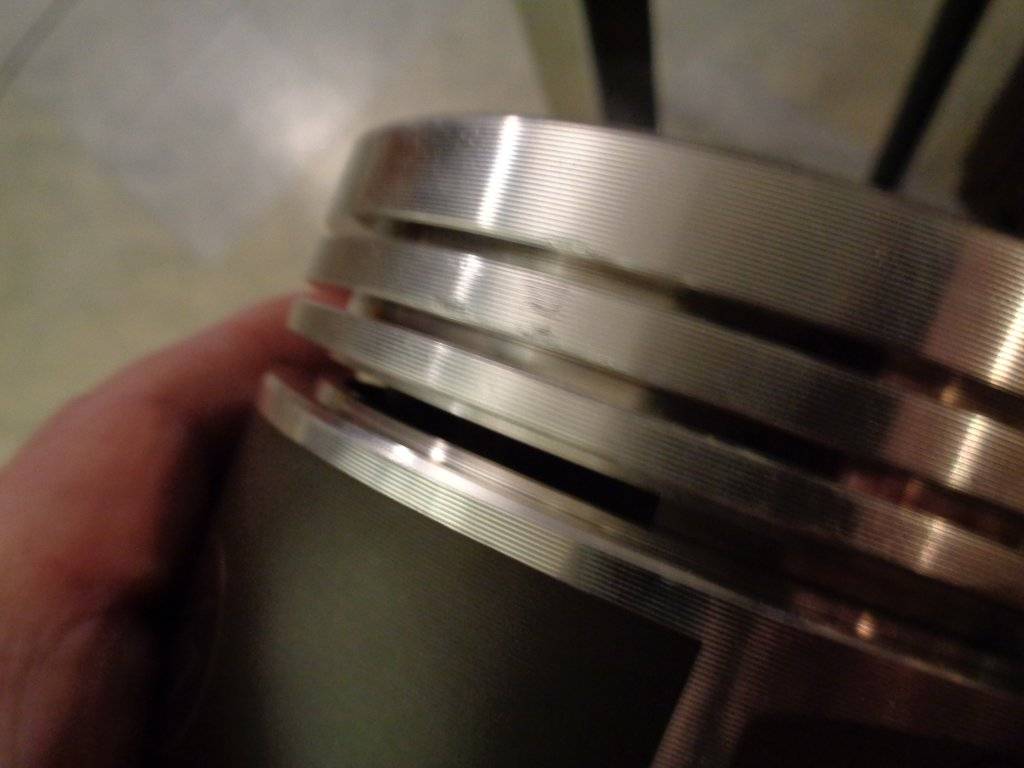

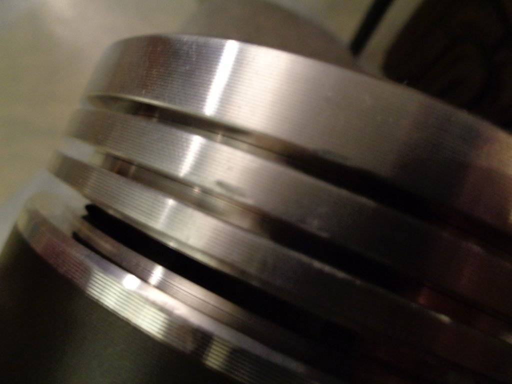

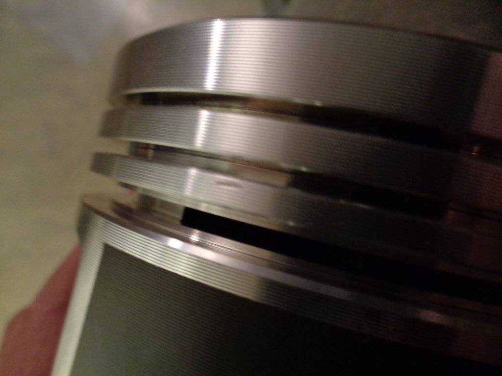

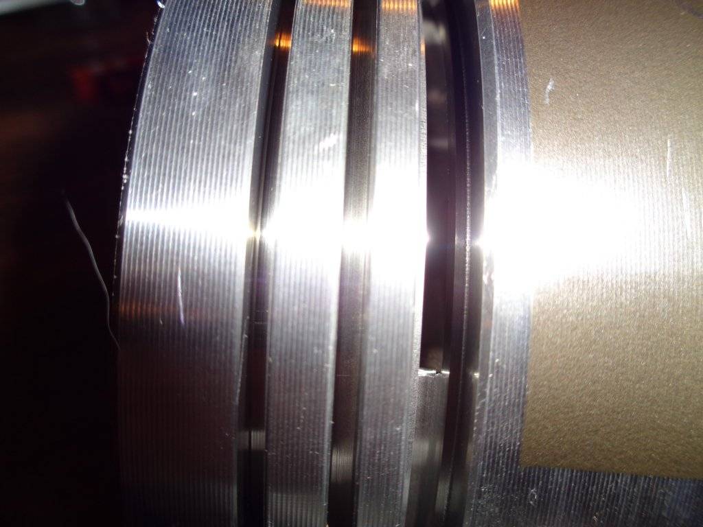

I just got these in the mail. The sealed power box seal was broken and some pistons dont have matched serial numbers.

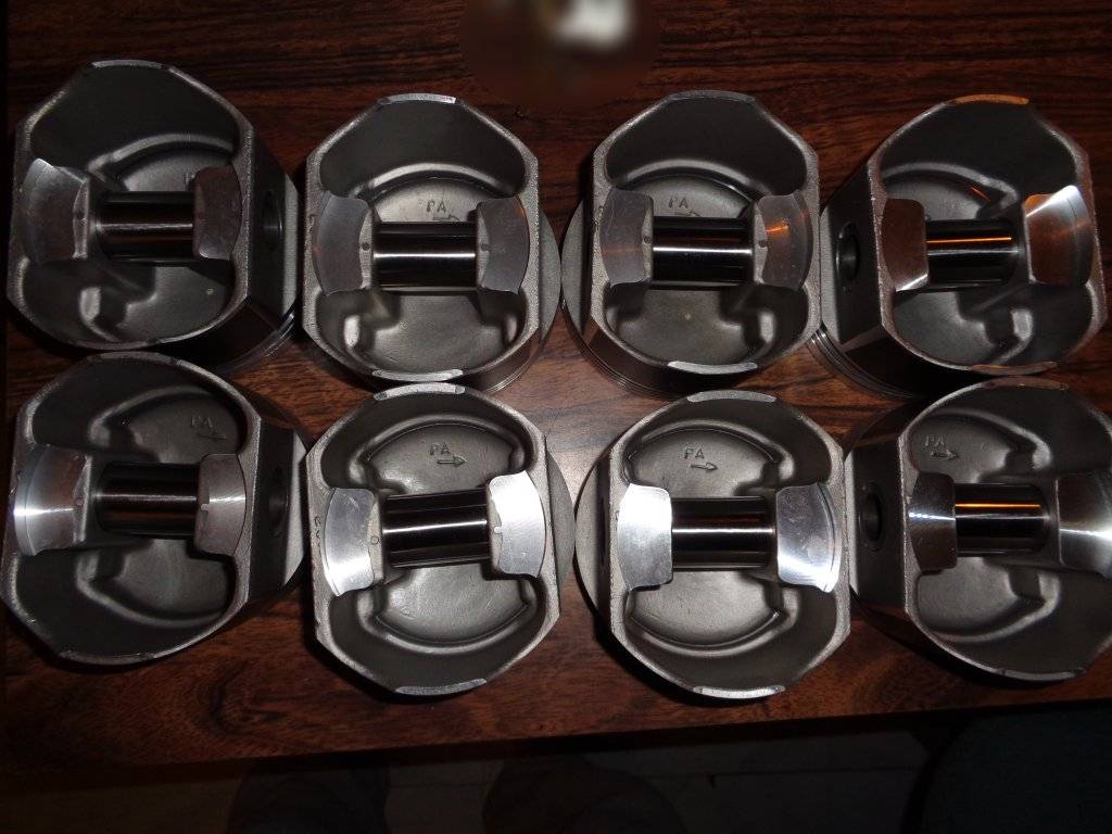

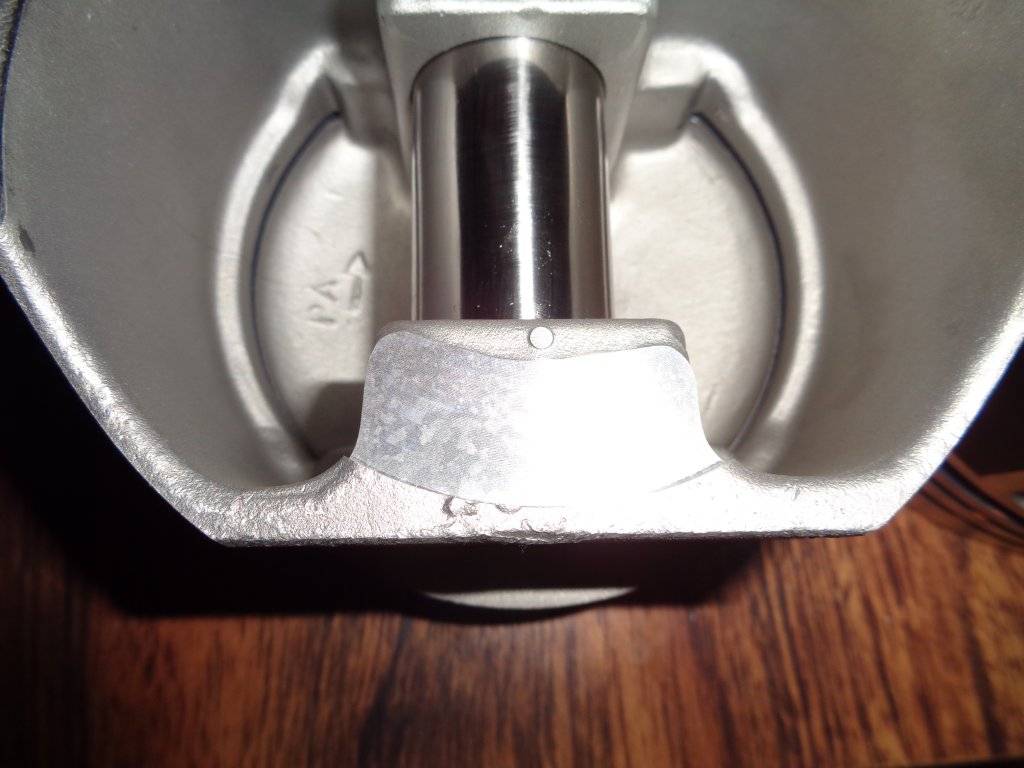

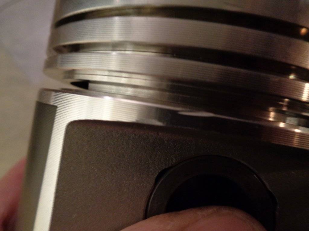

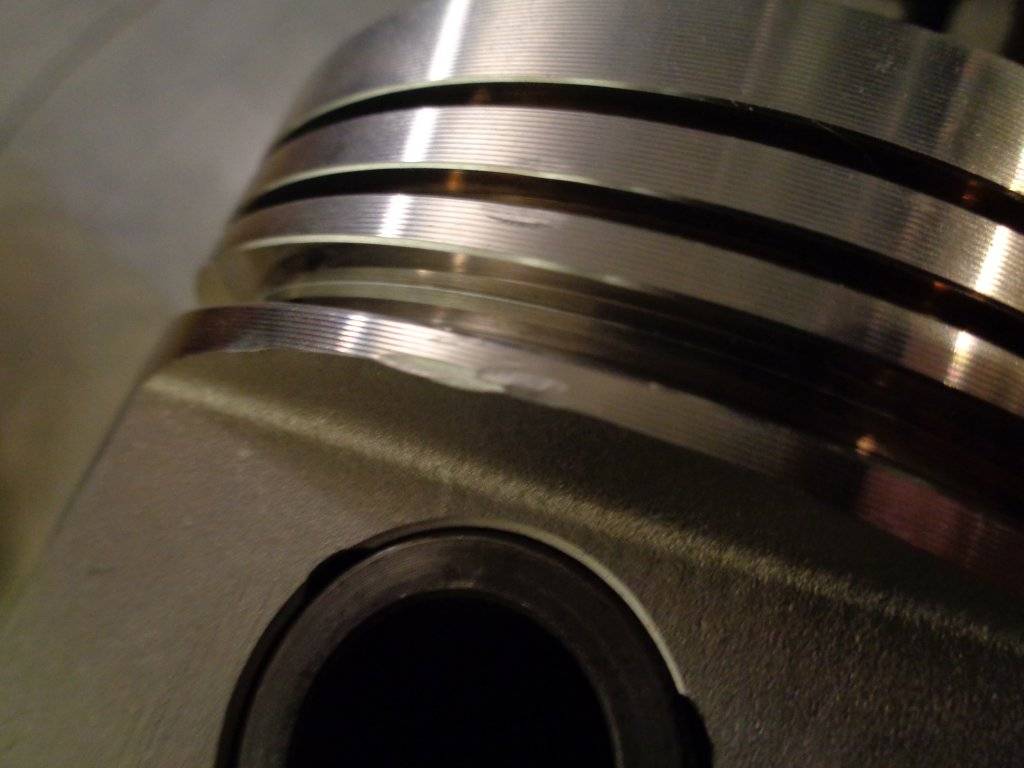

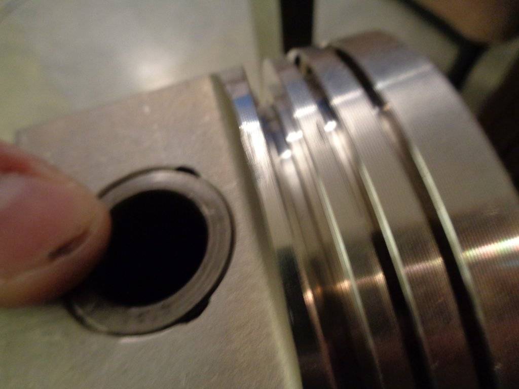

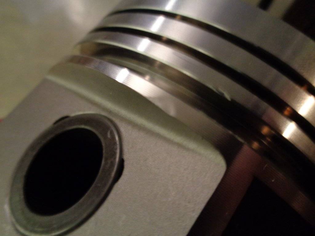

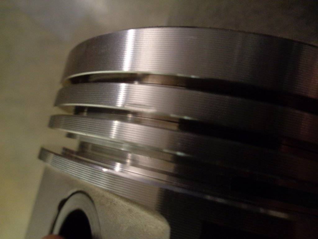

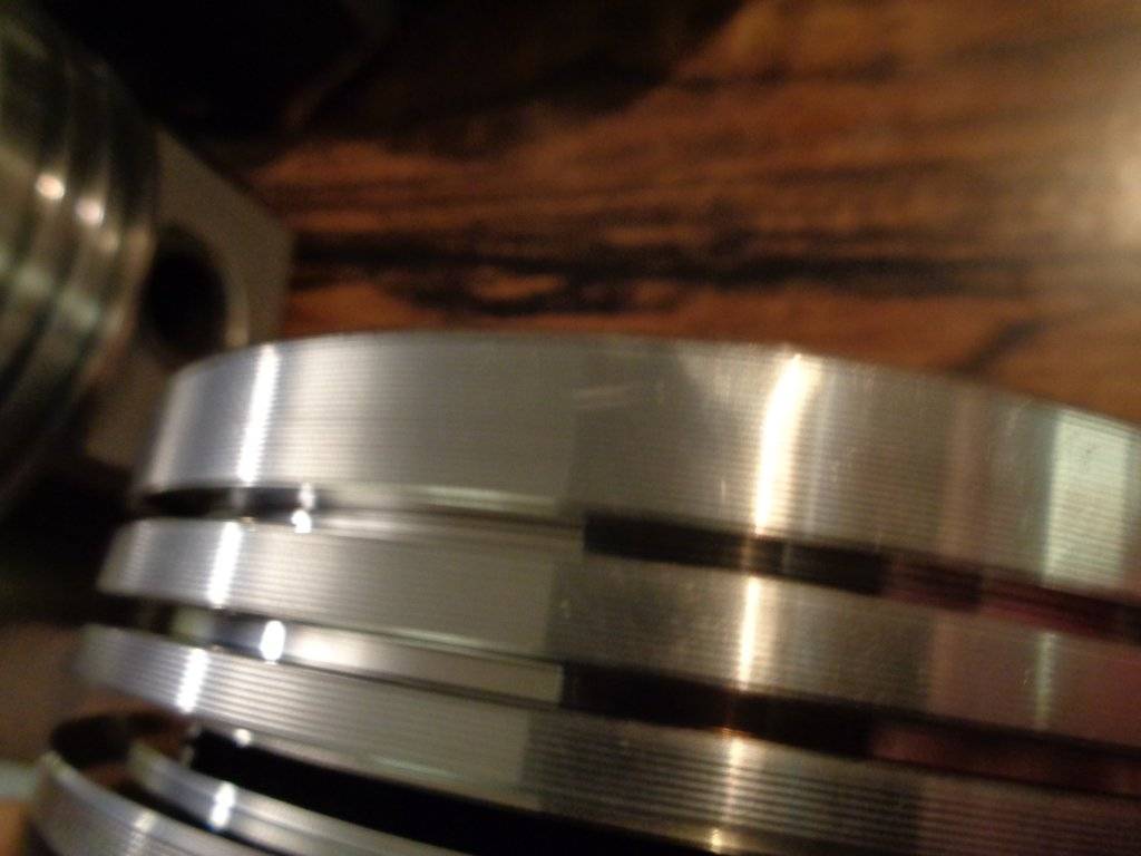

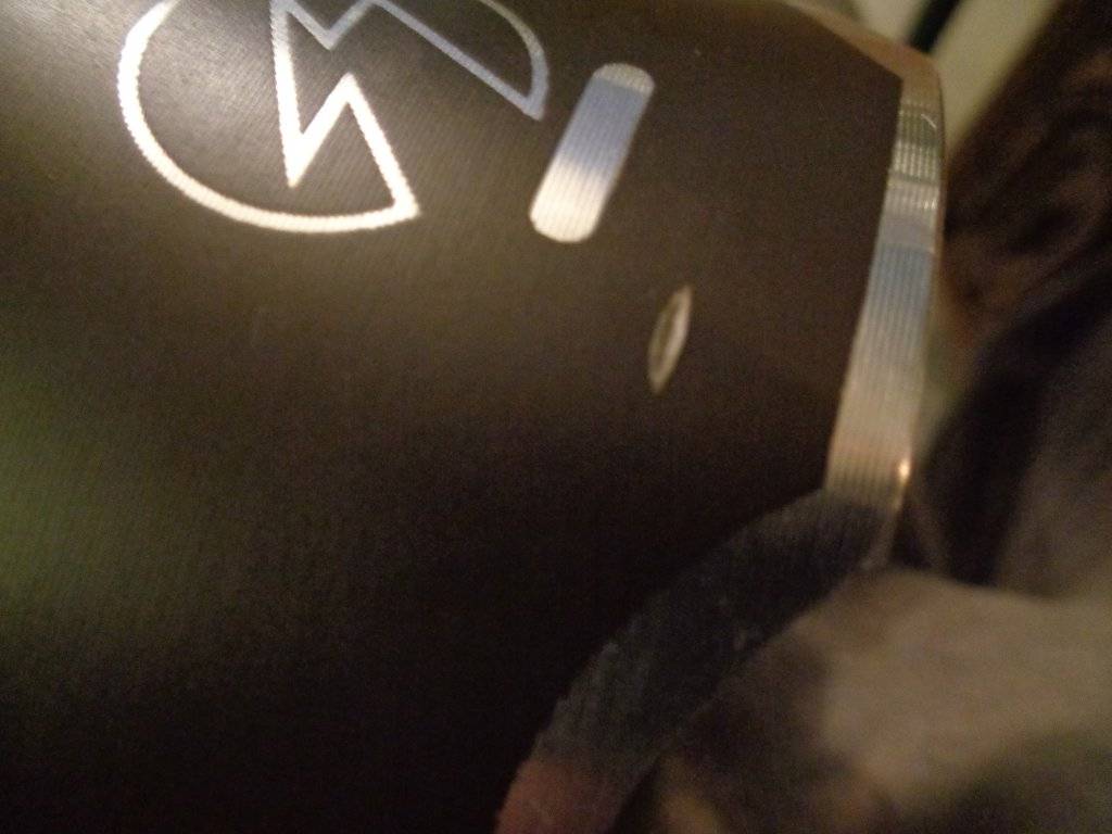

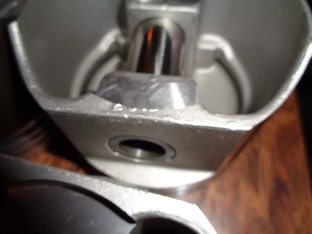

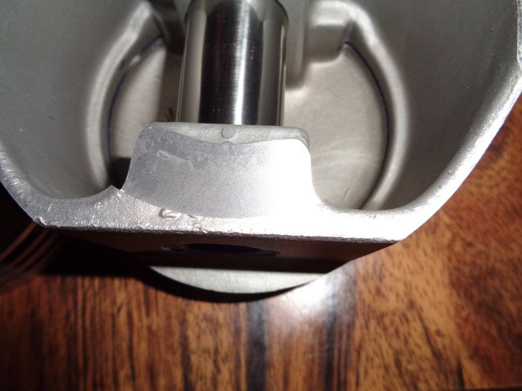

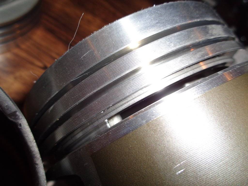

Almost all the pistons are dented or have a gouge and the 3 pistons that are odd serial numbered have a different machined surface on the bottom of the pin shoulders.
Is this acceptable or should I be pissed?

Ok the serial number is no big deal and the different machine marks are to be expected by some manufacturers. The blemishes are a concern but I don’t see anything that could not be easily cleaned up and run.

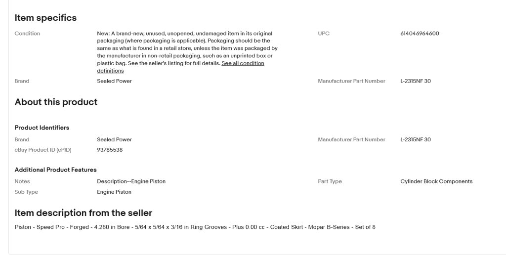

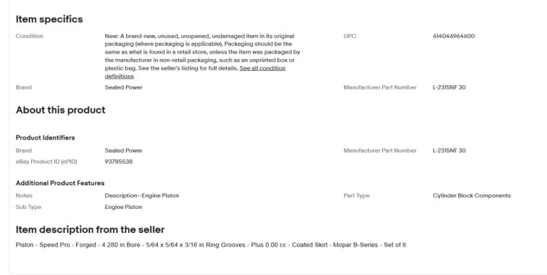

As far as being pissed about a feebay purchase, I say it depends on how they were advertised. I would have to read the ad first. If you post up the seller’s description I could give you my opinion.

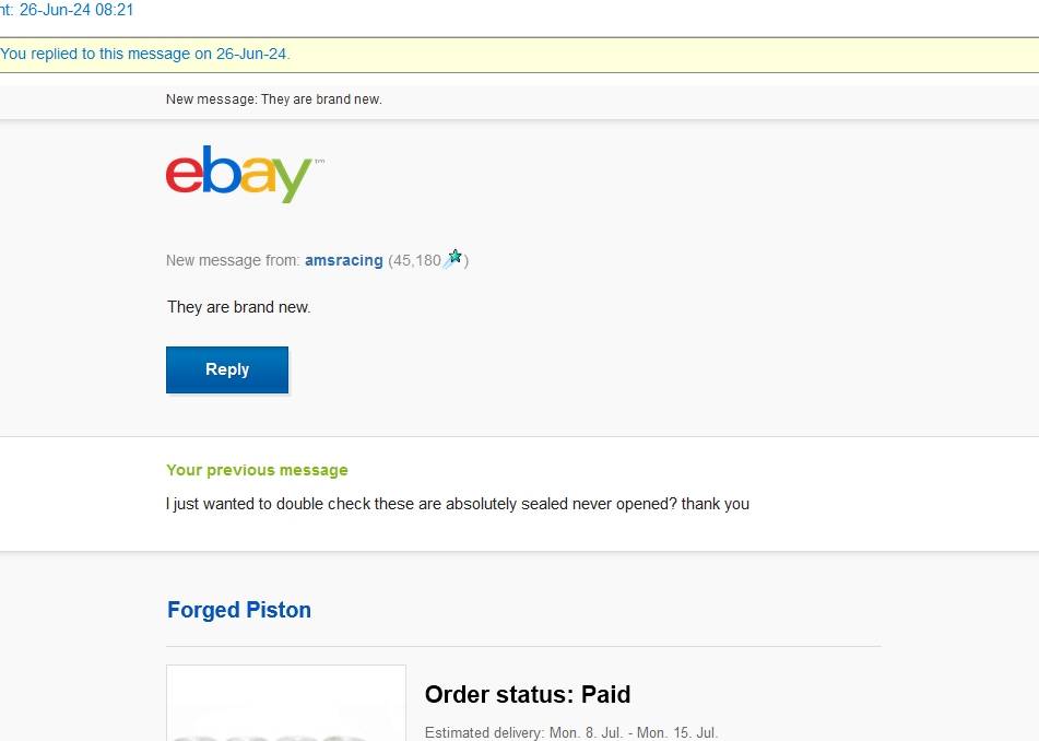

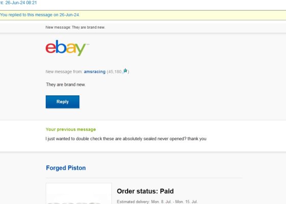

they are supposed to be factory sealed set of 8 matched pistons. I even asked if they are for sure sealed and they said it was. I'm not buying it. The seal was broke on the factory box. maybe shipping did it? who knows. I'm gonna complain and if I buy another set somewhere else I want them to inspect the seal and put more protection around the pistons and maybe even take a picture of each one.

Some of those marks are from mishandling. One of the chances you take with eBay purchases is it's either stuff that's been sitting around for years, something that's been bought and returned and/or a mixed set of good parts from damaged sets. In this case, I would say that a "set" of pistons will weigh the same. A mixed set may have different weights.
Some of the marks are left over from manufacturing.
Regarding the marks, there's really nothing there that is going to cause any real problems. Although I say that by only looking at the pictures. You may need to lightly dress some marks down with a small file or sand paper, add you will want to have the rotating assembly balanced anyway, so that should have the pistons all matched when said and done.
Pistons are a precision part and should be handled as such. Unfortunately that doesn't always happen. Damage often occurs from pistons banging into each other when handling.

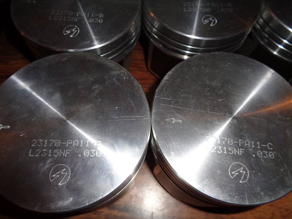

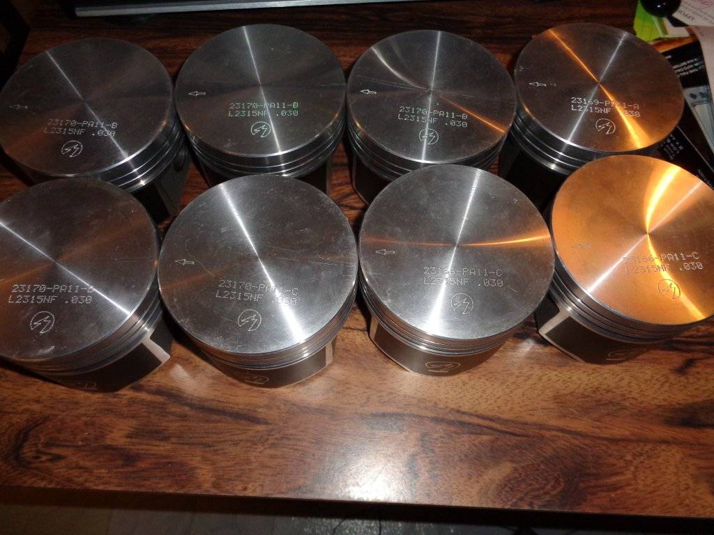

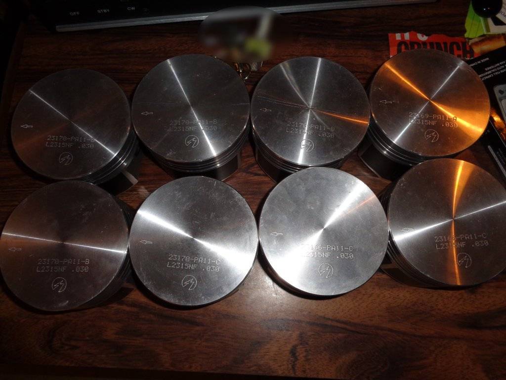

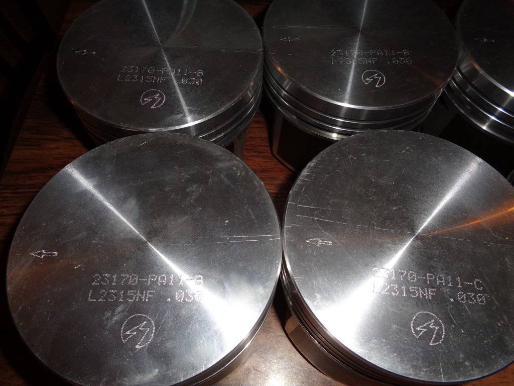

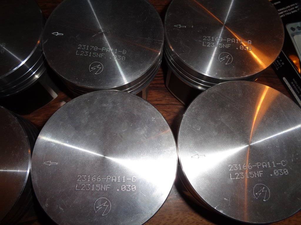

We'll see what happens but it should be factory sealed sets. I cant see the factory putting 3 different serials in 1 box.
actually looking closer, 4 different pistons.
I would say 4 of these are from another set or sets.
23170-PA11-C
23170-PA11-B
23166-PA11-C
23169-PA11-A
I would guess A B C is weights? 23 year 170 days pa11 the plant?

Definitely contact the seller via eBay and explain your concerns. The issues with serial numbers don't really concern me, BUT the damage to the friction areas does. The issues with the balance pad area are not significant, either, as long as the weights are the same, so find a digital postal scale (even at your local post office, during off-peak times) and check and record each one.

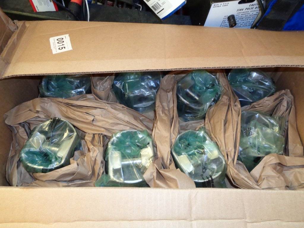

Packaging? Put more protection around each one? Were these pistons loose in one box, with a cardboard divider or packed in individually-sealed boxes? Some "warehouse wear" from contact with the cardboard during shipping might be acceptable, BUT not the nicks and such. Other than basic clean-up, they should be "ready to install" when received. In this case, "not useable" for many.
These pistons are probably "rebuilder pack", if they came in one box, rather than "retail pack", which would have been individually packaged, I suspect. That's why the price was probably less than other sellers? As such, they were not really meant to be shipped "cross country" but delivered from their distributor's warehouse to the machine shop. HOPEFULLY INSURANCE WAS PURCHASED as one of the first things the seller can claim is that if it was "shipping damage", then "it's not their deal", but the shipper's deal.

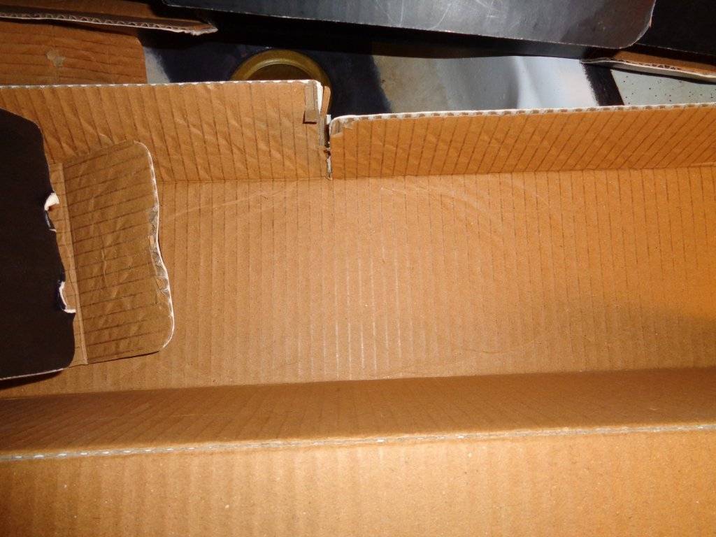

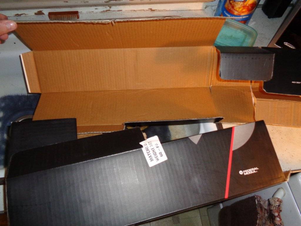

They came is a retail box BUT the code on the box is 23172 so the pistons should be 23172-pa11-*
So not the original box.

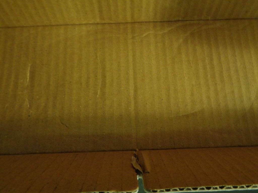

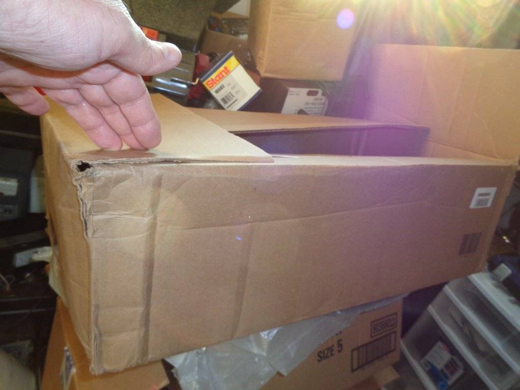

It was not taped closed and no dividers for the 4 middle pistons in the box. You can see where the pistons have impacted the box multiple times then that box was in a huge box with room to fly around they but about 5 feet of brown paper in there with it...

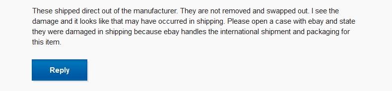

seller says this was shipped from the factory this way.
and it may be, the seller is in Louisiana and the tracking shows picked up in Indiana

thats where federal mogul is too
This is the second company I dealt with on ebay that sells old rejects and then says it was shipping damage, thats what I think.
These companies are running a scam with this shipping loophole.

**I put the pistons in the big brown box and ran the paper myself so they dont get bashed more while I figure this out. that paper was just loose in the box with the piston box which is a sad excuse for packing material.

The dents on the ring land area, make sure the rings are not tight there. The rings need to move freely in the grooves.
Other than that just take off any high spots and have the engine balanced.
