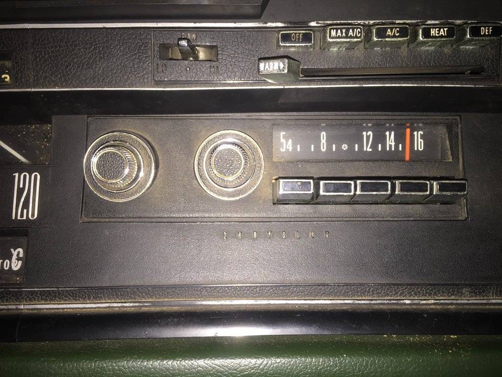

I am in the process of replacing the dash pad on my '71 Newport and figured as long as I'm poking around in the dash I might as well take a look at why my radio is inoperative.
My Newport has just the plain AM radio and it turns on but all I get is "frequency sounds." I did get one station to come in very briefly only ONCE. When the door ajar buzzer is on all I get is speaker static. I assume that is normal? This in the only car I've ever had with only an AM radio.
So is there a way to test the antenna? There is no change with it unplugged. Or do I just have a bad radio unit? Maybe I'm better off replacing it with an AM/FM radio unit instead? Ideally I'd like to keep the car factory but I would also be open to options.
Any help is appreciated, thanks.

You could try "trimming" the antenna. From the FSM, this is the procedure.
(1) Operate radio for 15 minutes.
(2) Extend mast type antenna 31-1/2 inches.
(3) Manually tune radio to a weak signal between
1400 and 1600 K.C.
(4) Increase radio volume to full volume and set
tone control to maximum treble (fully clockwise) on
knob controlled radios or upward position on thumbwheel
radios. Use a short screwdriver under instrument
panel and adjust antenna trimmer in bottom
right hand corner of radio chassis for AM and AM
tape radios. Behind right hand knob for Search Tune
radios. AM/FM Multiplex-Chrysler—right hand lower
corner. AM/FM-Imperial—inside tape door (right
hand side).
Adjust antenna trimmer by carefully tuning
back and forth until position is found that gives a
peak response i n volume. Maximum output indicates
proper point of antenna trimmer adjustment.

1.) Since you have the dash off, turn the radio on and try shaking the antenna lead where it approaches the connector for the radio. These were prone breaking there. If you get intermittent radio while moving the antenna lead, you have a bad connection inside of the lead.
2.) If that did not help, try checking the antenna base where it hooks to the fender. Be sure the cable is still attached.
3.) A quick check for a bad antenna or antenna lead is to attach a different antenna temporarily. If the radio then works your antenna is bad.
Found that I have a bad radio. For now I going to leave it in and buy a Bluetooth speaker/boom box to put in the back seat instead so I can just play music from my phone.
