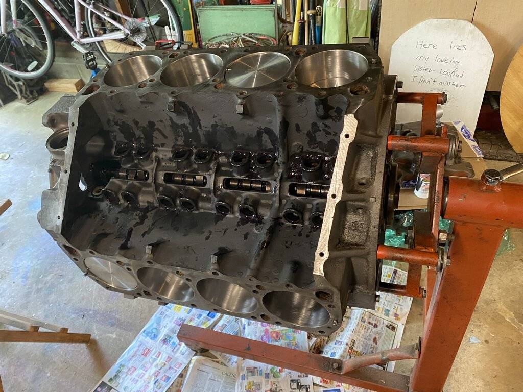

That is what I was afraid of. We pulled it out just a bit past the last bearing and it spun freely. I took a straight edge to the cam and it does not appear to be bent. Pistons and cam are all installed, wonder how easy it would be for them to replace the cam bearings? And to think I was going to have them finish the assembly, but thought my son and I would have some fun putting it together.

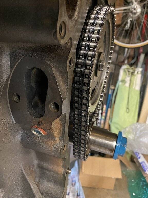

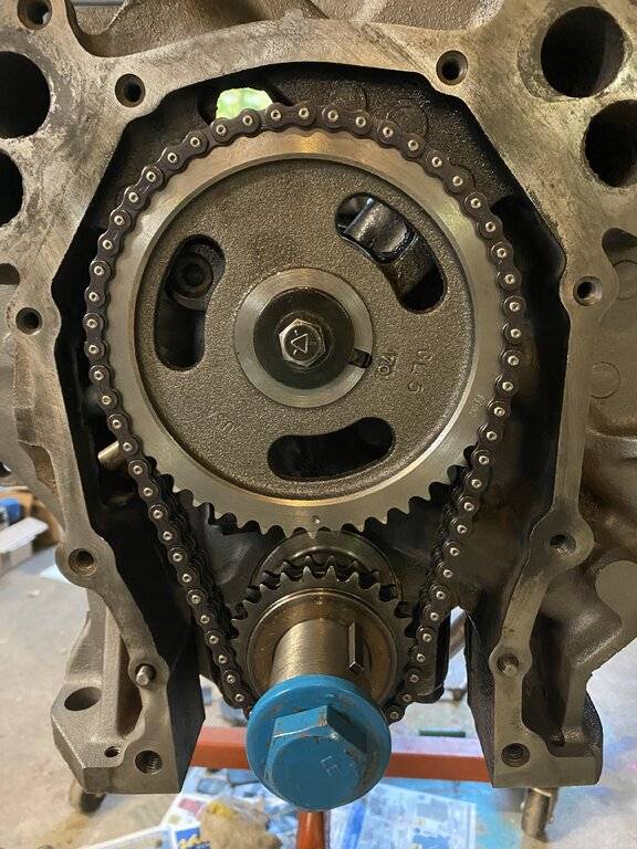

Probably the best bet. Also can’t get the double roller chain to fit either, looks like I need a 1/16 of an inch of chain slack for it to slip on. I’m much more comfortable welding and finishing body panels than wrenching around motors, that’s for sure.

And what the hell is going on with that "Here lies my sister" in the background?
LOL, that’s a Halloween decoration my son made in scouts years ago. The other side says something like “here lies Nicky Noodle, he was attacked by a pack of poodles”.

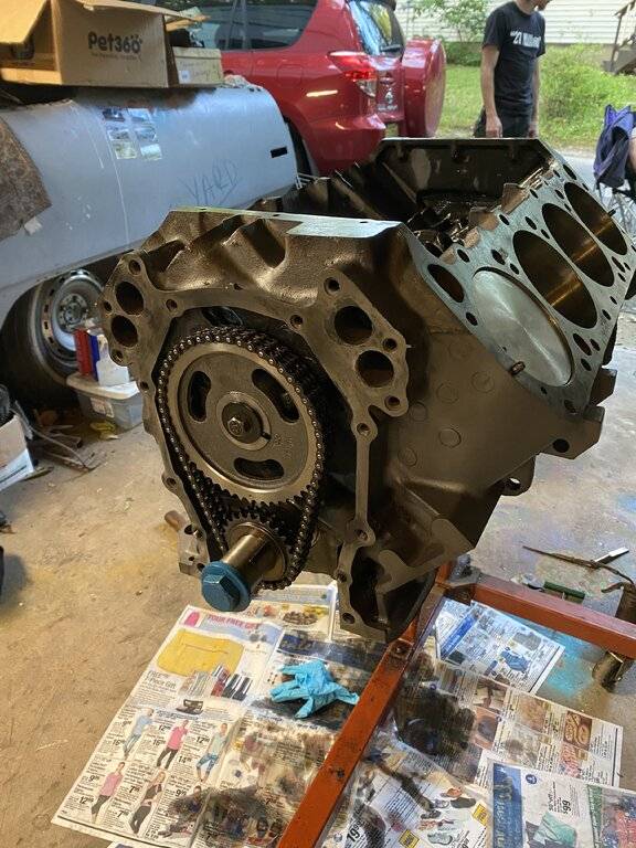

There is a new plug back there, easy enough to knock out and scrape the bearing, I think I will try that. I have a call into the machine shop, I’ll see what they say on Monday. They are old school and easy to deal with, he might just suggest that. I am worried about the timing chain not fitting, I can’t imagine stretching a double roller. The other chain had about a 1/4 inch of play and slipped right on, gears are steal and look like a recent replacement, I might just clean them up and go with that.
Soak the timing chain in light motor oil overnight, double roller needs to be properly lubed to fit correctly.

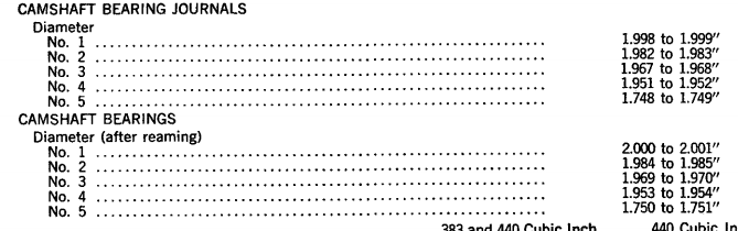

Careful, careful......no cam ever gets tight until it's all the way in. Meaning it's not always the No 5 bearing. Only a 20% chance it's that one. See this chart from your FSM?
The bearing journals get smaller as they go from 1 to 5. Number 5 always goes thru the other 4 bearings, 3 always goes thru 1 and 2, etc. But when all five have to fit in their respective bearings, that's when you have this problem. Point is, it can be ANY of the five, not just number 5.

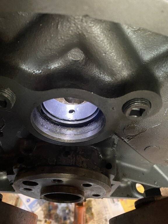

Thanks again everyone for all the help. We popped the rear cap and could see right away where the high spot was just from rotating the cam a few times with the breaker bar. I didn’t need to cut the old cam, I used 600 grit soaked in oil to hone the bearing. We were able to see high spots on the other bearings and repeated the process until I was able to spin the cam with two fingers. As a precaution I used a magnet to pick up any stray flakes and repeatedly squirted light motor oil to flush any debris. @moper was right, the chain fit when everything was in the right place, although there is absolutely no slack. I was able to turn the whole rotating assembly, no binding or scraping sounds.
Oh, another thing. When I've knocked cam bearings in (30 years ago), I've always run a long drill--same diameter of the oil feed passage--down that passage at bearing 4 to gently drill out the bearing if it hasn't been clocked properly during installation and is thus blocking the feed passage.
I did notice some misalignment on #5:
