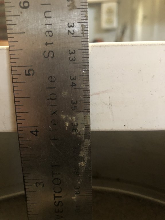

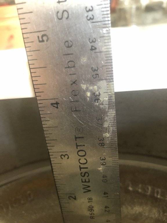

Yes... there is about 1/16th of a difference. When I was looking, a few weeks ago, I couldn't find the measurements on sellers websites, so looks like have to buy and hope for the best.
Let me see if i can describe how I measured the drum. First measure the depth of the part of the drum where the backing plate fits into, the U-shaped part and I think it is about 1/2 inch deep. Then laid down the drum, backing plate side, or inside, facing down and measured the distance from ground to the inside of the drum, the side where the lug studs go, I believe it was about 3 15/16 on the good, original drum. So basically I measure straight down. Then subtracted the two measurements.
