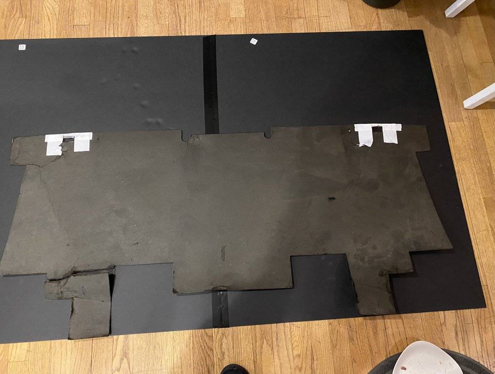

Just pick up a thin sheet of partical board, and use the old one as a template. Works great, and won't fall apart. I did this over 20 years ago in one of my cars, and nobody knows the difference if you don't point it out . . .

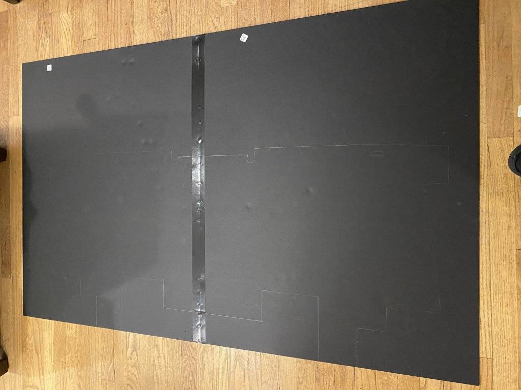

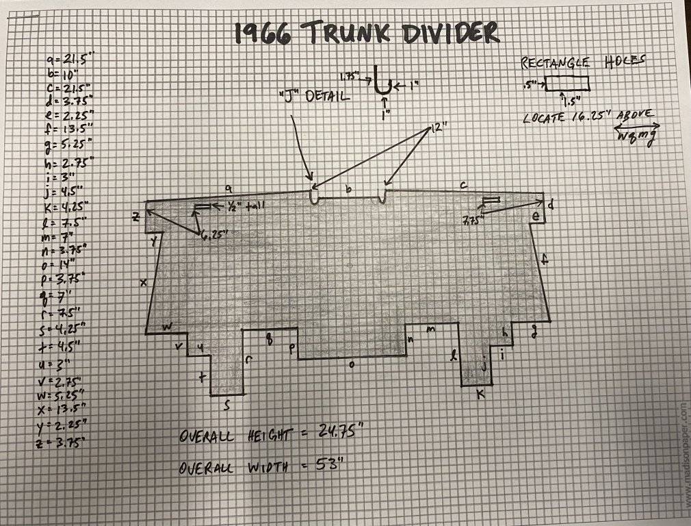

I made this diagram for a 66. It might be close enough for you.
