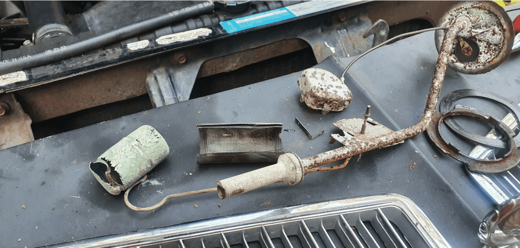

I have confirmed that my acceleration issues are because of junk in the fuel tank. Difference in fuel output of the pump when it was hooked up to the tank compared to when it was hooked up to a jerrycan was massive! So I will drop the tank and remove the sending unit for inspection. Maybe I'll even get my fuel gauge to work again, who knows.

Are sending units for a '75 imperial still available somewhere, or even just the sock at the base?
Do you need the lock ring tool or will it work with a flathead screwdriver and hammer?

if you have a radiator repair shop near you that can boil it out, that is probably the best way. use a brass punch on the lock ring. you don't want any sparks!

After I checked all the fuel lines for obstructions which were all clear so I pulled the fuel tank. Removed the sending unit with a screwdriver and hammer, worked fine. As far as I could see the tank itself was pretty clean, no real rust on the inside. But I flushed it anyway. The problem was clearly with my sending unit. Both the sock filter and the float had come apart and disintegrated, blocking the fuel line. Also explains why the fuel gauge wasn't working.
Another mystery solved, thanks guys!
