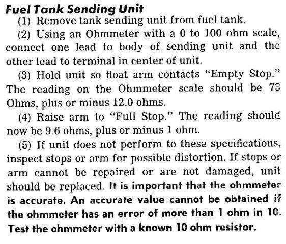

Most after-market gages today have ~4 range choices, and one fits Chrysler & Ford. The manual below (posted on A-body site) says 10 ohm full, 73 ohm empty, so Alan was real close. Indeed, most people say 90 ohm empty. I was just testing a new sender for my 64 Valiant on the bench and adjusting my fuel gage to match (cluster out). I recall measuring 90 ohm empty, 9 ohm full, at full travel of the sender arm not necessarily where the float will stop in the tank. Mid-way is ~25 ohm.
