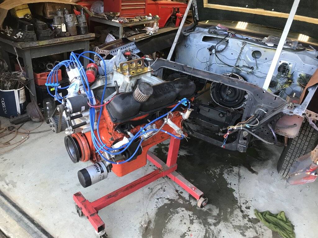

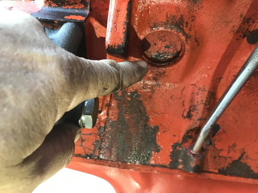

I officially retired the 400 today. Freeze plug failed & other issues. A 440 will be going back in it. The 727 is going back to the trans guy. It’s not right. I talked to him today & he said to bring it back. Probably putting a 5.0 lever in it & a Cheeta valve body. Might put my 4:56 gear in it too. I’ll have some video on my YouTube channel hopefully by the end of the week.

and why is it always the hardest to get to freeze plug that leaks?
