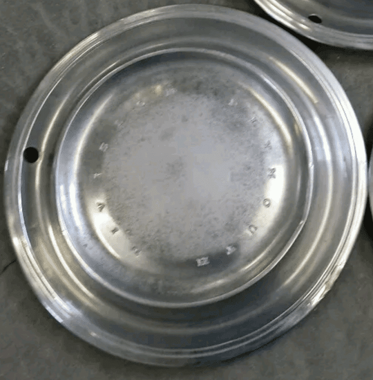

I have a set of original hubcaps for my 1070 Plymouth Fury III and the black has wore out in the middle.
My question is, how can I repaint them and keep the Plymouth Division lettering chrome?
The Corvette Fanbois taught me this one... :rolleyes:
Smear grease over the lettering so that it fills the depression.
Clean the surface of the area to be painted of any grease.
Paint.
Dry.
Wipe grease off.
Paint.
Dry.
Wipe grease off.
Thanks. I will try that.
Looking forward to seeing the results. I need to do the same thing. It seems like it will be hard to clean the surface area of grease so that the letters have nice edges.
I believe the factory silk sceened the wheel covers so painting will never produce as sharp an edge as they were originally. Sometimes you just have to do the best with what you're given.
How about using spackle or even toothpaste?
Geez.. Spackle sounds like a great idea. I like that a lot better than grease.
[QUOTE="commando1,
Paint.
Dry.
Wipe grease off.[/QUOTE]
:welcome:
First........ These are wheel covers, not "hub caps".:poke:
Stans method works great, also on things like chrome emblems that are blacked out around the edges, etc.
A couple of light dustings of satin black is all you need.
[QUOTE="commando1, I believe the factory silk sceened the wheel covers so painting will never produce as sharp an edge as they were originally. QUOTE]
Once the grease is removed a cotton cloth, Q-tip or toothpick dabbed with paint thinner or acetone will feather the edges nicely.
That one shows the gator-skin texture nicely. I don't know how you'd reproduce that at home. One of mine still shows that pattern, but the others must have been repainted at some point.

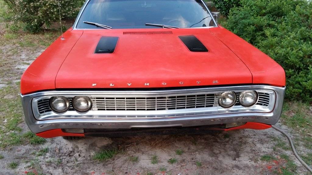

I appreciate everyone's help. I spent this past weekend stripping the paint off the bumpers. The previous owner painted over both bumpers. But I will get on the wheel covers this week hopefully. But since I finished rewiring the whole car, I will probably get the AC restored and working first.
I will post pictures of the finished wheel covers when I get them finished.
Thanks again for everyone's help.
The bumpers look great with the paint stripped off. Make one wonder why they were painted.
That's just one of the things that the previous owner had dine to this car. The wiring was rigged in an unsafe manner, he replaced the steering wheel with an after market steering wheel that was not installed correctly and it was loose. He had a toggle switch for the backup lights. The list goes on, but I have gotten it all straightened out finally. Besides the AC I only have cosmetic work left to do.
