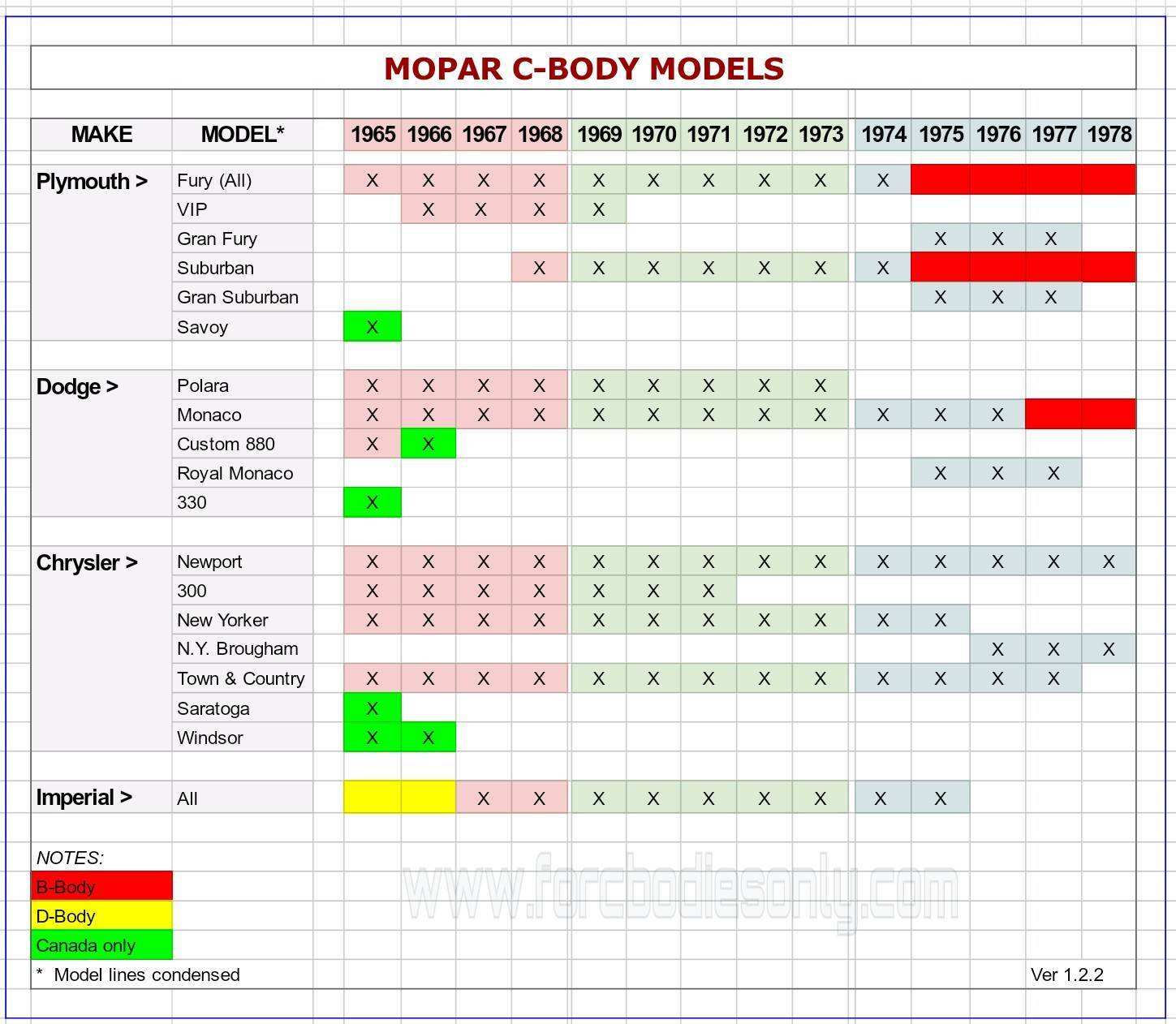

Thank you very much I did not know that they were for the Imperial only I'm doing a disc brake conversion on a 66 fury I appreciate the information thank you
No problem. For your car you can use either 1972 or 1973 "C" body spindles. (The Imperial was a "D" body until 1974) The 1972 spindles use the same wheel bearings as your 1966 Fury, the 1973 spindles use larger wheel bearings and are getting scarce due to them being a one year only part. What ever year you decide you to use you will have to get the rotors and bearings for that year. The pads and calipers are the same for both years.

Uh Oh.... Stan alert! I think you better handle this "D-Body" stuff Stan
Thank you for the heads-up. Spreadsheet to the rescue...
