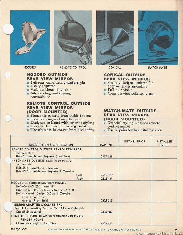

Pardon my ignorance - were passenger side mirrors mirrors offered in '66 on Newport/New Yorker/300?
thanks!

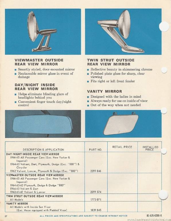

Two styles were available, and both are available used and aftermarket / repro.
Standard was a 2 post, if I remember correctly. If you have that they are the same LH and RH
Optional was a LH remote. If you have that the RH matches the style and is readily available (A, B and C body are the same)
I hope this helps
The 1970 Hamtramck Registry - 1966 Accessories Catalog Slideshow (Page 1)
