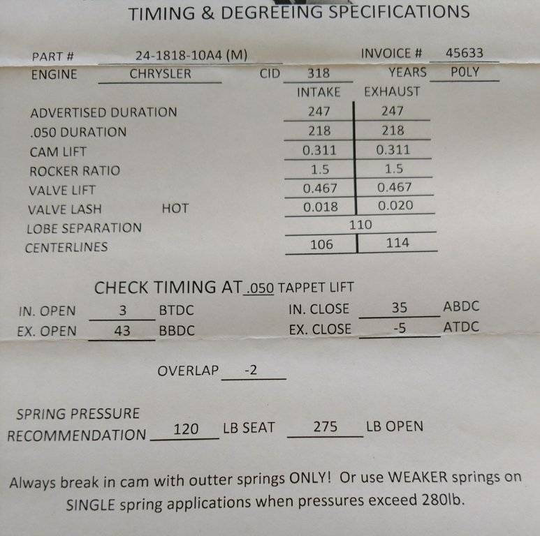

Looking for someone who has experience with 318 poly cams...I purchased a "performance" cam to drop in my 318 poly to complement my 4 bbl upgrade. The company I purchased it from (very familiar with the poly engine) says it is ground for a good overall performance and power increase while not losing too much power down low or vacuum- (what I wanted it to do) I was ready to install until I posted the specs on this forum and was told it is NOT going to do what I want and may in fact be less of a cam than the factory installed one.
I know nothing about cam grind numbers and am hoping someone with more experience than me can tell me if I bought/was sold the right cam or not! Attached is the specs sheet. Any help would be greatly appreciated.

That cam specification looks pretty good, have you gotten it installed and running yet? Who was the supplier? I haven't been able to find many performance cam options for the Poly 318.
I've put a good 600 miles on the car now since all the work was completed. It's tough to know where the greatest improvement in performance came from as all the mods were done at the same time...4bbl carb, performance cam and a 3.55 suregrip rear to replace the factory open diff. Overall it is a pretty starting difference though. The car is a lot quicker, and it pulls hard to 80 and beyond. Only downside is a higher engine rpm at highway speeds. Here's a link for the cam supplier...I spoke to them on the phone and they were very helpful. I described what kind of performance I was looking for and they custom ground the cam to spec.

Thank you so much! Super helpful!
