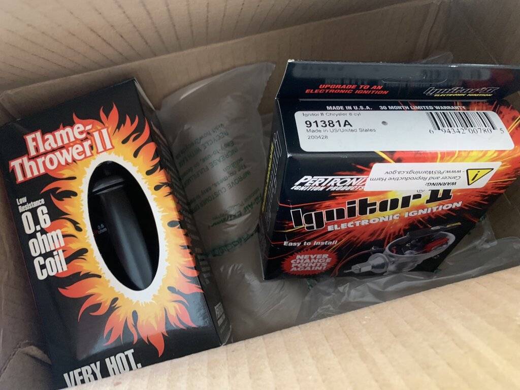

I’ve had this Jeg’s box sitting in the kitchen since mid November. My brother got it for me as both a birthday present and to drag me into the future. I’d been complaining about needing to buy a new coil for the Fury as my 50 year old unit seemed to be sucking wind. He got me a new coil and a pertronix set up just to stir the pot.

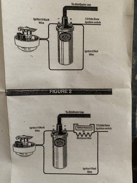

I’ve put it off but I figure I’ll give it a go as he did spend some decent coin on the present. Looks from the instructions I power the the unit pre ballast and the coil stuff post ballast or I can power it off the ignition switch. I tried one back in the early 90’s that burnt up and just stuck with points ever since. That was a long time ago so I don’t remember how it was wired but I did follow the instructions. Figure 2 looks easier.

From the diagram it looks like you’d keep the ballast and run the unit off the front lug then run the coil off the back lug. If you 100% bypassed the ballast for the pertronix unit why would they want you to use it for the coil? or am I reading the diagram wrong.
Honestly I’d like it to work and not burn up making me an even bigger leave the points alone zealot LoL!!!
This is what he got me.
A pretty nice present.

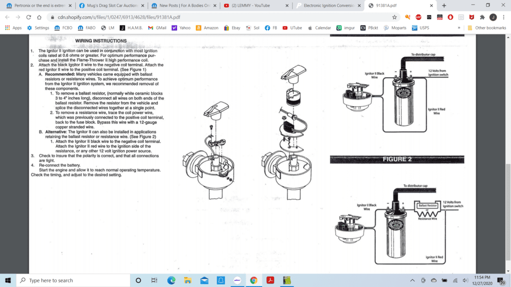

Here, did a screen shot of the instructions. I think you are reading it wrong.
1. OK, your coil has to be .6 ohms or more and you have that covered. This allows you a wide range of coils to use in the configuration shown including the stock coil. IIRC (and it's late) a stock Mopar coil has around 1.5 ohms primary resistance.
2. There are two ways to hook it up. What you are doing is mixing the two. You can do "A." which they recommend and is shown in Figure 1,
"B" is the alternative and uses the ballast resistor. That is what is shown in Figure 2.
Don't do both... My strong suggestion is to do "A" as shown in Figure 1. This completely bypasses the ballast resistor.
The other way does work.... My car was hooked up that way when I got it, but there's no advantage, no need and adds another component that can fail (the ballast resistor). The way I understand the Pertronix works is to limit the current while running to the coil, just as the ballast resistor does, and makes the BR unnecessary.

Okay thanks that clears that up. I’ll eliminate the ballast and run figure 1.
