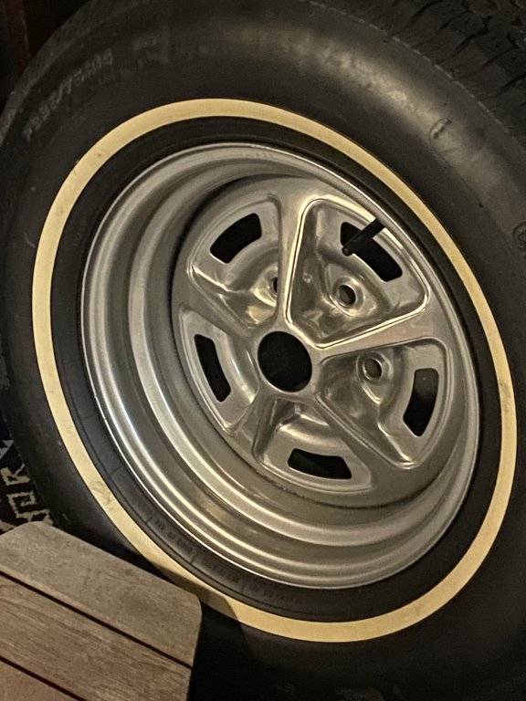

Just wondering if anyone here has used plastic dip spray on any painted surfaces of their car? In my case, I want to blacken the inner areas (5 on each wheel) of my silver powder coated rally wheels. I’m dreading sanding all those little areas. I’ve heard: If you clean it real well, tape it off and spray plastic dip on, it’ll stay on there for as long as you want it…Until you want to peel it off. Is this true?

Is it true you only have to wipe off dirt with some type of alcohol based cleaner and sanding is NOT necessary? How about at tape line? When removing tape is it necessary to cut with razor blade? That’d be tough not to cut into powder coat and create a rust line.

No sanding or it will not peel off nicely later.

Yep, what 300rag said is very true. Smoother is better for removal later and it will adhere fine to a smooth surface if you keep the coats thin.
