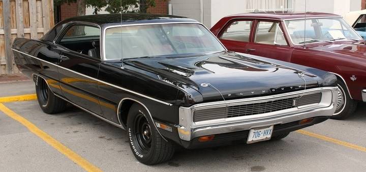

Planning to buy an additional set of steel wheels for the Fury (it is waiting for the overseas shipping so I would like to send as much larger parts with it as possible). So I am not able to take measurements hence the question - does anybody know what is the max rim width that should fit? Was thinking 8" rims with -20mm offset and 3 3/4'' backspacing. Rear tires 275/60 R15, Front 245/60 R15? Too much?
I drool over the look of these...
https://i0.wp.com/hooniverse.com/wp-content/uploads/2013/10/32.jpg
Thanks a lot for any input!

This is what I got from Google for the original Polyglas tires so the 245/60 - 26.6" should not be far off? Any quess what size could the pictured tires be?

I do have the originals and I will run those with the correct tires. I just would want an additional set that looks like the pictured one - don't they look super?
...I really think they do but I'm having a hard time figuring the size of them... so help if possible!

Those look like 70-71 police cruiser wheels. Most likely they are 15" x 7". To verify, dismount one tire and measure the wheel.

In the picture, those rear sidewalls look a little too close to the wheel opening, to me. Remember that what might look to fit "static" or sitting still, even bounding a little, CAN rub the body when the car leans in a corner and the spring bushings flex laterally. Better to have some additional clearance in the rear wheel opening and between the inside of the wheel and the rear leaf springs . . . Why limit the cornering capabilities of a Chrysler product due to poor tire/wheel sizing?
To me, FORGET the 8" wide wheels! There's a reason that Chrysler only did 6.5" wide wheels on pre-'74 C-body cars. 7" Magnum GT or similar cop car wheels are a much better option. 70 series might also be better options, too, rather than 60s.
