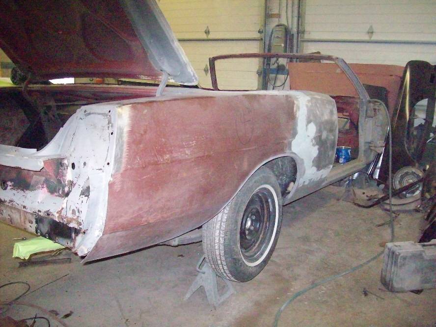

Most 4 door quarters can be used for patch panels. The trunk extensions and inner and outer wheel houses usually have the same part #'s . Wagons of course are unique...typically stretched behind the wheel. In my shop we just used a 4 door quarter to repair a hit 68 Polara 500 convertible...butt welded ...you can't tell now. Some non C's...68-70 Coronet 4drs for example use a different
shaped wheel opening which make them a poor choice for patch panels but with AMD you don't have to worry too much about B Body quarters any more. Good rule of thumb is as discussed above ..if the wheel opening mldg is the same part # 2 and 4 door then most likely wheel houses.extensions and partial quarters will interchange.

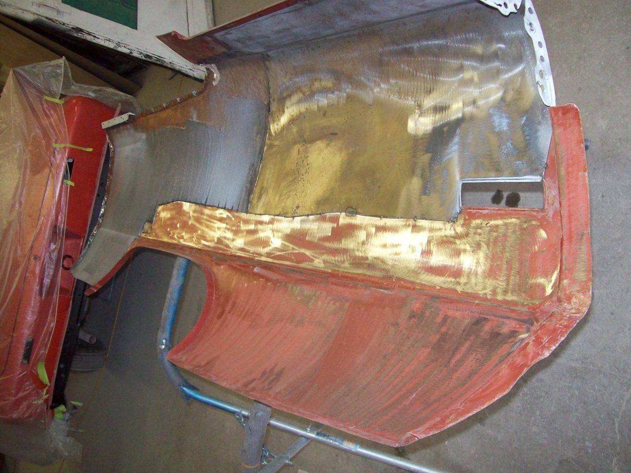

Me....I sell parts.I have a couple of guys that do the mechanical and body work.This pic is a 70 300 convert we did.Drilled off the original quarter to get to all the hidden rust and used a 4 door quarter to repair the lower rear.
