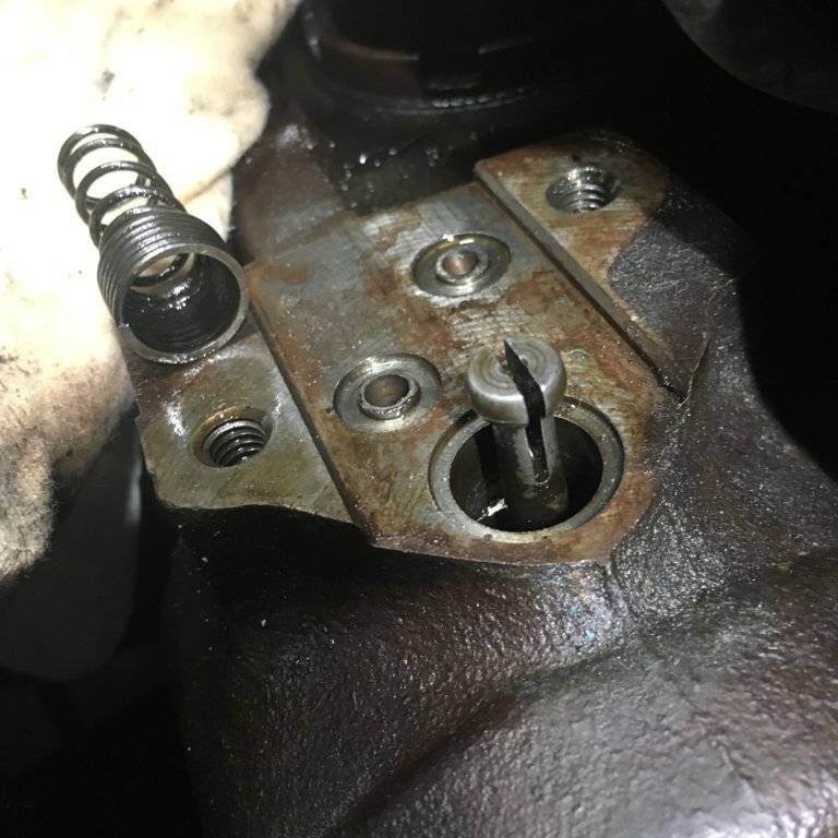

Hoping someone can help with the following issue. This is my first post, so bear with me. I have a 1966 Chrysler 300 4-door with power steering. Noticed a power steering leak was coming from the valve body on top of the steering box. I researched the issue and decided to replace the o-rings. After removing the valve assembly to change the o-rings, I noticed a slotted pin sticking up from the gearbox under the valve unit. There is a spring that surrounds this pin. The problem is that I cannot get the valve assembly to re-seat on the steering box because this pin appears to be sticking up to far. I have not moved the steering wheel during this time. Is this pin suppose to compress down into the steering box or does it somehow go up into the valve assembly?

The spring is not installed correctly. See Image from Sec 19-13 of the '66 manual. Click on mail 004, not the icon. Spring should be inside the valve body.

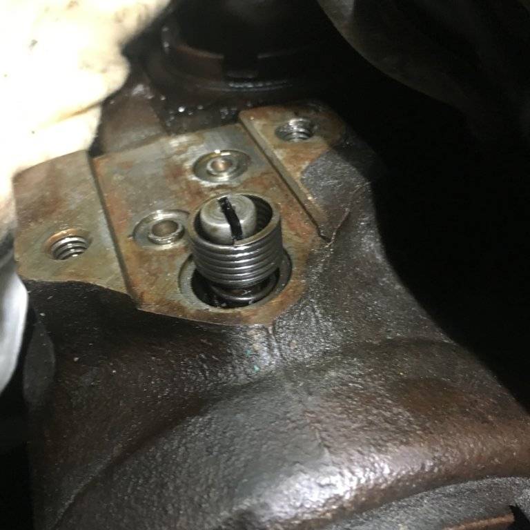

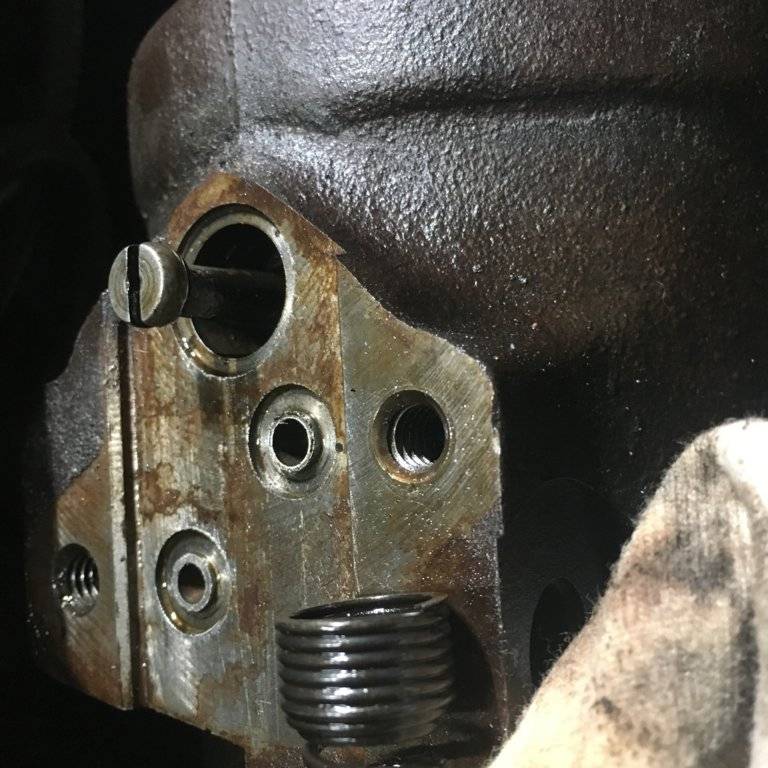

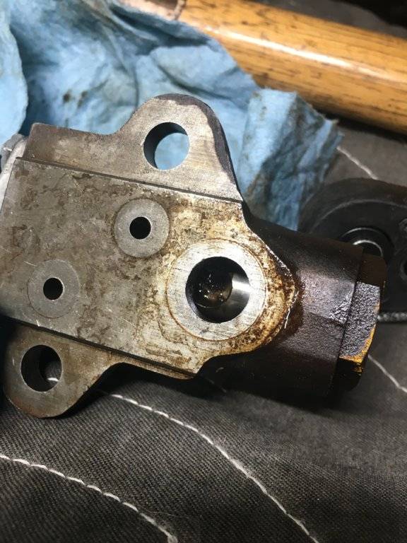

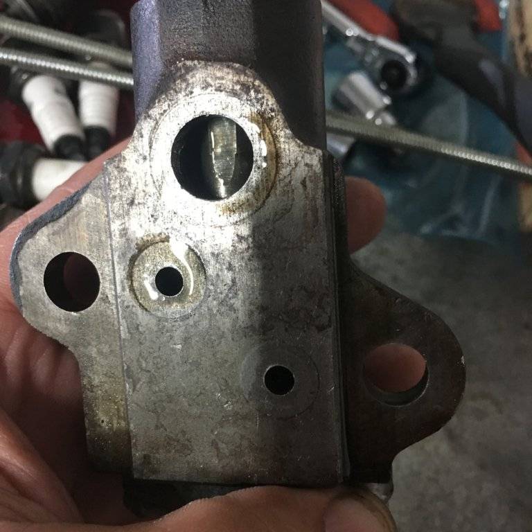

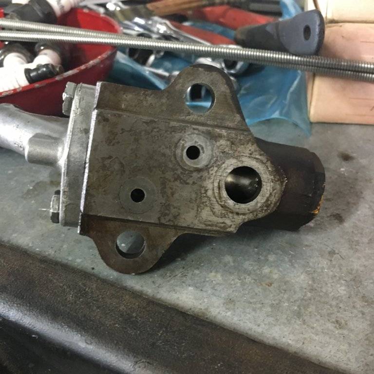

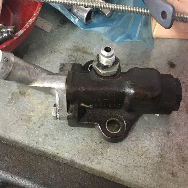

Thanks for the input, definetly useful information. I was able to determine the problem and wanted to update this thread in case anyone else has this issue. The first picture below shows the valve assembly when I went to install it. As this was my first time, I wasn't aware that the valve within the assembly could move and rotate. Apparently, there is a recessed area on the cylindrical valve that accepts the end of the rod which is shown in the 2nd and 3rd pictures. The valve had rotated after I removed it while changing the o-rings, thus preventing the valve assembly from fully seating on the steering box.

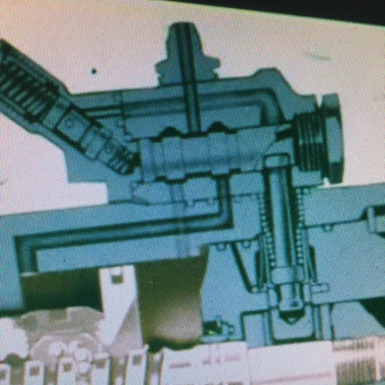

As for the spring, I'm not sure what Davea Lux means by "Not installed correctly". The spring is tapered with a wide end and narrow end. When I pulled the valve assembly off, the wide end was up towards the valve assembly. This unit was driving and working with the spring in that orientation. Should the wide end go down into the steering box? I posted a picture from a youtube video below that appears to show the spring with the narrow end down. In addition, I posted a link to a youtube video about the Chrysler steering systems. If you look at the video time index 10:36 you can make out the spring orientation.
Here is the youtube video:
Also, thanks for the link for the "Mopar on Steriods", tons of good info in there.
