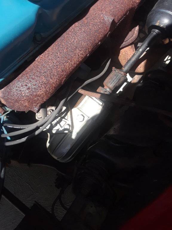

Hey there , I should be able to help, can you tell me if the end of your steering column has a fiber coupling or a metal one please? Also need to know what engine your car has and if it has AC or not too. This will tell me what types of accessory brackets you need for the power steering pump as well as what pulleys to suit. Cheers.
It's will be a 68 440 no ac
Sorry no, no hood here, but @C Body Bob might be able to help regarding that. Also, Can I get a pic of the front of your engine showing your pulleys now? Since the car has no AC you may have a couple in place you wont have to replace.
